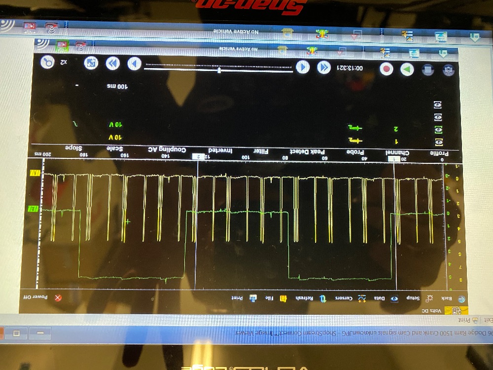

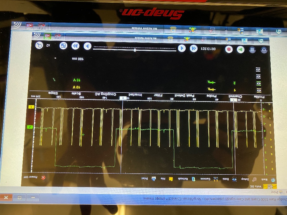

Hello Guys. I’m in need of Waveform and help Cam and crank Correlation on 96 Dodge Ram 1500 3.9lts distributor ignition system. Symptoms are cyl. 4,5,6 are dead as per cylinder drop down test. So three cylinders are not contributing. First we dis relatively compression are good, spark and Ignition are good. Customer have replaced the distributor rotor, cap, wires and plugs. Exhaust is good and no restriction. We checked those wires making sure they are on the right cylinders and they are all good. Injectors are good and we even checked flow test and they are all relatively the same. Now we are down to Input side of it. We have taken the Cam and Crank Signals and we will compare that with the Good Known Waveform. Pls i need ur help with the waveform and with some ideas for diagnostic. The distributor have been adjusted to 0 or near 0 degree according to Procedure and problem continues to exist. Pls need ur help guys. Need more diagnostic ideas. On the trouble shooter they talk about Distributor not in 0 degree at idle and shaft itself has a excessively play but not the case on this one. We checked it and they are all
Good and we turned the distributor 0 degree at idle using Data PIDS on Verus. Pls i need Help. Thanks

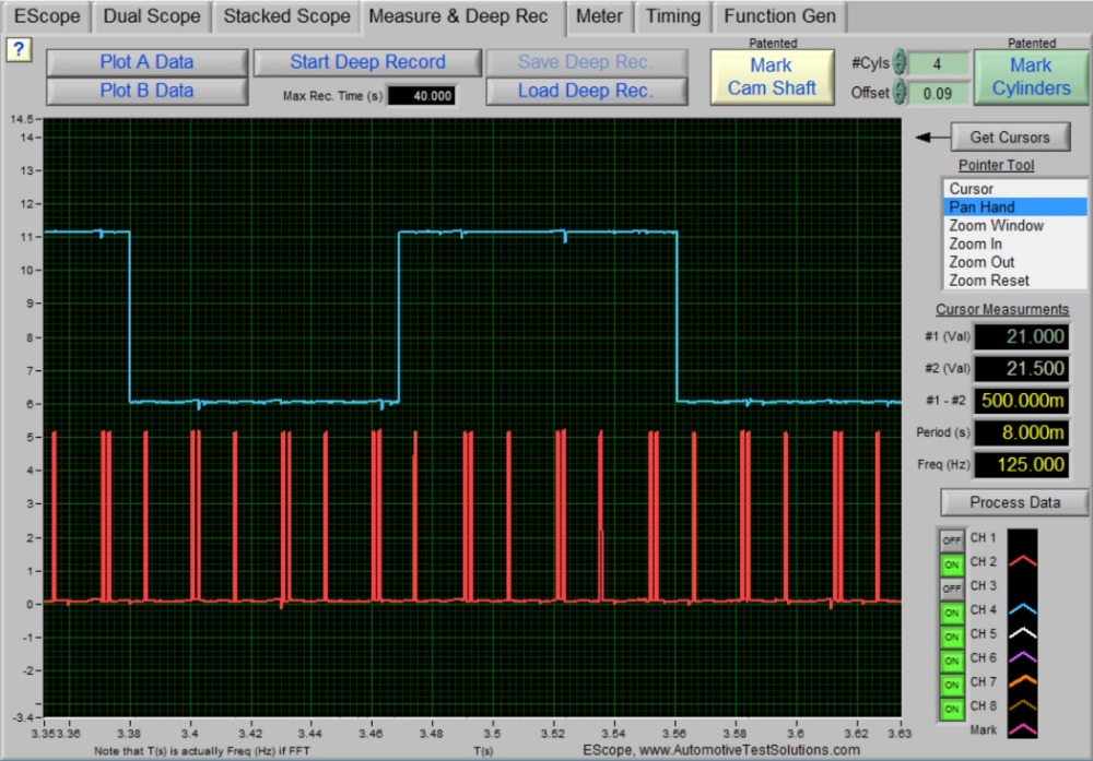

5 years 5 months ago - 5 years 5 months ago #38721 by John Curtis
Replied by John Curtis on topic Dead Misfire
update: here is a known good from diag.net to compare to. Your cam/crank are spot on.

Thanks. My Waveform is dead on. Thanks and I appreciate
