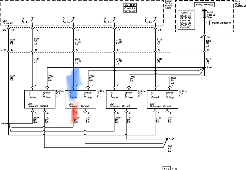

Is it a dead miss or random single cylinder miss?
Scope the control (I’ve highlighted blue)
And scope the low ref (I’ve highlighted red)
Checking to see if the computer driver may be dropping out here.
Post a capture here.
If that checkouts out relative compression is the way to go, but if it’s not a dead miss make sure to do an extended crank time. Compression gauges can miss low compression in some instances. Relative compression will show if you have an intermittent compression issue which is why I’d recommend a long crank time.

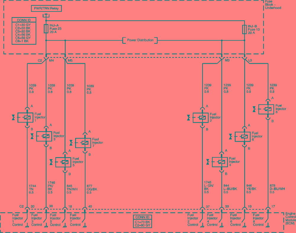

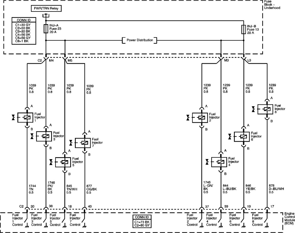

They were verry close to zero. Probably a 5 to 8 % spread. Now the vehicle has the #1,4,7 fuel injectors opening when the key is turned on without attempting to start. The injectors are not stuck open because i switched the harness connector to one of the ones not opening and it opened immediately. Trying to narrow that down now.
- Cheryl
- Posts: 1216
- Thank you received: 215
6 years 5 months ago #38734
by Cheryl
Replied by Cheryl on topic Re:single cylinder misfire
So your filling those cylinders up with fuel?? Are you comfortable using an ohm meter to find a short to ground? Or bad pcm driver?

6 years 5 months ago #38736
by John Curtis
Replied by John Curtis on topic single cylinder misfire
Does the computer think you’re getting an RPM signal when they engine is off for some reason?
Are you sure you don’t have a harness issue. Maybe the injector control wires rubbed through and are finding a path to ground.
Try test light on B+ and backprobe the control wire then wiggle the harness and see if your test light goes out. If you don’t find anything then unplug the ecm and see if connector and see if the test light comes out. It should shut off. If it doesn’t it’s a harness problem. Tap test on ecm to see if it’ll stop providing constant ground to injectors?

6 years 5 months ago #38743
by trsvan
Replied by trsvan on topic single cylinder misfire
I used the test light to positive and probed one of the injector harnesses and the light came on. I then unplugged the ECM and the light went out. I purchased another ECM and programmed it and now the injectors are fine. Engine runs ok but still has the cylinder 5 misfire along with Bank 1 lean code P0171 and a bank 2 rich code P0175. I really dont understand that one. I guess all the fuel that was dumped into the exhaust either clogged up the O2 sensors or catalytic converter. I will look at that tomorrow.
