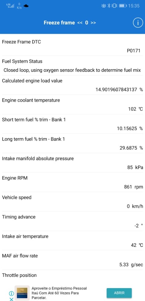

This is when I bought my OBDII dongle so I could take a look at things myself.
I drove the car a few more days with the alert on, since they said it should go away on its own. From what I was researching, it could be a vacuum leak, and I returned the car so they could check it. They said they found one, and corrected it. The car still had the alert.
The next morning, I got again the erratic idle and the car was almost failing when I was able to get it to the shop again, where it was left for a whole week.
Tested fuel pumps, which were said to be operating with the correct pressure.
They drained the gas from my car and found out that there were about 6 liters of water on my gas tank. I freaked out at them because I had ordered them to drain all gas when the injectors went bad.
I got the car back and wasn't charged, saying that all my problems were the bad gas that was still there. Well, the car came with P0171 still.
The idle is very smooth now and the car doesn't have any symptoms of a lean mixture car.
Went for a drive yesterday and it feels very powerful. After flooring it to measure the engine on my OBD2, my garage had a very strong smell of burnt gas.

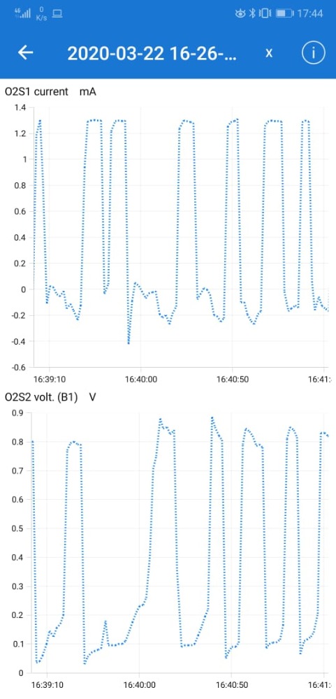

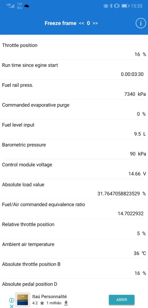

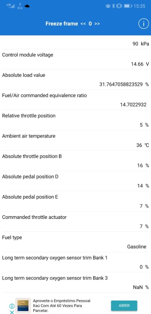

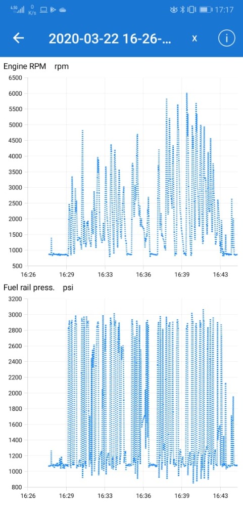

I pardon that I may not have the best tools to do the measuring, but I hope they can help you guys shed some light on my problem. I really don't know what can be wrong and as many will guess, the shop wants to solve this by swapping parts (trial and error).
Me paying, of course.
I'm attaching:
- freeze frame screenshots
- some videos of the car running on idle at the garage with various RPMs.
- Data that I collected when I went out on a drive with the car. I have more data here, if anything else is needed I can provide it.
I'm from Brazil so you will hear me saying things, which are idle, 1500 and 3000rpm. You can hear the engine when I go at 3000. I always started the videos at idle and went upwards.

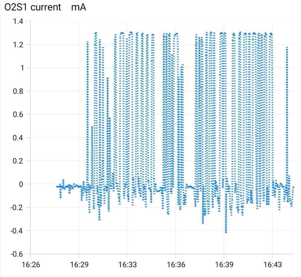

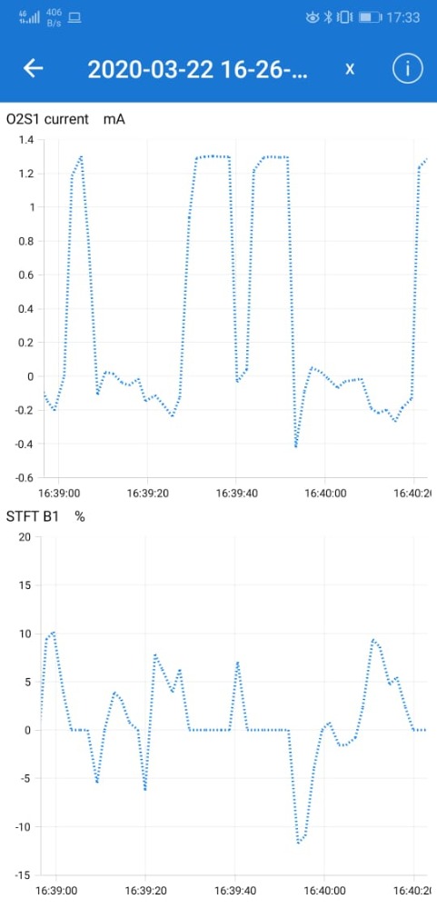

Links for the videos:
Fuel Rail pressure at different RPMs:
drive.google.com/open?id=1xG1o24faEg9Js-foNLP1SVQmWmvWQcFI
MAF and fuel rail press at different RPMs:
drive.google.com/open?id=15OJcE69pfsyOjx2om7b7U0fpCjrztFg1
O2 and wideband sensors at different RPMs:
drive.google.com/open?id=12Q_BUisma_145k3IqHNzzdevpay0Js9N
STFT and LTFT at different RPMs:
drive.google.com/open?id=192t_HkORqfAm1_c55XZ-OF5Igc0eJHbO

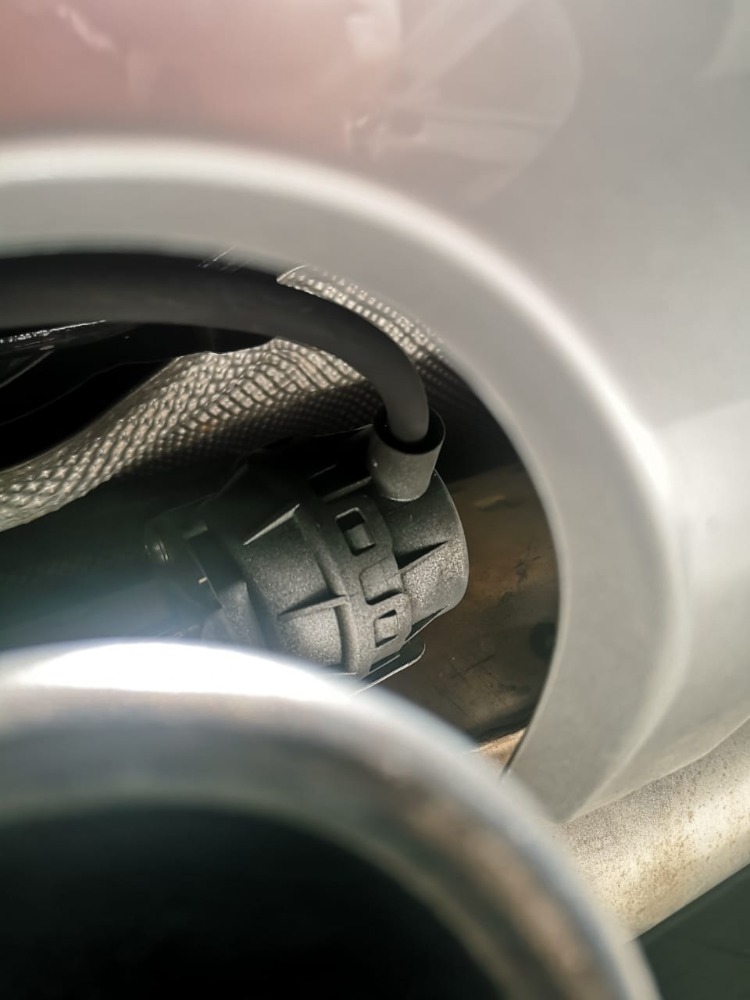

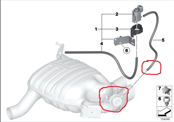

make sure the vacuum hose on the muffler is attached and not disconnected, I have seen that cause this fault before.

Hello Tech25,
Thanks for your answer. It really makes a lot of sense since the exhaust actuator is not working on my car. And, I can smell exhaust on the car interior as well.
I'll investigate when I find a shop after the quarantine madness is over here in my city.
Is it possible to plug this vaccum in the engine compartment so I can find out if this is really the issue?

- tiagoaviz
- Posts: 5
6 years 5 months ago - 6 years 5 months ago #38704
by tiagoaviz
Replied by tiagoaviz on topic P0171 on BMW X1 2013 20i

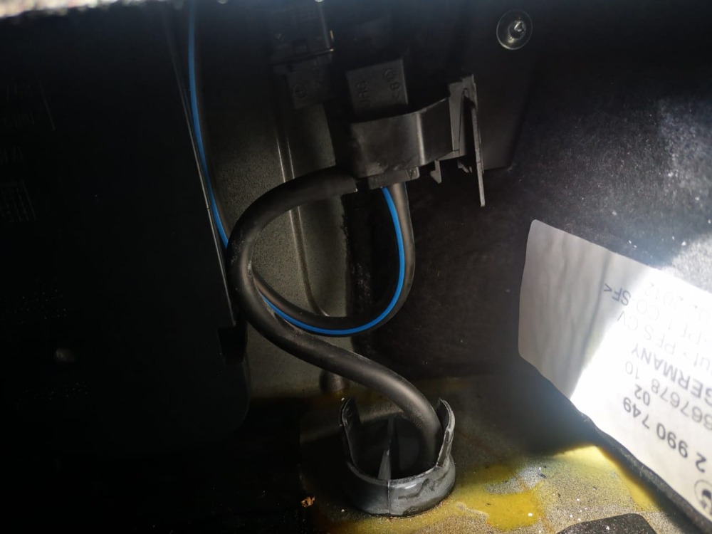

Hi Tech25,
Thanks for the reply.
I was able to find it and it's correctly plugged in.
I've also checked the flap actuator, which is also correctly connected.
I found where the vacuum hose of the exhaust goes in the engine compartment, and I plugged it. It made no difference to LTFT and STFT.
When I removed the engine cover, first I went to disconnect both vacuum hoses that connect to the vacuum reservoir.
It made no noise of vaccuum escaping when I removed the hoses.
I re-scanned the car and found a hidden event, P2BC0 that was registered as well.
Last edit: 6 years 5 months ago by tiagoaviz. Reason: add attachments

Just to let you guys know, in the end it was a plugged cat, molten wideband sensor and a weak vacuum pump.
