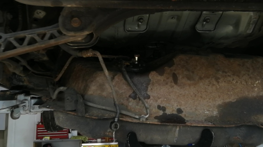

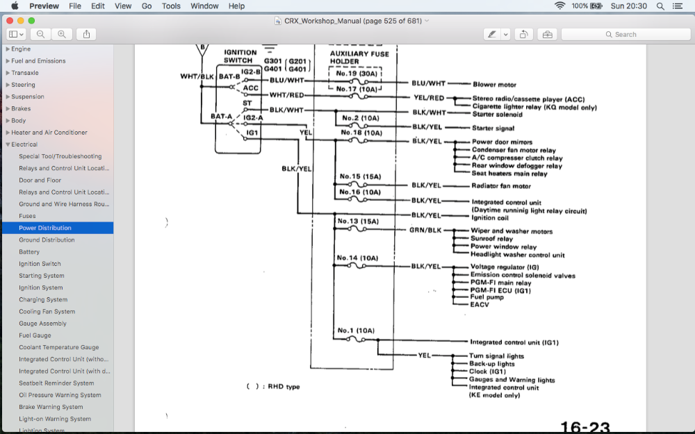

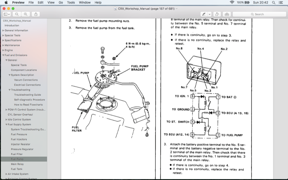

Installed one of these the other day, ended up blowing fuses on the road in dangerous areas, I read at 40 psi it produces approximately 7 amps, IACV, Alternator regulator, and ECU is on the same circuit as the fuel pump, does anyone know what gauge wire is on a Honda CRX fuel pump wiring? its a 10 amp fuse for the whole circuit. The main relay consists of 2 relays in effect, one for the fuel pump, but watched Paul Danners video on the main relay, and says Honda uses a resistor in the main relay to lower voltage for some reason. I was able to do 15 to 20 miles before it blew and and the wires are loose onto of the fuel tank, so can't be a dead short

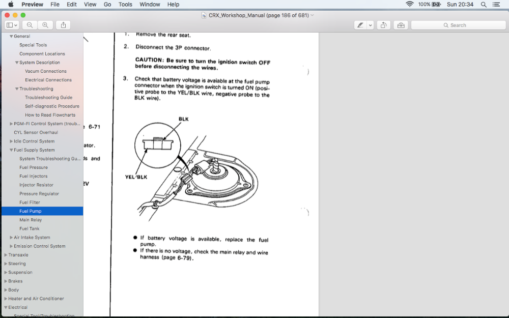

Thanks for the responses, some great information there. Yeah it seemed to be a spike of some sort, happened the first time when giving it more throttle, I attached a few pictures. The power and ground going to the pump is under the seat, but the pump itself is further back, (attached picture of my fuel tank) so theres more wiring. I put a 15a instead of the 10a, and its been fine now, just concerned that I will melt wires or cause a fire. Very thin wire it seems to use, but that's what Paul Danner said about the reason they used the main relay to use thinner gauge wire. I didn't think Id have a problem with it drawing too many amps for the fuse, but then I saw the IACV on there and other items. Cheers Andy I think the ECU wire from the main relay is to command the pump on initial prime? thanks for the other comments saying about the fuse capacity. I might have to wire in a separate relay and fuse, but to do it correctly Id imagine I'll have to drop the tank down again to get to all of the wiring. My friend said I could put a relay in there then I could run off 10amps, but on here it seems to indicate that 15 would be the lowest on its own circuit 50% of 7 amps 10.5a

we fitted a relay and inline fuse to one of the (optional) connections at the fuse box, the power wire had 19 strands, so it can handle 15a I think we worked it out at, there;s a 10amp fuse inline, I worked it out at 10.5 amp with that 50% buffer or whatever the correct term is. See how it goes, but so far so good
