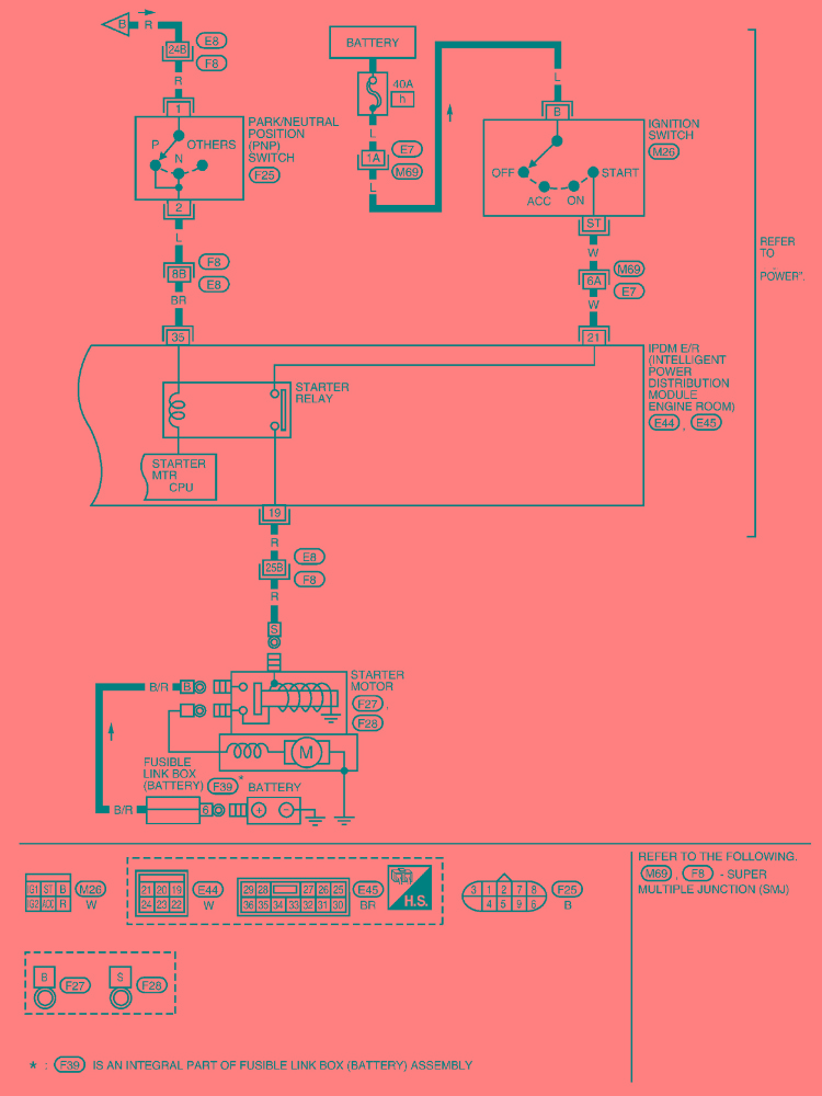

I can jump the load side of the starter relay and the starter cranks when I turn the key, but the engine doesn't fire. I think there is an issue with the ignition signal to the ignition relay? I also confirmed that it isn't the park/neutral switch, (thought it was that because I wasn't getting a signal, continuity, through the switch in what I assumed was the park position). So I replaced it but that didn't fix the issue. Luckily I can return the part. I pulled the ignition switch and checked to make sure that manually engaging that switch while back-probing the output signal wire.
I tested the ignition relay and it has good continuity when 12v signal is given. I have good load side 12v at the ignition relay. I attempted to test the signal to the relay and I am not getting a signal 12v to the relay when the key is turned to start. I will try to jump the load side of the starter and load side of the ignition relay when I get home tonight. That will confirm a signal side issue with the ignition. Any ideas what could cause that issue? I have checked all fuses in the relay box and in the interior fuse box (driver's side). Possible issue inside the PCM?

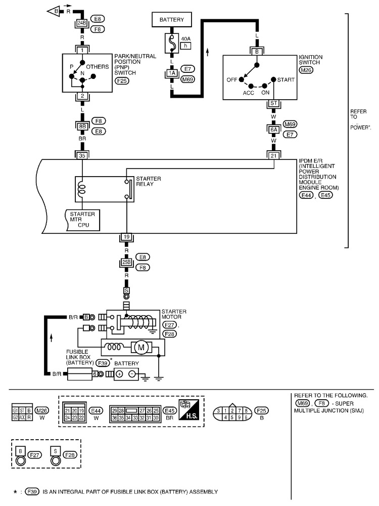

- Turn key, nothing happens, no starter click
Shift to neutral, turn key. Still nothing (trying to rule out park/neutral switch)
Confirm positive starter terminal power (12v)
Confirm starter function, by jumping starter pos to neg with a screw driver (starter cranks, but engine doesn’t start)
Confirm connectivity from relay box to starter solenoid (ruling out bad wiring to starter)
Pulled starter relay and confirmed connectivity across load side when control side energized with 12v, so thinking the relay is good. I also swapped relays to see if that’s the issue as well. Thinking I’ve ruled out the starter relay as the issue.
Confirmed 12v load at starter relay when key in on position
Confirmed 12v control signal at starter relay when key to start position (should rule out ignition switch)
Tested and get no load power to the starter-side of the relay output pin. Ie. despite the control signal getting to the relay and the load getting to the relay, the output of the load side doesn’t get out of the relay box.
Jumped the load side of starter relay with a small wire. Starter fires when key to start position, but the car doesn’t fire and start.
My conclusion was there must be an issue with the relay box itself. I wasn’t going to mess with the board in that box and there is no visible damage to that box/board.

Manual or A/T? Diagram here for a/t

Thanks so much for the wiring diagram.

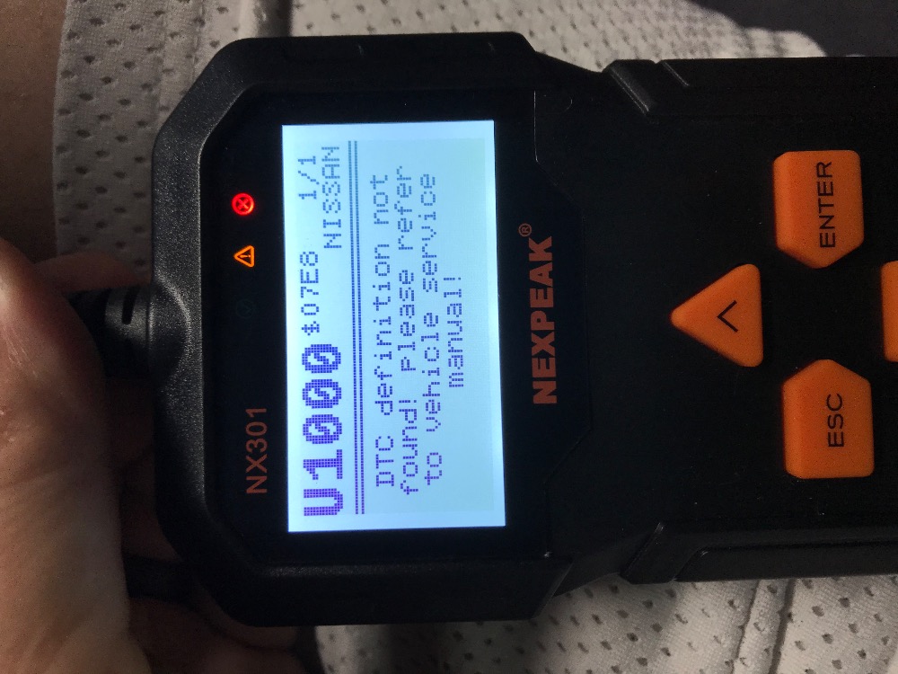

It seems like that’s a problem based on the code U1000.
Indicator shows it’s in Park.
Not sure I have the tool to check the modules. Suggestions?

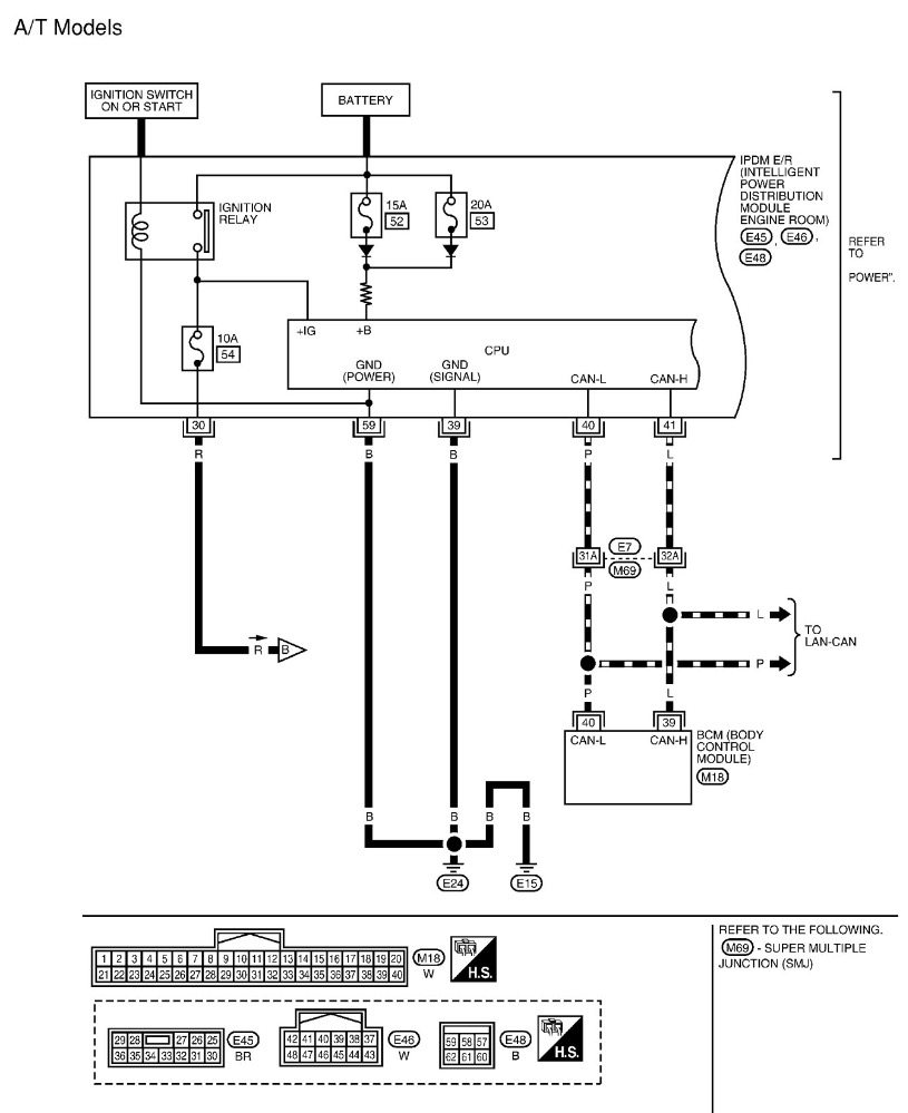

That code means you are missing communication to a module or modules. Not the ECM, but another. If you have a shift indictor, that makes me think thr TCM is probably online, so maybe move toward IPDM or BCM. It may be difficult without a scantool that can communicate with all modules, but you can start by checking powers and grounds on them.
You can also disconnect battery negative and check for 60 ohms at the dlc between the can high and can low pins.

I was able to get a mechanic with his scan tool to come by my house. It gave him an error with the key. Apparently, the chip in the key went bad. I was able to find a spare key and it runs fine.
