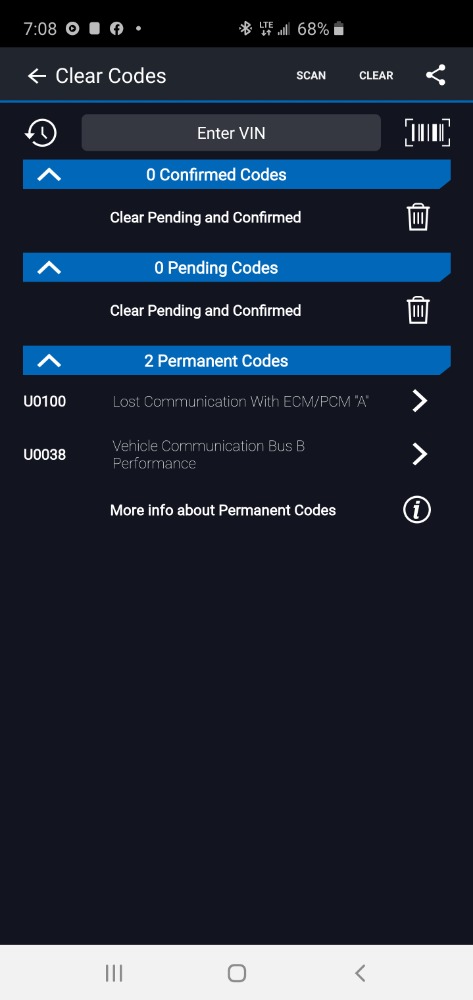

Hello friends I tried reading the codes for my 2019 honda civic EX and got two new codes.
U0100 Lost Communication With ECM/PCM A.
U0038 Vehicle Communication Bus B Performance.
The vehicle is a push to start and wont start at all the engine is a L15BA and the intake are not attached to the engine yet if that's a possible cause.
Any info on how I might be able to fix this issue like where to start and so on is greatly appreciated.

You have the intake manifold off?? Take test light hooked to battery plus probe pins 4 and 5 at the data link connector. Should light. Sounds like the pcm is miss it’s grounds

No, I'm sorry I meant to say I have the airbox off also the turbo I looked at all of the grounds and fuses and they all look good what should I do next again thank you to everyone helping out.
