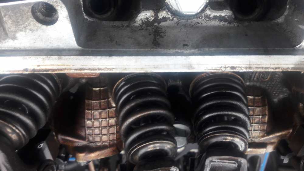

Got around to reinstalling the cylinder heads and torquing the rocker arm bolts. I noticed on the front cylinder two of the springs seem more compressed than others. Could this potentially be due to weak Springs or is there something else that I'm missing.? On rear cylinder head all Springs are compressed equally after torquing. .gonna put the rest on hold for now until i can gwt some peace of mind

Might can't tell but the left spring is more compressed than the right one. it's only really like that for the front cylinder head. We are cylinder head offsprings look normal. It's one of 3.1 General Motors engine

If the lobe on the camshaft is on the high spot it will be trying to open that valve causing the valve spring to compress. Rotate the engine and watch that valve spring to see if it returns to normal height with the valve closed.
See what you mean. Looks kinda weird :huh:
Like Rob said, how does it look when you turn the engine over and both valves are closed...
9 years 9 months ago - 9 years 9 months ago #5049 by Tyler
Replied by Tyler on topic Valve spring compression after torquing?
Dylan wrote: See what you mean. Looks kinda weird :huh:
Agree here. Before going back together, I'd suggest hand cranking this thing over a few times, and see if you can get both valves to close fully.
No offense meant here, but you're sure you got the pushrods back in the right places? That'd definitely cause one valve to hang open. You'd also notice this while hand turning the engine, as it'll cause piston contact.

The valves are moving when hand cranking. I'm not too sure if the spring is supposed to close all the way? It was definitely closing though. When turning I can hear a noise which sounds like a spring is just snapping back to its default position . Should be normal or no?

For what its worth i redid the valve seals. Didnt notice any bent valves. When slowly turned over the snapping is non existent. Only when turning over quickly and with more force as shown in vid
Intake and exhaust rods are properly placed. Rocker arm bolts properly torqued.

You may have already said sorry, but does it all look normal or all a bit odd when the rockers are off?

Looks pretty normal to me? Nothing looks out of ordinary. The other cylinder head does the exact same thing although i took the part the valve train off that one for demo purpose

Back at it in the morning. Anyone else care to chime in? Just checked my torque specs which according to service manual says 11 foot pounds plus 30 degree angle. Pushrod and rocker arm replacement it states 22 foot pounds but I suppose this does not apply to me since the components are not being replaced.. otherwise I'll just torque to Specs put it all back together and see what happens when I run it. The sound seems to be coming from one of the cam lobes when it releases the lifter
