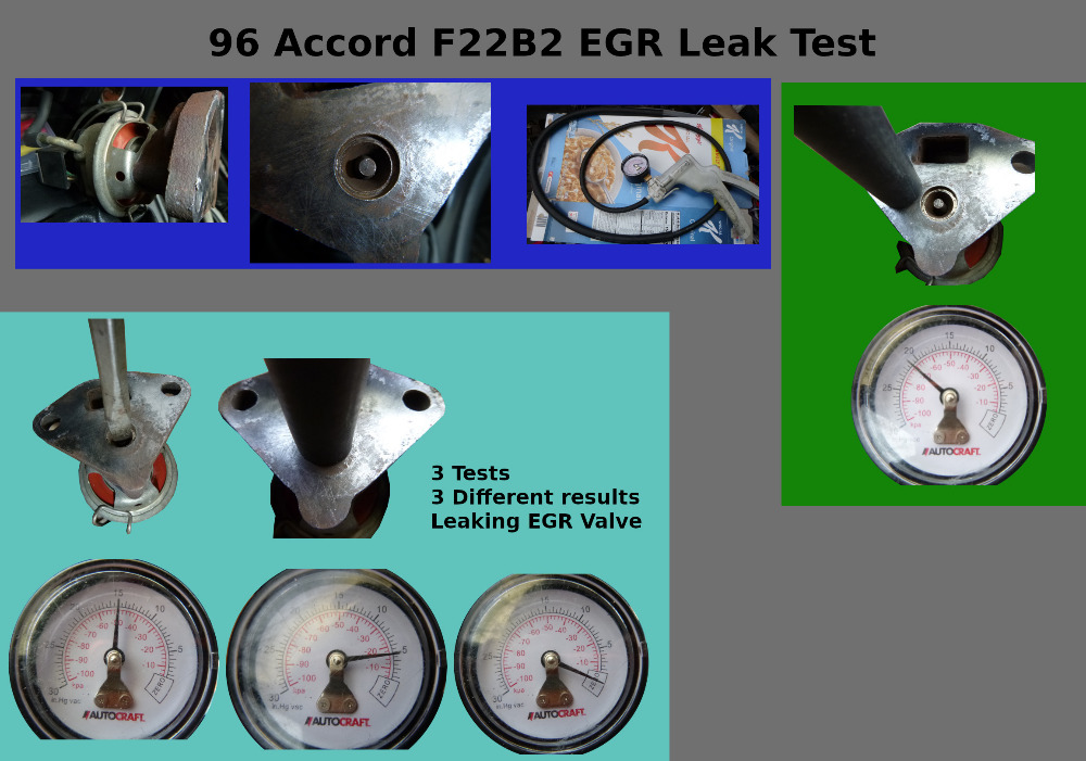

Ok, so I just finished the EGR valve leak test. 100% confirmed! It definitely leaks... but does so intermittently
Hopefully I can maybe clean the valve seat and get good results. If not I'll have to replace it.
You maybe wondering ( because I have said a few times )... how could the car have ran perfectly before the rebuild if this EGR valve was leaking the whole time?
I'm glad that you asked vicariously through me!
Let me show you the answer:
I cleaned every part of the intake completely spotless when I re-assembled the engine. That caused the leaky EGR valve to actually matter.

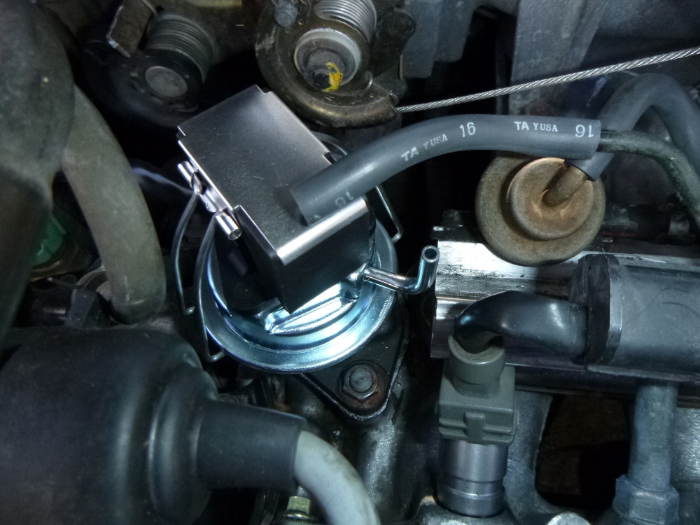

So I replaced it:
After that the car idled fine, but still has other issues. I still hear and feel occasional misfires, fuel trims still seem way off and possible spark timing, but I'm not 100% sure.
In the middle of my test the car suddenly died after being revved up a bit, then going back down to idle. I suspected the EGR valve again.
so I jumped out and pulled the vacuum hose on the EGR just to check.
Sure enough!
As soon as I pulled the hose I heard it suck in a bunch of air.
For some reason either:
  1. the ECU decided to open the EGR valve and keep it open
  2. there was a malfunction of the EGR electrical circuit
  3. The vacuum solenoid leaked vacuum into the EGR valve
  4. The ECU correctly opened the EGR valve but failed to shut it
I'll check it out more when it's a lot less freezing cold outside.

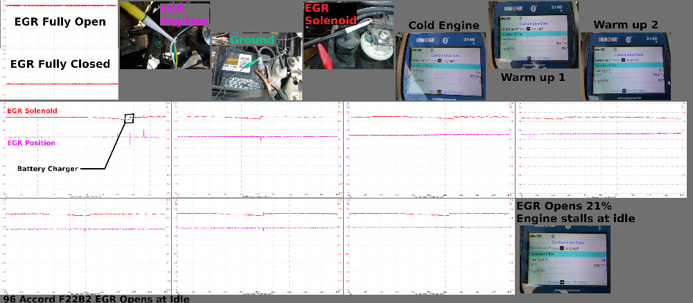

Sorry for the Long wait! I'm back working on the 96 in the middle of the COVID19 lockdown
Today I tested the EGR valve in detail and found that it is indeed being opened when it should not be.
The ECU is not opening it ( no signal sent ). Something must be going on with one of the vacuum components.
Based on the timing of when it opens, it makes me wonder if the fast idle thermo valve is somehow involved.
Here are the findings:
The image above is completely unreadable using the javascript viewer, so I'll just hit the highlights:
Cold engine: 77DegF
Warm up 1: 149DegF 1149 RPM
Warm up 2: 176DegF 698 RPM
Warm up 3: 176DegF 0 RPM -- EGR valve opens 21% engine dies at idle.
Min EGR position voltage 1.2v
Max EGR position voltage 4.5v
EGR voltage at stall 2.0v -- Rise time 80msec
No EGR solenoid signal is ever sent
EGR vacuum remains even after the engine dies.
It still idles rough hesitates and misfires even before the EGR opens.
At this point I'm going to bypass the EGR for diagnostic purposes. I'll fix all of the underlying issues, then I'll repair the EGR last.

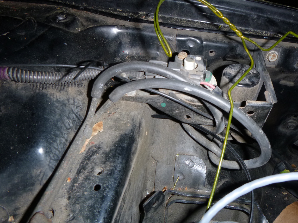

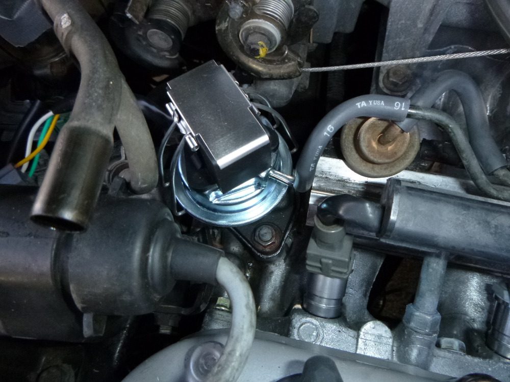

Well, I found the EGR valve problem
These two vacuum hoses that both go to the EGR solenoid got switched.
At first it would seem like that wouldn't even matter, except that the EGR controls have 2 parts:
A. The vacuum reducer / regulator
B. The EGR solenoid
The supply vacuum is supposed to go through the vacuum reducer first, then the reduced level of vacuum goes through the ERG solenoid, which passes that vacuum on to the EGR valve when the ECU activates the solenoid.
Since the hose accidentally got reversed, supply vacuum was first going through the solenoid, then it was going through the vacuum reducer / regulator backward. I guess the vacuum must have been high enough when the thermo valve shut ( at 176DegF ) to either bypass or pull the EGR solenoid shut. Maybe the vacuum reducer / regulator also acts as a check valve is you use it backward?
Anyway, This is how those two vacuum lines are supposed to be. They were reversed before:
Vacuum lines 16 and 24
Now I'm down to an engine that does run and idle but runs rough.

For those who are wondering, the coat hanger is holding my DIY cam optical sensor.

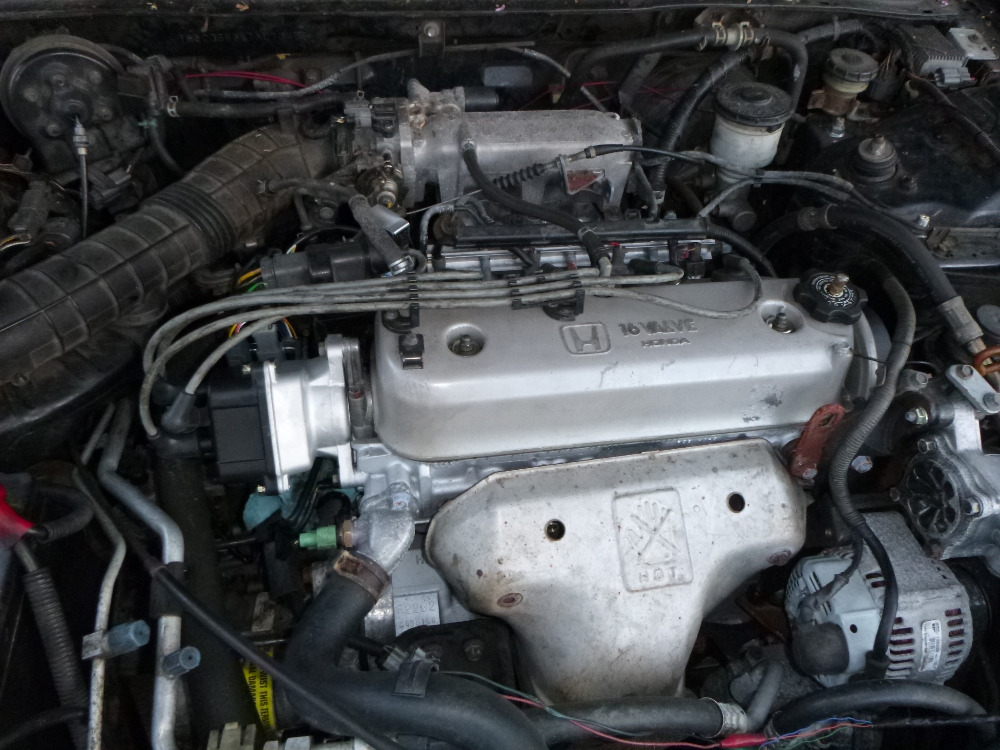

Thanks to COVID19 it has been about a year since I could work on this car, but now I'm getting back into it.
A lot of progress has been made and there were several "interesting" situations that made diagnosing this MUCH harder than it needed to be.
They were:
  1. The Tacometer was lying! It was telling me that it was idling at 1250rpm when in fact it was idling at 750rpm ( exactly like it should )
  2. The EGR vacuum lines got switched in a way that caused the EGR valve to slowly open as the engine warmed up. just about the time the engine would warm up to 190F or so, the EGR would valve would open 20% and stall the engine. If I kept it alive by using throttle the fuel trims were ALL over the place!
  3. It had a misfire on all cylinders. After checking and investigating all of the sensor inputs ( which seems normal and made sense ) I replaced the distro. That made a BIG difference!
So now I'm to the point where it starts and runs fine. The fuel trims are at 0.00% at idle. Sometimes they go up or down a bit ( as much as 8% ) as I play with the revs and different throttle positions. But it always comes back to 0.00% at idle.
Almost all of the time it idles perfect, but sometimes if I punch the throttle and drop it, it will idle a bit low at 500rpm, then come back up to 750rpm several seconds later.
I also notice that the engine occasionally stumbles a tiny bit. I'm not even sure that I would call it a misfire. Occasionally the sound of the engine changes slightly. With a timing light I can see the ignition timing suddenly advance somewhere between 3deg and 5deg for a fraction of a second, then it goes back to normal when this happens

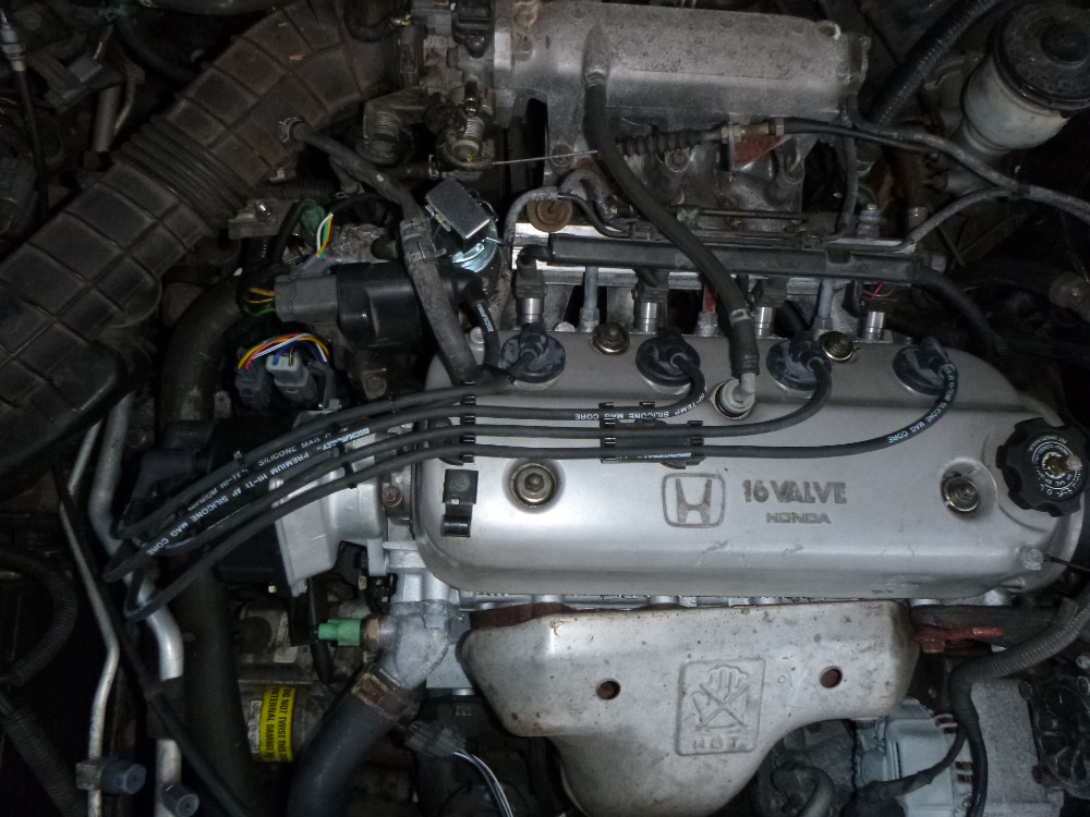

The biggest issue I have right now is that the engine vibrates a lot at idle. No bad noises. It runs pretty well. It just vibrates a LOT. Did I maybe somehow mess up the timing of the balance shafts? I hope not. I put a large amount of effort and study into getting them right.

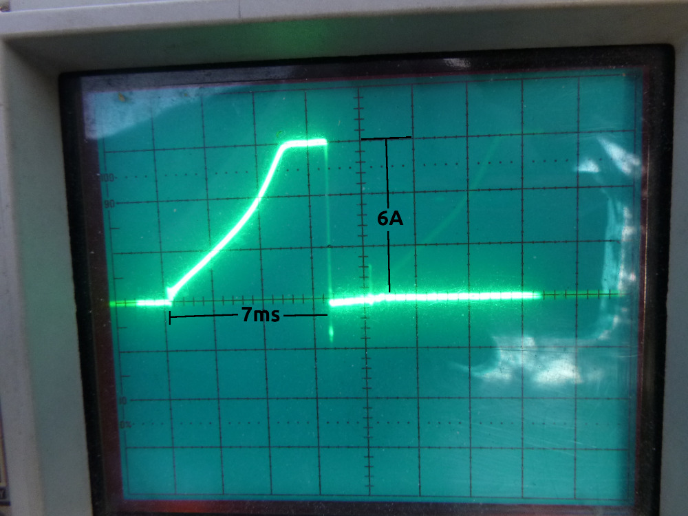

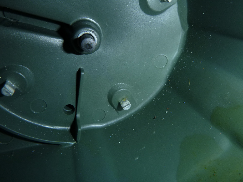

Here is the Primary charge ramp BEFORE I replaced the distro. ( I'll measure it again soon with the new distro to check fro differences )
Just replacing the distro was enough to solve the misfire
but after that I replaced the plug wires too.

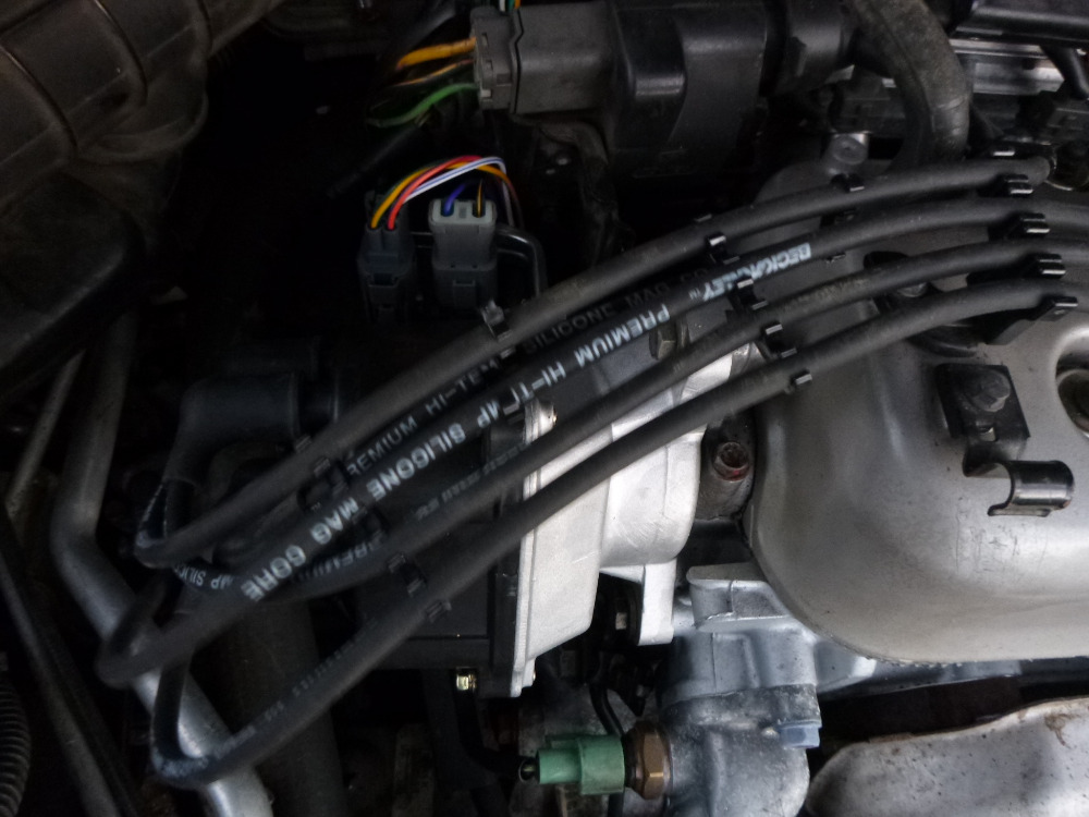

This pic shows the new spark plug wires vibrating ( to give you an idea of how much the engine vibrates ). I'd say the spark wire move +,- 1mm just from the vibration at idle

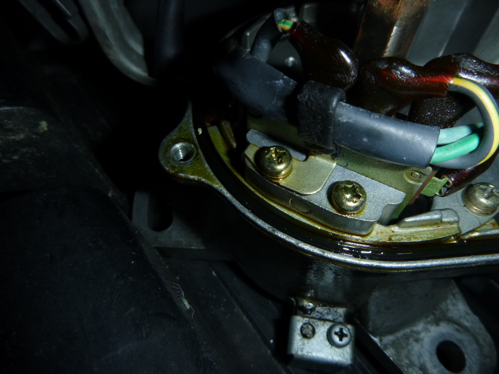

The rest of the pics are a quick autopsy on the old distro. I'm not 100% sure why the cap terminals were so corroded, but I do know that it was leaking oil internally. The center shaft had surface rust on it and the wires were so crispy that I couldn't even get it fully apart with risking snapping the wires off.

I've checked the primary ignition ramp ( posted about that ). It's right on the money and I don't see any dropouts
