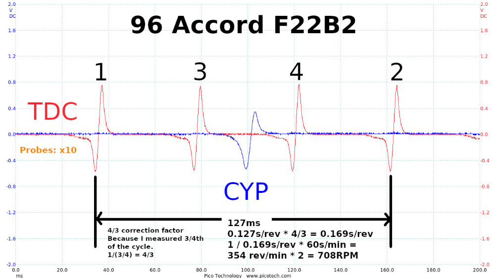

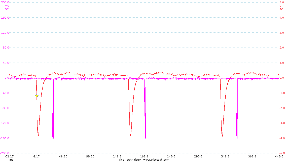

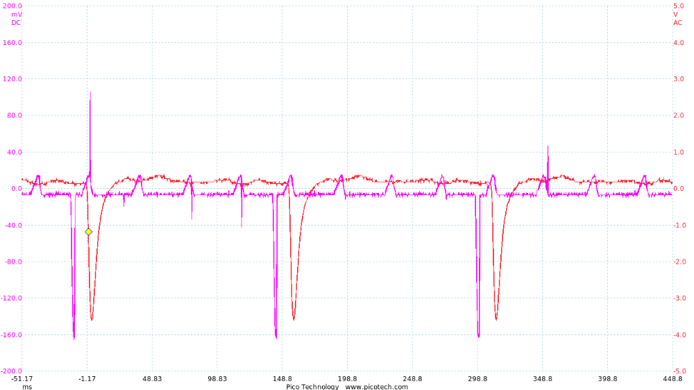

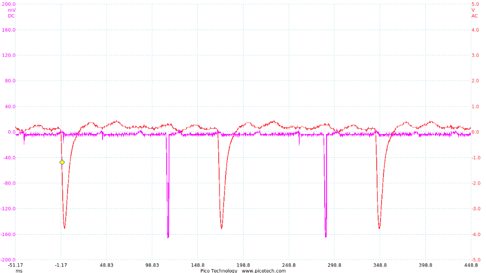

I got a 2 channel picoscope and created an optical sensor to read the cam rotation in real time so that I could have at least 1 sensor that I could trust given all of the unknowns. I'm hoping someone can help me figure out what is wrong with this car. Feel free to request test data, video... whatever you want to see. I'm currently stumped. The secondary spark signals are completely insane on all cylinders. I have no idea why.
It looks like the forum will only let me post 8 files, so I choose what I think are the most important ones. I have a lot more data + pictures. Maybe I'll be able to post more in future replies?
As you can see in these wave forms, the secondary ignition is ALL over the place on all cylinders
Cylinder 1 vs cam optical sensor ( the signal bottoms out at Cylinder #1 TDC compression stroke )

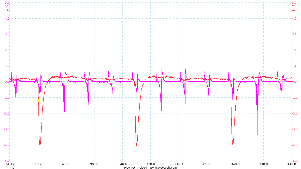

Cylinder 2 vs cam optical sensor ( the signal bottoms out at Cylinder #1 TDC compression stroke )

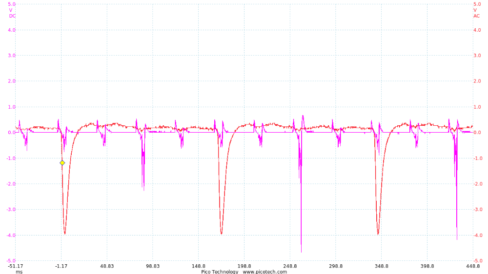

Cylinder 4 vs cam optical sensor ( the signal bottoms out at Cylinder #1 TDC compression stroke )

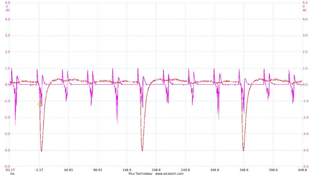

The purpose of these injector current rams was mainly to show their timing. If you want a close up of the current ramp, I can provide that too.
Note: The injector current was measured using a DC amp clamp on the 1mv/10mA setting
#1 Injector Current vs cam optical sensor ( the signal bottoms out at Cylinder #1 TDC compression stroke )

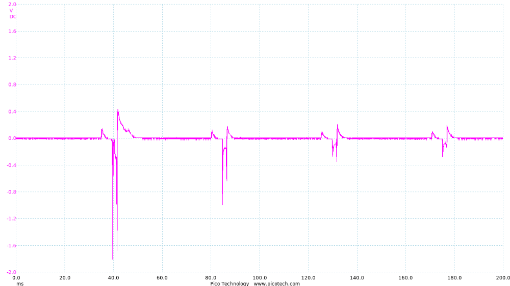

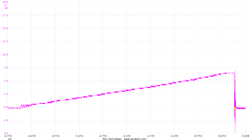

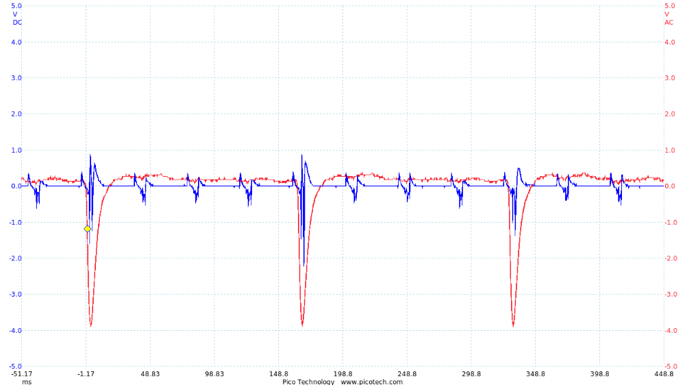

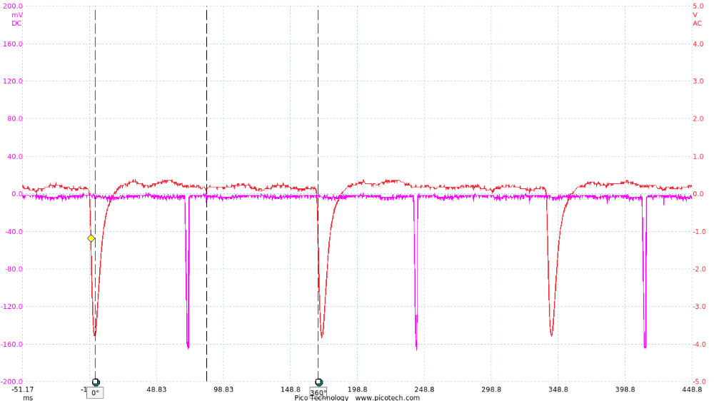

For those that don't have the picoscope app, I'll post the same wave forms here in png form.
Cylinder 1 Spark(Blue) vs Cam optical(Red)
Cylinder 2 Spark(Purple) vs Cam optical(Red)
Cylinder 3 Spark(Purple) vs Cam optical(Red)
Cylinder 4 Spark(Purple) vs Cam optical(Red)
Note the injector current was measured using a DC amp clamp on the 1mv/10mA setting
Injector 1 Current(Purple) vs Cam optical(Red)
Injector 2 Current(Purple) vs Cam optical(Red)
Injector 3 Current(Purple) vs Cam optical(Red)
Injector 4 Current(Purple) vs Cam optical(Red)
Note: the interference on this one is caused by the HV coil. Cylinder 4 is right next to it.
Last edit: 5 years 7 months ago by hakachukai. Reason: Adding detail

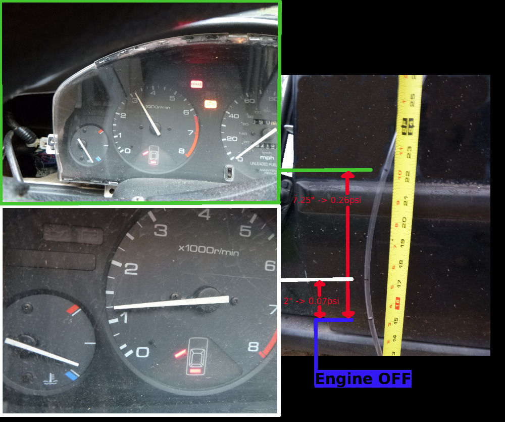

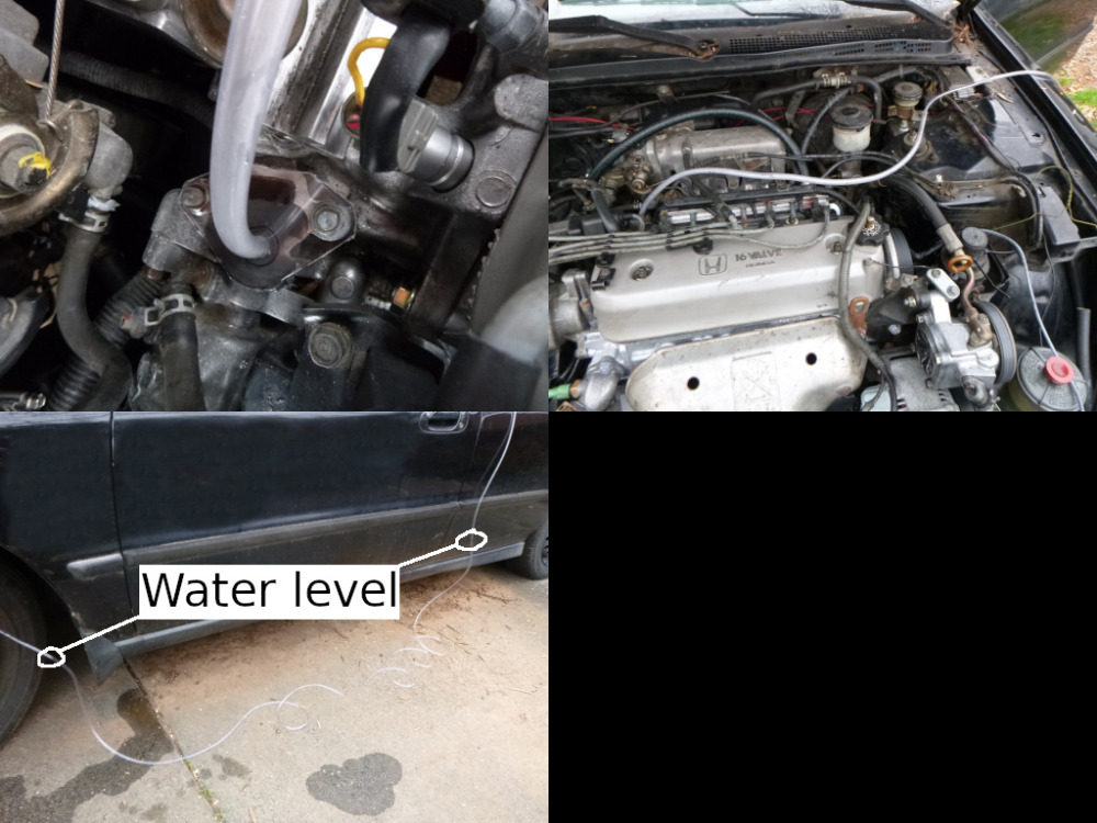

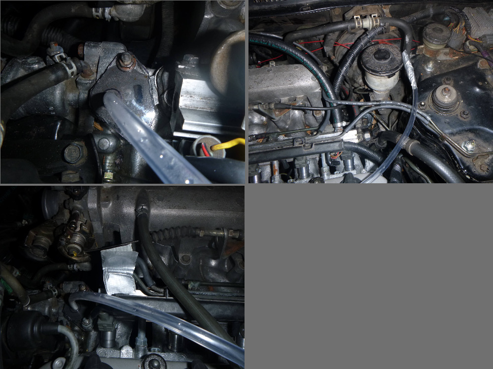

yeah, I started thinking about that a day or so ago. I went outside to remove the EGR valve to check the exhaust back pressure, but it was a no go because it was raining.
Right now I'm basically just waiting for the rain to stop. It has been either pouring rain for freezing cold outside where I live for MONTHS! I'm talking like 3 straight months of rain! I'm no stranger to working in terrible conditions... but the expensive diagnostic equipment can't take it.
So when the weather allows I'll do some more diagnostics and check the exhaust back pressure at the EGR valve. Sadly I don't have much hope of finding a clogged exhaust because it currently shows none of the symptoms.
Intake vacuum is not low. Comparing my MAP sensor readings to my 99 civic both during idle are identical. The engine does not lack power at higher rpms under load. In fact it runs better in that condition.
yeah... I'm stumped. this is the first time I've ever seen anything like this.

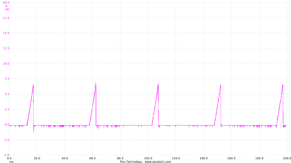

The primary current ramp looks normal and tops out at 6.5 amps

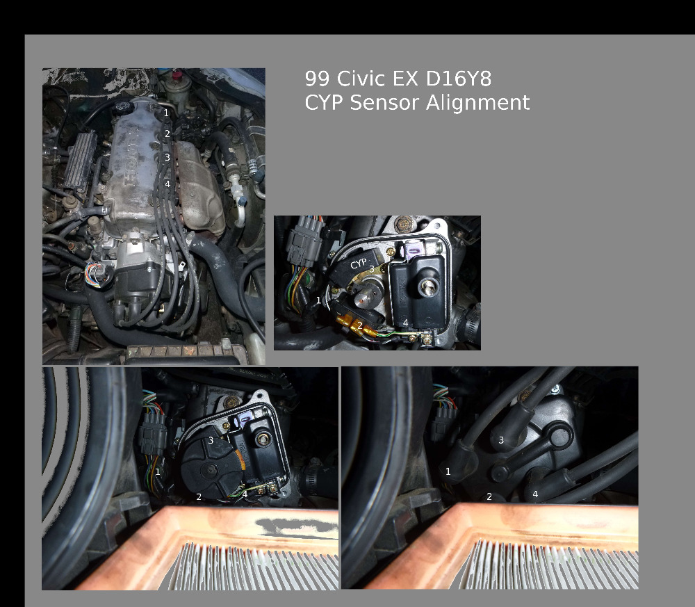

5 years 7 months ago #37247 by Desmond6004
hakachukai wrote: 2. Using a spark timing light shows correct timing most of the time, but sometimes just goes wild ( about 1 out of 5 times or so ).
Is the distributor mounted correctly? If the rotor is between outputs when it fires it could be jumping to the next/previous cylinder
now and then.
  • hakachukai
  • hakachukai's Avatar Topic Author
5 years 7 months ago #37250 by hakachukai
Interesting idea. I will definitely go look into that!
As far as I know the distributor is mounted correctly. My is not adjustable like it is on the civics. It only bolts on in one position. The coupler on the shaft is also offset, so it's not possible to install it backward.
That said... I'll go check it out in detail, take some pics and report what I find.

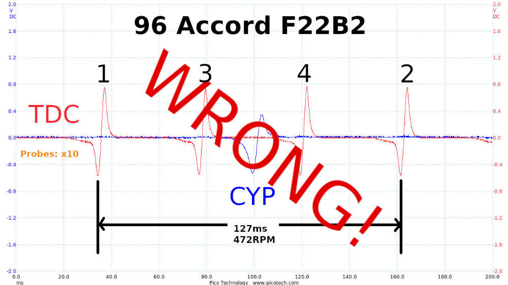

5 years 7 months ago - 5 years 7 months ago #37261 by Chad
hakachukai wrote: As you can see in these wave forms, the secondary ignition is ALL over the place on all cylinders
What kind of secondary probe are you using. It looks like you need to increase your sample rate.
I used a math channel to inverted your secondary wave. I think your sample rate is way to low.

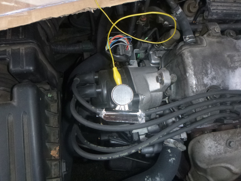

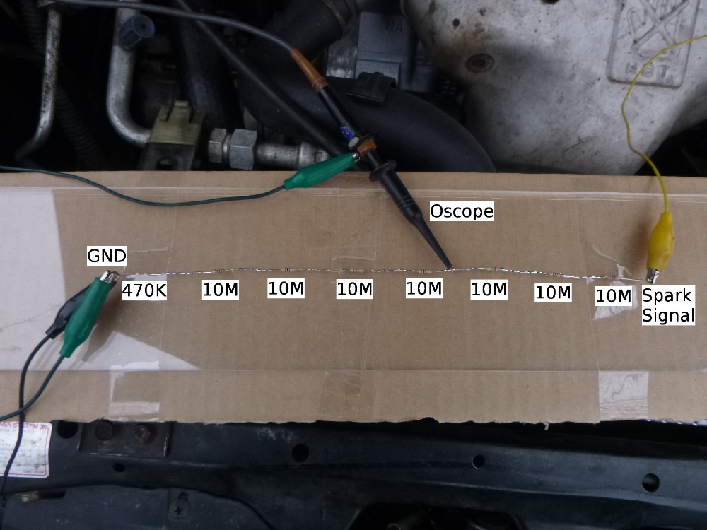

5 years 7 months ago - 5 years 7 months ago #37397 by hakachukai

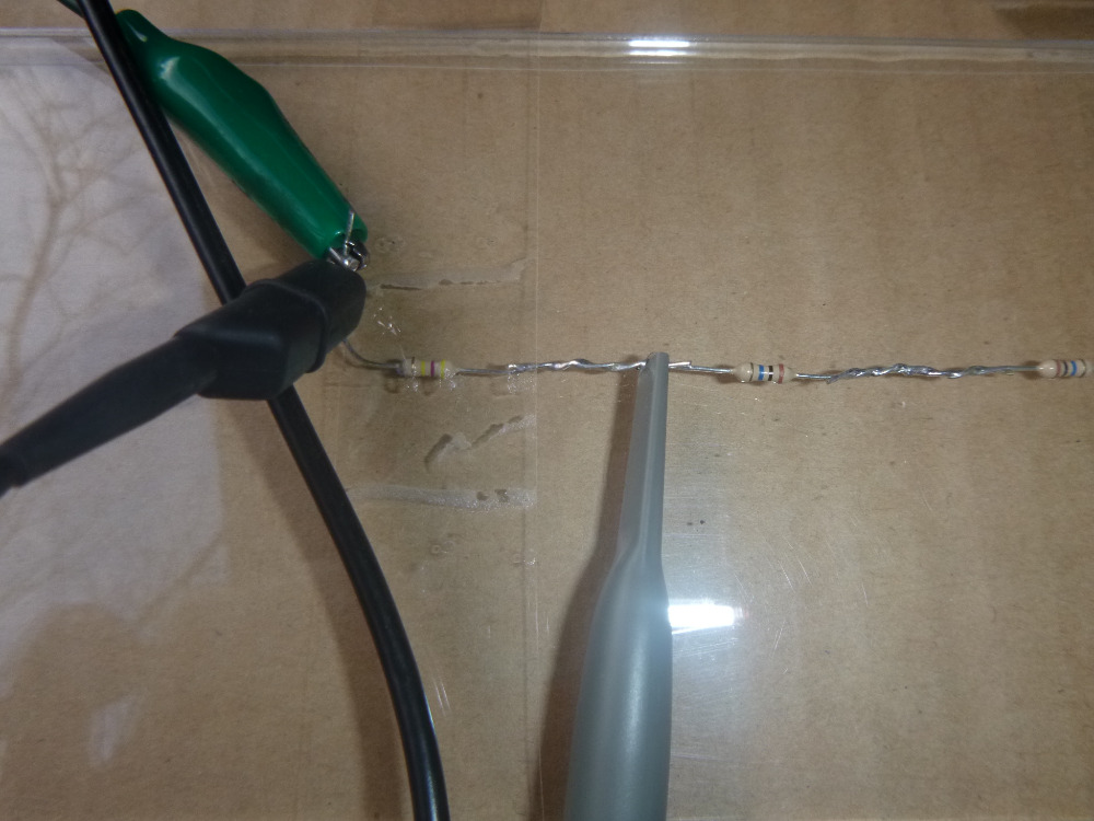

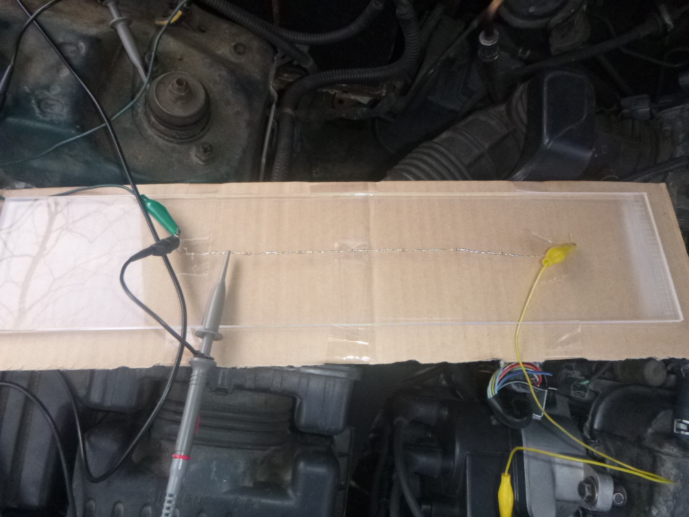

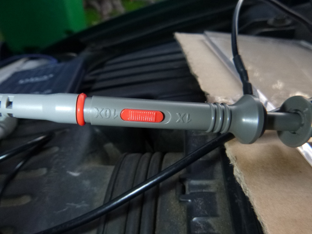

The probe that I'm using is a DIY setup, but I don't have any reason to believe that it doesn't work correctly. I tested it today on my 99 civic which runs fine. That car gets driven every day.
My Secondary probe is basically an insulated steel spring clip that does capacitive coupling to the spark plug wires.
I made a voltage divider / attenuator out of high value resistors. The total resistance is about 72M ohms.
The signal sent to the O-scope is reduced by a factor of about 140.
So the Oscope sees the original voltage picked up by the steel clip/140
Here are some pictures of the DIY probe. After that I'll post known good test results from my 99 civic.
Ignore that Oscope probe. That is not where the scope gets connected
The steel capacative clip. It has a few layers of packing tape on it for extra insulation
The voltage divider with Oscope connection point. That's a voltage reduction of 140:1
The Oscope probe is set to 10:1 attenuation

Known good results from my 99 Civic daily driver:
Take at Idle, mostly warmed up in 70Deg air temp
Primary Current Ramps

For those that don't have the Picoscope app, here is some of the same known good data from the 99 civic daily driver in png format:
Primary current ramps
Primary current ramps close up

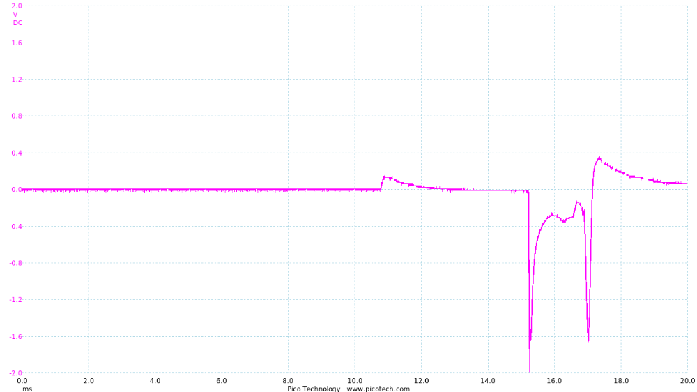

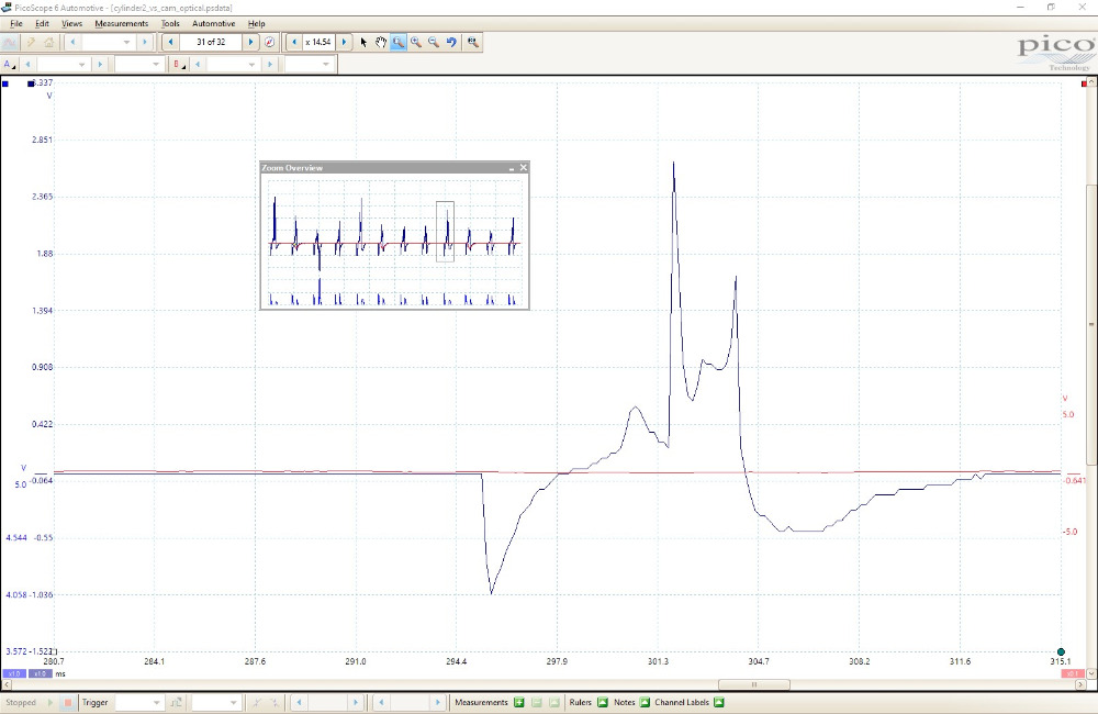

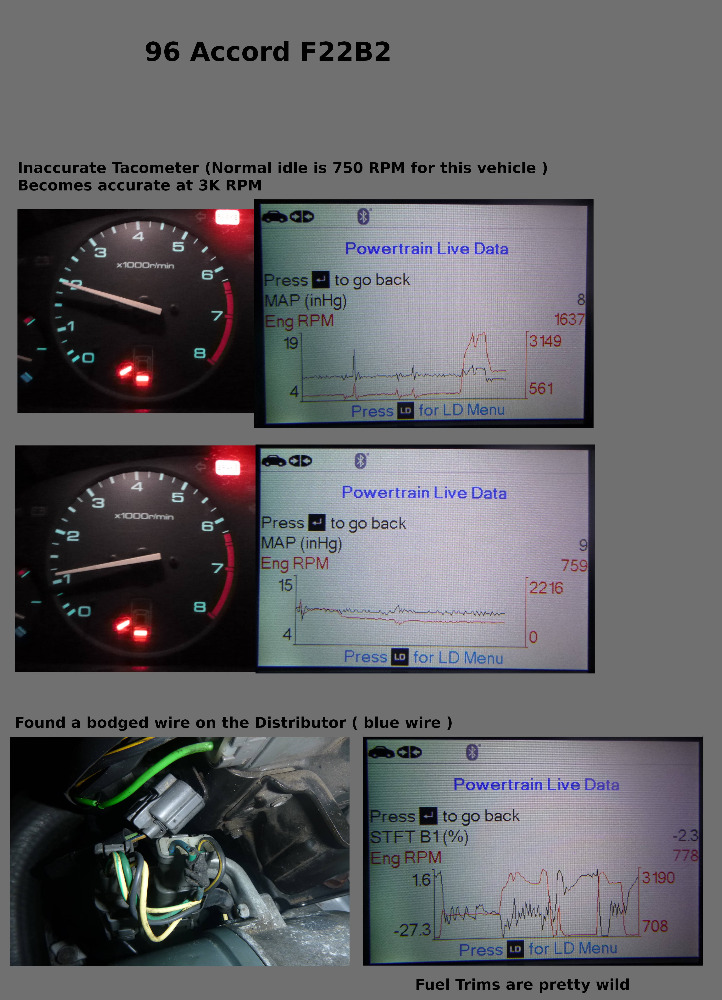

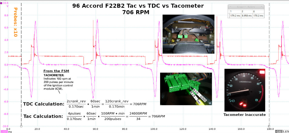

5 years 7 months ago - 5 years 7 months ago #37403 by hakachukai
Using the exact same setup ( everything was the same, even the software settings ) on my 96 Accord gave this result.
This is at idle doing some snap throttle tests:
File Attachment:
File Name: 96_cylinde...e.psdata
File Size:82 KB
As you can see in the data, the secondary wave forms have a large variety in them.
Some are rich, with low spark initiation points and have a burn line that quickly dips down.
Some are super lean, ending with a voltage that is so high that when the spark terminates it sends a huge reverse voltage spike back into the coil.
I'm not sure what is causing this... but it does seem to go along with fuel trims being all over the place.
But which one is the chicken and which one is the egg?
Are the unstable fuel trims causing the erratic misfires?
Or are the erratic misfires sending unburned fuel to the O2 sensor, causing unstable fuel trims?
I did try unplugging the primary O2 sensor and running it that way. It made no difference. That was before I owned my Picoscope, so I haven't measured it like that yet.

ok, the weather finally allowed me to do an exhaust back pressure test today. The pressure was too low for my gauges to really be trust worthy, so I went with the slack line manometer approach.
Here is the basic set up. I removed the ERG valve, cut a piece of poly carbonate and sealed it all in place with RTV. As you can see the EGR nuts hold in place. It doesn't leak. I checked multiple times.
The Test results at 3k and 1.2k RPM's. As you can see from the result there is almost zero exhaust back pressure.
This removes exhaust back pressure from the list of possibilities.
I'm not really sure what to check next because I have checked everything imaginable so many times.
Something is wrong somewhere... I'll find it eventually.

How did it run with that contraption on the EGR port? The only time one of those old school Accords gave me the run around, it ended up having a sticking EGR valve. I've seen it a couple of times now on that vintage.
  • hakachukai
5 years 6 months ago #37576 by hakachukai
I didn't think to check. I shut it down before full warm up because I didn't want to melt the poly carbonate. I'll test it again later today and see how it runs with the EGR blocked off.

5 years 6 months ago - 5 years 6 months ago #37578 by hakachukai
Does anyone happen to know where to view a known good CYP signal?
The actual signal seems fine, but I'm wondering about the timing. With my current set up, the CYP signal is triggering between cylinder 3 and 4.
The firing order of this engine ( as far as I can tell ) is: 1 - 3 - 4 - 2
Cylinder 1 is on the driver side of the car ( same as the crank pulley )
Cylinder 4 is the passenger side of the car ( same as the flywheel/clutch )
According the PDF manual that I have, its purpose it to set fuel injection timing by keeping track of cylinder 1. It's not adjustable, so if it's wrong, that would mean that my distributor somehow got 180 deg out of phase. If I flipped the shaft on the distributor ( which would take a good bit of work BTW ) then the CYP signal would trigger between cylinder 1 and 3 ( but I'd also have to flip the rotor button 180 deg... if that's even possible ).
The distributor is not adjustable on this engine. It has regular round bolt holes. It only bolts on in 1 position.
I'm also of course wondering what good fuel injector timing looks like so that I can check that.
EDIT:
So I went and checked out my 99 civic EX's CYP sensor. It lines up exactly like it does on my 96 Accord. Right between cylinder 3 and 4 ( as you can see from the white numbers ).
I have verified that the plug wires are connected in the right order on the 96. The CYP sensor alignment matches my 99 civic exactly. My distributor on the 96 is not adjustable. I think this rules out all issues related to the distributor timing / alignment.
Here is a sample of the TDC vs CYP signals on my 96. If my measurements and calculations are correct, this would be about 708 RPM. It's not obvious from the signals, but if it was running at 708 RPM it was running like GARBAGE! It always does.
The calculations above were based on a measurement mistake. I was only measuring 3/4th of a cycle and didn't realize it. I also forgot that it wasn't just about how much time it takes to complete 1 cycle. It is also about what happens during that time. Basically what happens in that time is that the cam spins once and the crank spins twice. Engine RPM is measured in crank RPM, not cam RPM. Thanks to Guafa for pointing that out! Here is the correction:
Last edit: 5 years 6 months ago by hakachukai. Reason: Correcting measurement mistake

Today I ran the EGR bypass test. The results were unexpected, but very meaningful!
Here is the set up. I added some more sealant to the polycarbonate on the intake side so that the intake wouldn't have an air leak.
I also plugged the Exhaust backpressure hose with tape as well as the vacuum line for the EGR valve to prevent air leaks.
It turns out that the tacometer has been lying to me!
EDIT: ==============================================
Based on the correction of my measurement mistake above, this section no longer makes as much sense as I used to think that it did.
However I will leave it here for the sake of learning. Sometimes you can learn a lot from watching someone do it wrong ( as long as you know that it's wrong ).
This changes everything!
The engine wasn't dying because of misfires ( well not directly anyway ). The engine was dying because I was using the tacometer to try to make it idle at 750 RPM. But in reality it was idling at about 472 RPM ( as seen in the post above ) which is WAY too low! This explains SO much! The way I did this BTW was basically just by exploiting the fact that it was running terribly! There is no magical way to use the tacometer to make an engine idle at a lower speed. I just used the throttle to make it run poorly enough to get the tac down to 750 ( which was really more like 472 ).
It explains the misfires ( The ignition system is not designed to run at RPM's that low )
It explains the mis-behaving timing light ( for the same reason )
It explains the rough running and wild fuel trim behavior ( for the same reason )
It explains the wild secondary ignition patterns while having an other wise healthy ignition system ( for the same reason )
It also explains why I can't find a problem with any of my engine's signals ( because there is no problem with the signals that I checked ).
Edit:+++++++++++++++++++++++++++++++++++
That ends the no longer correct section.
Edit:==================================
Ok, so now that I realize my measurement mistake it changes a lot about what I previously said above in that edit. Here is what probably was really happening:
It was idling slightly lower than normal, but not by much according to the manual 700RPM is in normal range.
However it was sucking exhaust in from the EGR valve ( I'm not sure why yet, it does not appear damaged or stuck ).
This was causing various types of misfires and causing the fuel trims to go wild while also affecting spark timing.
I'm not sure what caused the timing light issue. It might be the timing light itself. I couldn't reliably reproduce it.
I did find that after bypassing the EGR valve that it idles reliably between 650 and 750 RPM, so I think it is clear that the EGR valve was a problem.
The inaccurate tacometer played a key role in my confusion here. I didn't realize that the car was idling, so I didn't think about idle problems. Instead I was thinking about a misfire bad enough to cause it to run that badly at higher rpms ( which was never reality ).
EDIT:+++++++++++++++++++++++++++++++++
Ok, that ends the edits for this post. I believe that the rest is still valid.
So now this changes my whole mode of thinking.
Before I was trying to troubleshoot a mysterious misfire, that's no longer the case.
Now I'm trouble shooting an inaccurate tacometer, idle problems and wild fuel trims.
Right now I'm going to trouble shoot in this order:
1. Inaccuate tacometer
2. Idle problems
3. Fuel trims
I'm still getting rained out... so for now I'll study the details of the Tacometer circuit and see what I can find out.
Maybe I missed a ground when I re-installed the engine.
Maybe that bodged wire that I found is a problem.
Lesson learned!
I'll never trust a tacometer again!
Also, unlike before I wasn't able to get it to idle too low. It idled right at 750rpm and stayed there the whole time. This might be because of the EGR bypass, but time will tell.
Last edit: 5 years 6 months ago by hakachukai. Reason: Fixing my measurement mistake
5 years 6 months ago - 5 years 6 months ago #37662 by guafa
Hi hakachukai,
About your TDC vs CYP:
A complete camshaft revolution starts from cylinder #1 pulse and end to cylinder #1 pulse.
Note that you are counting 270 degrees instead of 360 degrees. That is, between pulse #1 and pulse #3, there are 90 degrees. Another 90 degrees between pulse #3 and pulse #4
Last edit: 5 years 6 months ago by guafa.
The following user(s) said Thank You: Noah, aboudi.naddaf, hakachukai
5 years 6 months ago #37663 by guafa
Also, note that camshaft speed is half of crankshaft speed. That is, between those pulses you measured, engine speed (or crankshaft) is double.
The following user(s) said Thank You: aboudi.naddaf, hakachukai
  • hakachukai
5 years 6 months ago - 5 years 6 months ago #37668 by hakachukai
I see what you mean now! Thanks for pointing that out!
My calculation of 472 RPM is wrong because my measurement is wrong. I needed to measure all the way back to cylinder 1 ( which doesn't appear on that chart ). I can mathematically adjust it and fix it now that I realize that I'm really only measuring 3/4th of 1 full cycle.
I also got confused and forgot that in the time that 1 cycle completes, the crank shaft turns twice.
The correct figure for that chart is 708 RPM.
I went back and fixed / modified all of my posts that my mistake affected the best that I could ( including this one ).
Thanks Gaufa!
Last edit: 5 years 6 months ago by hakachukai. Reason: Realizing my mistake, cleaning up the mess
  • hakachukai
5 years 6 months ago #37670 by hakachukai
ok, so action item 1: Diagnose the tacometer problem.
I tried to pack as much info into the image as possible so that I wouldn't spam Danner's forum with so many images. But as you can see from the image, measurements and calculations, there is nothing wrong with the tac signal. It looks like a case of an inaccurate tacometer. I don't know if there is an easy way to fix that, but I'm going to ignore it for now. At least now I know that it's not going to affect the engine.
