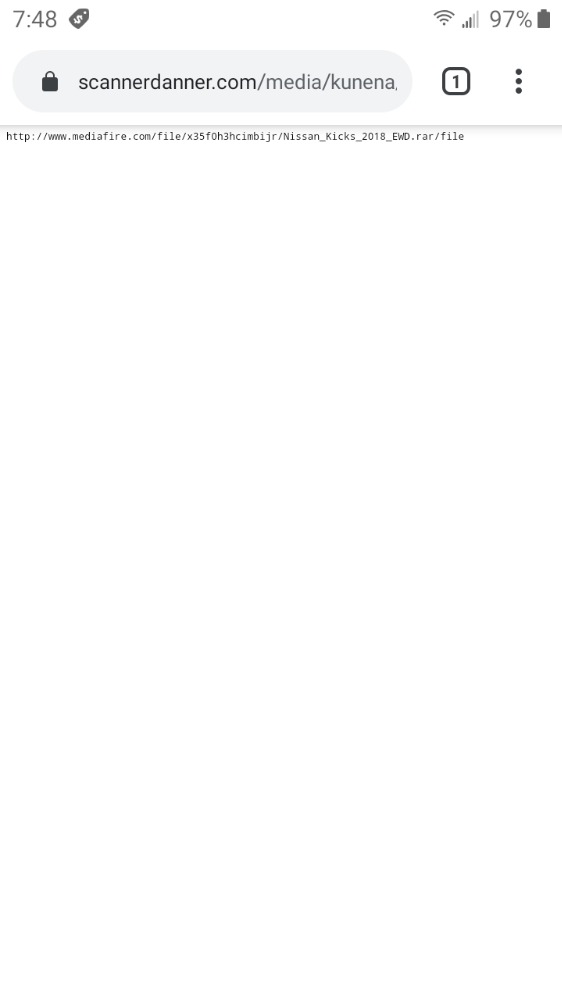

5 years 8 months ago - 5 years 8 months ago #36453 by forumoto
here is a full wiring diagram of complete 2018
File Attachment:
File Name: 2018EWDnis...icks.txt
File Size:0 KB
problem Reappears after driving for 1 hour

5 years 8 months ago #36486 by Cheryl
The link didn’t work

5 years 8 months ago #36495 by forumoto
Cheryl wrote: The link didn’t work
Link has no issue, it is working...

5 years 8 months ago #36516 by Noah
The link also does not work for me

5 years 8 months ago #36539 by forumoto
Copy the link in the above open page and past it in your browser, you will get all the file download and unzip it that is all..
