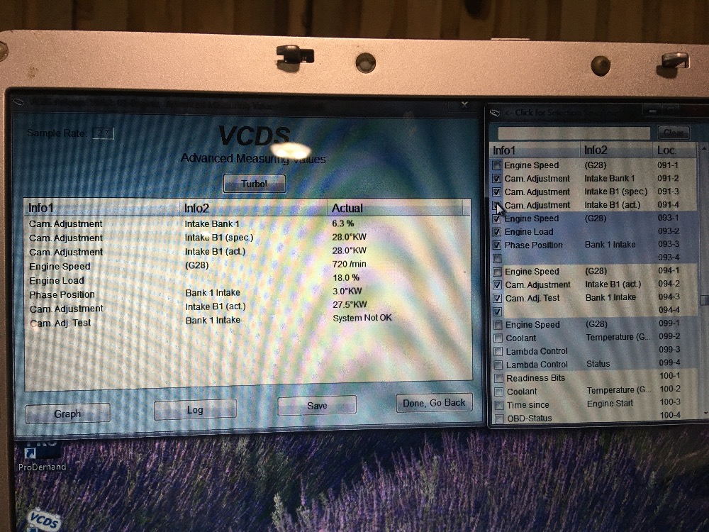

5 years 9 months ago #36262 by Fricker12
Checked camshaft adaptation with vcds and it’s 0.5 degrees so timing and chains all seem fine just won’t move for vvt action, welcoming any other ideas ????

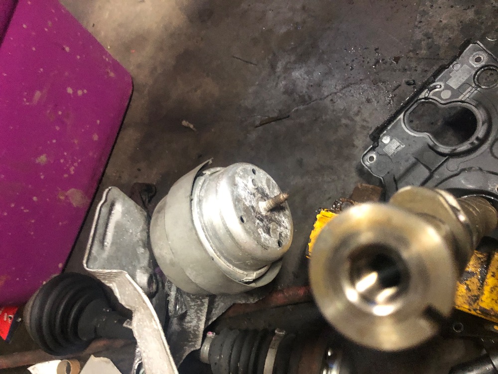

5 years 9 months ago #36283 by Vw mike
Ran into this the other day the dowel pin in end of the cam like to break. Which will lead you to think everything is in time. Especially after someone was thee and did not hold correctly. I can get pictures tomorrow when at shop

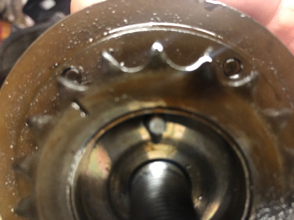

5 years 9 months ago #36285 by Fricker12
Thanks mike, which camshaft ? I’m thinking they are correctly timed as I have a audi camlock tool that slides between the cams and all the timing marks line up and I checked no1 was at tdc to Verify the bottom pulley is positioned correctly too ! Thanks for your ideas and input

5 years 9 months ago #36303 by Vw mike
This pin breaks off. And will cause that issue.
5 years 9 months ago #36313 by Andy.MacFadyen
I have seen the dowl pin break on other engine types ---really confusing.
  • Fricker12
  • Fricker12's Avatar Topic Author
5 years 9 months ago #36493 by Fricker12
Thx mike that’s what I kind of suspected had happened the first time I stripped the car but there was nothing wrong with any of the pin, cam, phaser and I replaced the phaser again anyway and still no luck. And I’m thinking I’d get a incorrect cam timing code from that too, which I don’t get, it says it’s at 28degrees and is ok until I rev it and it doesn’t advance.
