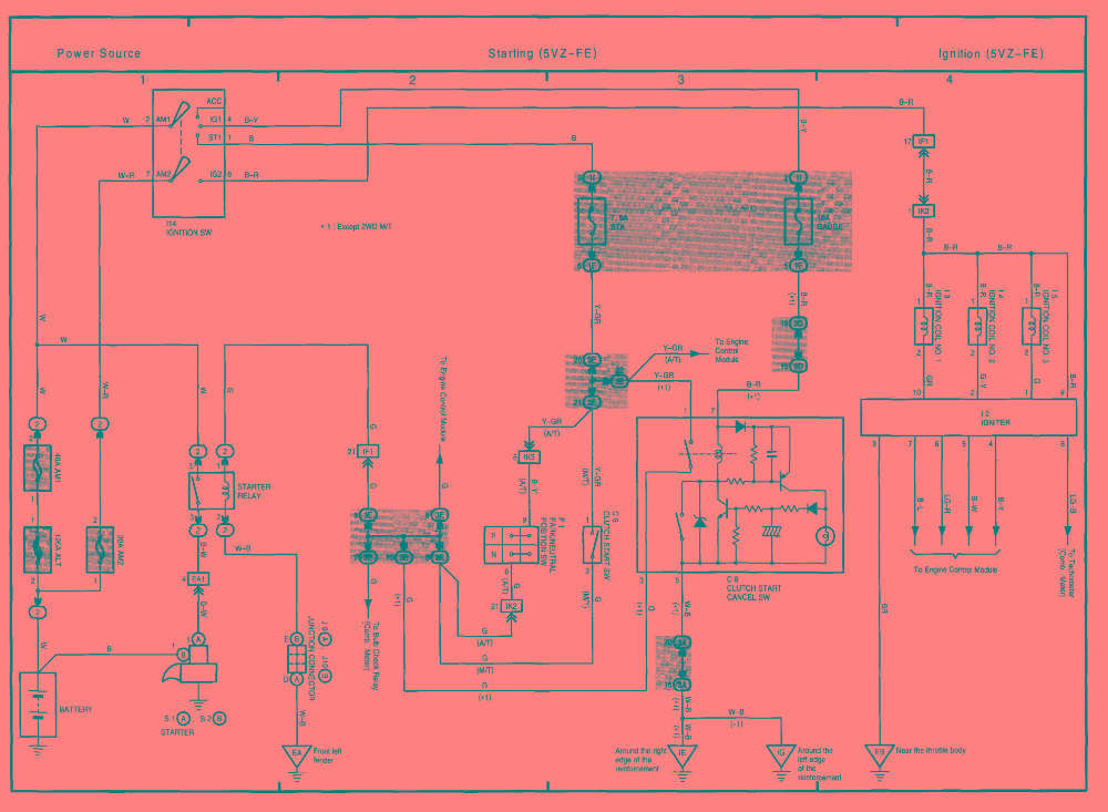

03 Tacoma 3.4L DOHC and it's shaking rattling and rolling. I posted about this truck already but want to avoid the information and brainstorming of the other post interfering or influencing here. I think I went down a few roads that I didn't need to and looked in a couple of rabbit holes that maybe had nothing to do with the issue at hand.

5 years 9 months ago - 5 years 9 months ago #35725 by John Curtis
Replied by John Curtis on topic Causing open loop fault, MAF 100lb/sec
Are you sure the MAF data is correct? Do you have means of checking with another scan tool or a scope?
That would be significantly over reporting.
I would suggest fixing your spark issue first... here is a diagram if you need it.
Last edit: 5 years 9 months ago by John Curtis.
The following user(s) said Thank You: aboudi.naddaf, Otbrecords
5 years 9 months ago #35727 by jreardon
Replied by jreardon on topic Causing open loop fault, MAF 100lb/sec
Otbrecords wrote: The truck had warmed up for 15 minutes and was idling when this live data was recorded. I'm wondering what is causing my open loop fault.
P0031 is a heater code
File Attachment:
File Name: p0031afhea...tlow.pdf
File Size:505 KB
From www.scannerdanner.com/forum/diagnostic-t...-thread.html?start=0
Tyler wrote: 2.) Heaters are not optional
The majority of conventional O2’s are still capable of producing a decent signal with a blown heater element, provided the exhaust is hot enough. Not the case here. The heater HAS to be functioning, or the sensor will never work correctly. In fact, some vehicles will default to open loop fuel control with the presence of a heater fault.
As for the no spark, try the ScannerDanner bypass test: key on (powers up the coils and ignitor), backprobe at the ignitor on the IGT1 wire, touch backprobe with incandescent test light connected to battery positive and watch for spark at either #1 or #4 plug boot to ground.
If this works, then your ignitor and coil is fine. Focus goes to wiring to computer, or computer problem. I'm not sure if cam or crank would be suspect as you have spark on other cylinders and you have no cam or crank codes. It's got to be a wiring problem or computer problem I think.

5 years 9 months ago #35747 by jreardon
Otbrecords wrote: I put it all back together and back probed IGT1 at the PCM harness as well as IGT2 for comparison with engine on. IGT2 is pulsing at 3.9 volts and IGT1 has 0 volts.
That's good you did that check at the PCM harness. Now, was it 0 volts because the wire was shorted? Connect a test light to battery positive and touch the wire. If it lights you have a short to ground.
While you're there, If you can make the ignitor fire the coils at the ignitor connector, but not at the pcm harness, then it's a wire problem.
As far as I know from ScannerDanner's videos, only the injectors get shut down to save the catalytic converter.

5 years 9 months ago - 5 years 9 months ago #35749 by jreardon
Otbrecords wrote: Using positive test probe on all ITGs at ECU makes test probe light up but barely.
Okay so your test light is finding a ground through the computer maybe and that's normal. I can't let go of a hunch that this wire is touching ground somewhere intermittently when the engine shakes during the misfire, causing this signal to get pulled to ground.
Disconnect the Ignitor and the ECU. I'm interested in only one wire and I want you to check for an intermittent short to ground. Rig up your test light to battery positive and connect to any end of this IGT1 wire that's easiest to get to. Then I want to you slowly and gently push down on the harness everywhere you can see where the harness contacts metal. If the test light lights that indicates a short.
Last edit: 5 years 9 months ago by jreardon.
