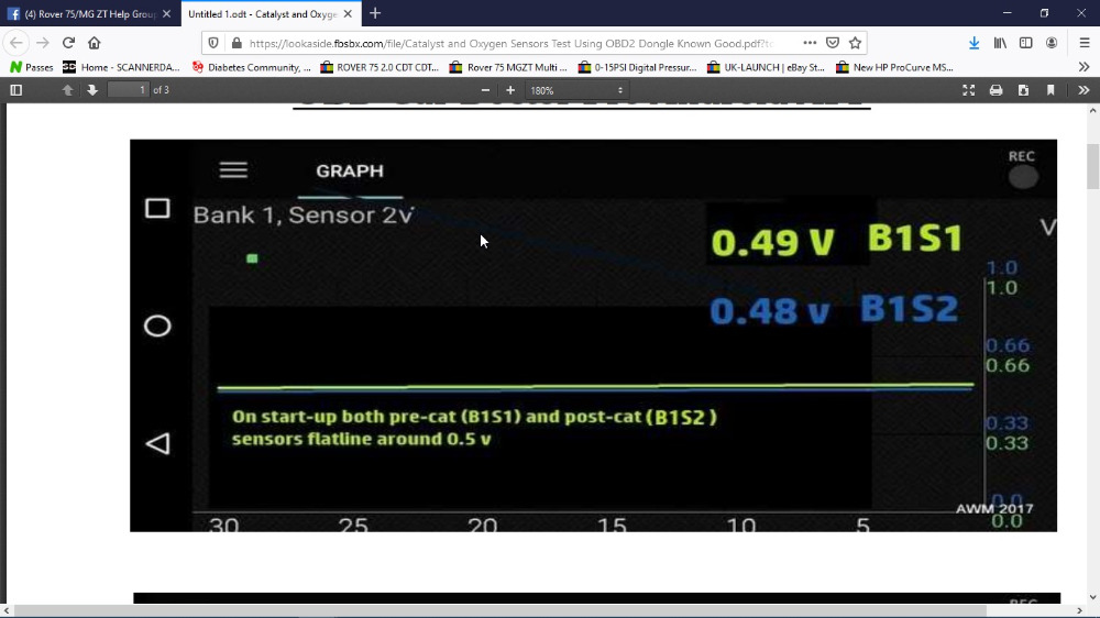

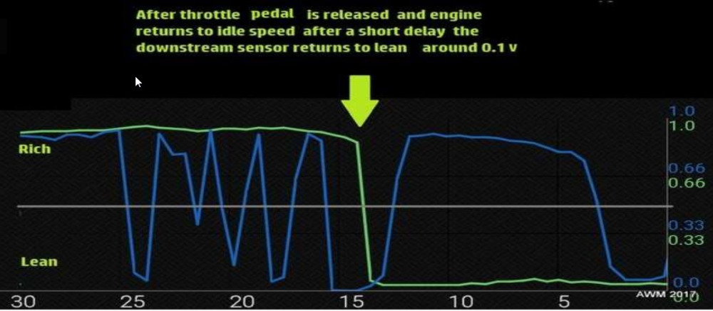

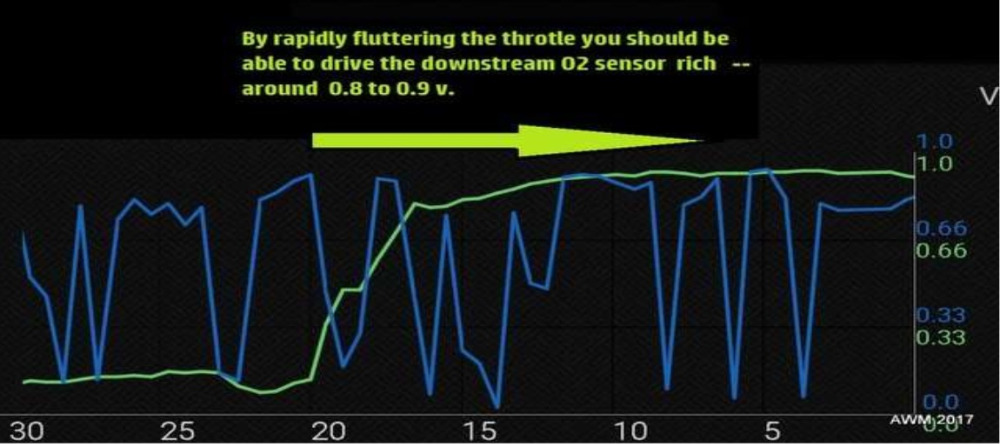

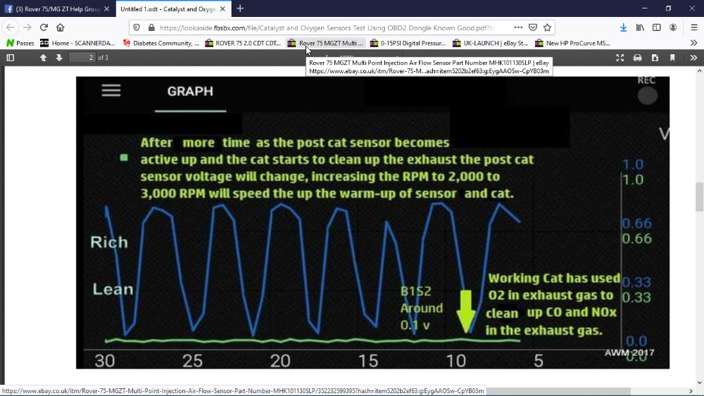

6 years 9 months ago #35630
Replied by Andy.MacFadyen on topic O2 sensor reading
This should explain it a a bit --- this is for conventional Zirconia narrowband O2 as wideband A/F sensors are a bit diffeent. Sorry for the quality I had to screencap the images from a PDF as I lost the original jpegs.
- Gsanchezc1
- Posts: 16
6 years 9 months ago #35643
by Gsanchezc1
Replied by Gsanchezc1 on topic O2 sensor reading
Thanks for the graphs it really helps to picture it better
