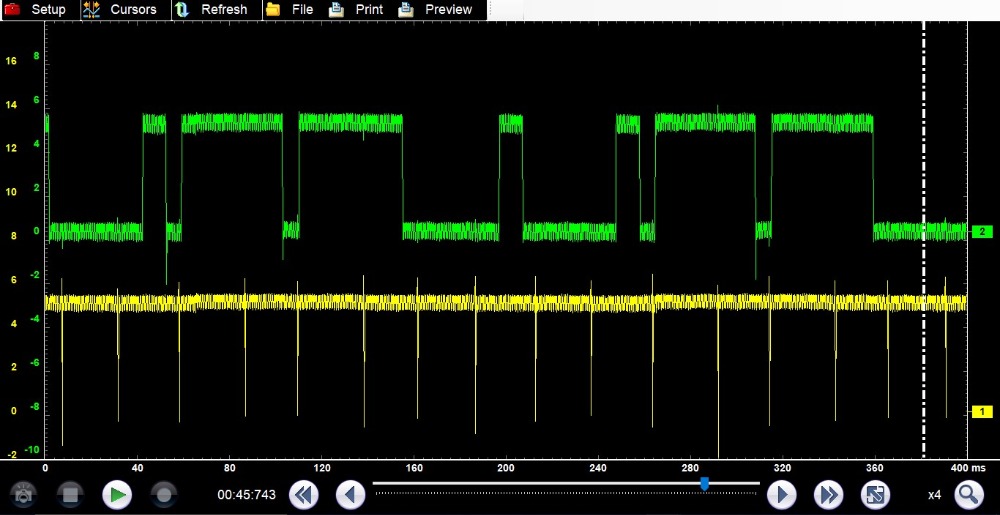

Maybe use an amp clamp on the coil fuses with an ignition sync to see if timing is changing on #2 or #7 when the miss is occuring? One coil getting fielded too little/too much or just flat not occuring should stand out like a sore thumb. :cheer:
It just so happens I ran into my first failed 6.0L crank sensor last week. :lol: Tach wouldn't operate most of the time, long crank. Green is the CMP, yellow is the CKP. There should have been 58 teeth in the CKP waveform...

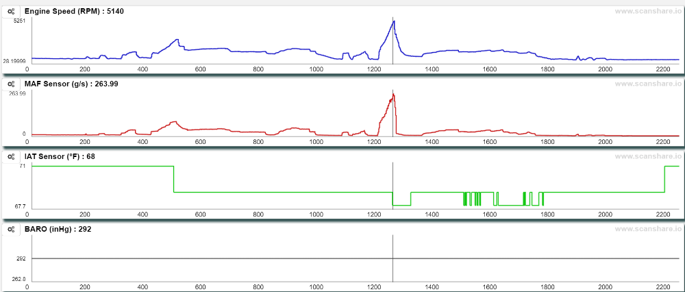

Update performed volumetric efficiency test with original maf sensor only hit 175 grams per second at 5567 rpm 67 degrees iat. New maf hit 230 grams per second at 5600 rpm same temp. Still a little low.
5 years 10 months ago #35320 by Tyler
Replied by Tyler on topic 2005 Silverado 3500 6.0
Yeah I got 68% with your new MAF. :unsure: I know that OHV engines never make amazing VE numbers, but you'd think this one could do better.
I have a known good capture from an '06 Silverado 6.0L, and it maxed out at 263 g/s. That gets the VE to 77%, which I can live with.
