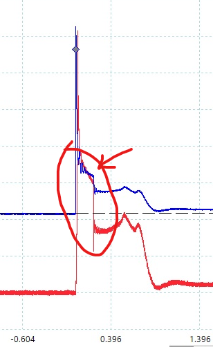

Hi all, never thought I'd be using a Pico on such a car but really could use some advice with the ignition waveforms. It's running super rich and was suspecting ignition system, so scoped primary vs secondary coil voltage as well as primary current and voltage. There are two things that are puzzling me which I'm sure are linked. As the pickup in the distributor grounds the coil, we can see the voltage drop to 0V, great. Then around 3ms later it raises to around 8V, which I can't understand why?
https://ibb.co/NKSw4FL
Looking at the current, it plateaus at the moment the ground goes from 0 to 8V.
https://ibb.co/1RzHHRT
Pickup sensor:
https://ibb.co/8cCpZ20
I can send the amp away for testing but I'd really like to know what the issue is first.
Massively grateful for any help.

The driver providing the ground is intentionally providing a bad ground to limit the current flow. You only need so much current to saturate the coils, any more current beyond that is not needed and just creates heat. That plateau and the ground jumping to 8v is directly tied. My guess is the ignition control module is doing it on purpose because, well, the coil has had it fill of energy, and it's holding it until it's ready to let go of the ground completely. When it lets go of the ground the amps drops to zero and spark occurs.

Have you looked at your spark plugs?
The way the Spark line starts at around 5 Kv, then drastically drops to about 2.5 KV makes me think the plugs are carbon fouled.
It takes more Kv to break through the carbon, but less Kv to maintain spark once the carbon has been penetrated.
