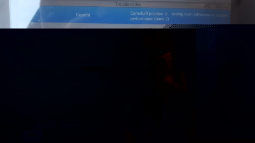

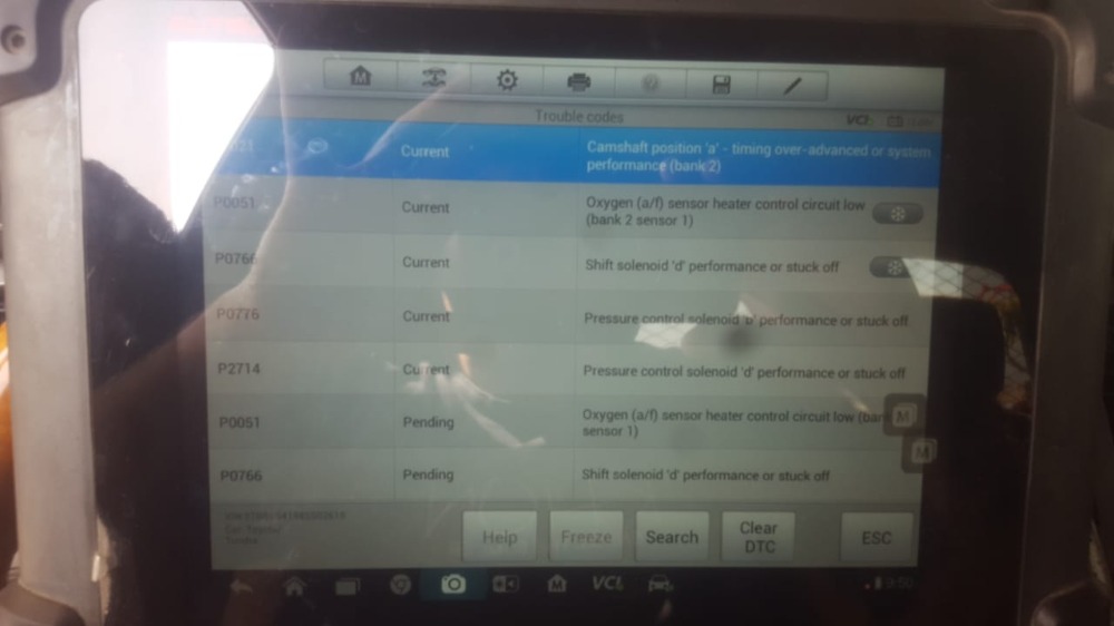

Sometime stall at idle and sime time at low speed no at high speed at high speed it like it dead and weakup
I scope all porwe no powe lost
I paypass the ASD relay
Now code in ecm heater circut for all 4 oxgen sensor
It coumncate with ecm
But the live data show as per attatch

Ah, ok. I didn't see that before. Do you have access to a wire diagram? You can test that o2 sensor to see if there is a short to ground on the heater circuit. According to Mitchell, that o2 heater elements should have between 3 and 30 ohms of resistance.
It looks like you are using an autel in the picture. Are you able to command the vvt actuator with that tool? You should be able to affect engine idle by changing the duty cycle. If you monitor both banks, are the cam sensors reading the same numbers or are they different? When was the last oil change on the vehicle? If you pull that actuator out, you should be able to put power to the solenoid and actually see it moving. You'd want to make sure it does move and that it doesn't stick open too.
