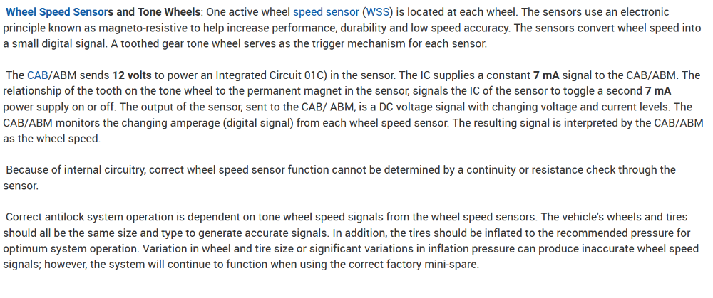

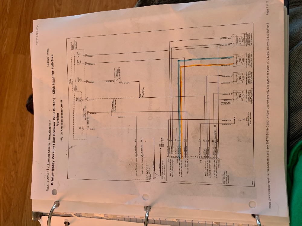

Disconnecting the abs and performing a continuity check, connector unplugged, would that be enough to condemn the sensor? According to Mitchell’s diagram, I don’t have a wire that doesn’t go the computer. Both wires go to the computer. So what do I do now Paul? Thanks.
Pinout is: dark green/violet = 12v feed
Dark green/white= signal wire.
As of now, I don’t know the circuit design because both wires are going to the computer.

Well you can do a continuity check from the module hook one lead to each wire and should see some type of resistance. I’m guessing you won’t but you can compare to another wheel
