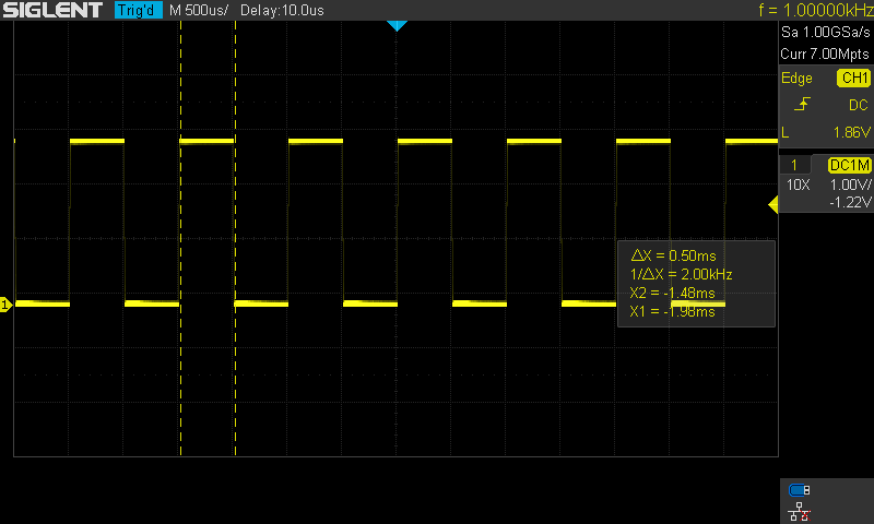

Hey All,
I have a 2008 Suzuki XL7 3.6L that contains a GM LY7 engine.
The vehicle is experiencing random misfire, and misfires on cylinder 2, 4, and 6. I've pulled the codes, I don't remember them off the top of my head but they but they are for those errors.
I'm trying to figure out cam/crank correlation since I know timing chain was a notorious issue with those engine. Does anyone have a known good waveform for this engine? I've scoured the internet high and low, and only managed to really find one diagram for bank 1.

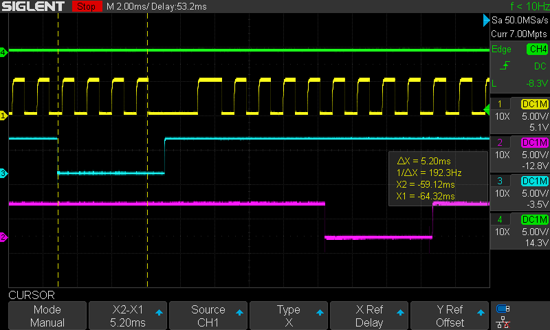

- Midnight_Commander
- Posts: 4
7 years 3 weeks ago - 7 years 3 weeks ago #34061
by Midnight_Commander
Replied by Midnight_Commander on topic 2008 Suzuki XL7 Random Misfire/Timing Waveforms

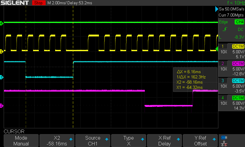

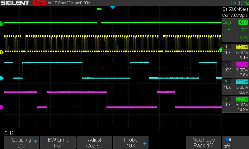

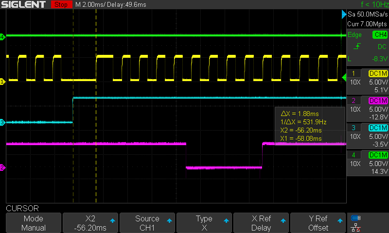

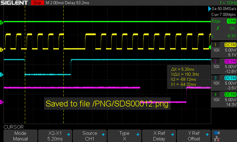

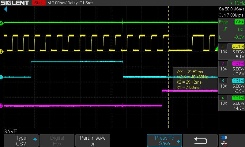

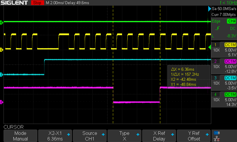

Hey All,
Sorry about the double post. I cleared the obstruction in the cat. but as it seem the misfires are still occurring.
I also got the waveforms off the ECU, I'm still in search of the bank two wave forms from a known good configuration.
Thanks,
Alan
Thanks,
Alan
