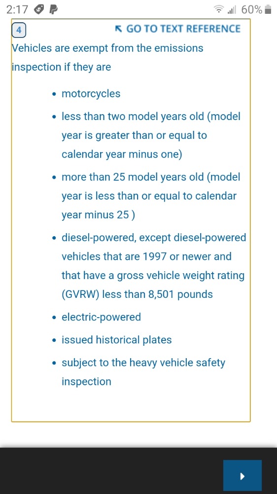

6 years 7 months ago #33938 by Noah
Replied by Noah on topic 1997 Volvo 850, n/a, Closed Loop Fault
New York inspection website says at least 25 years old for emissions exemption:
I have little experience with those cars, but the keep alive memory issue that Fudgie mentioned sounds plausible.
For giggles if it was my headache, I would try to disconnect the battery and hold the positive and negative cables to each other for a minute to give the pcm a "hard reset" (capacitive discharge).
Good luck!
