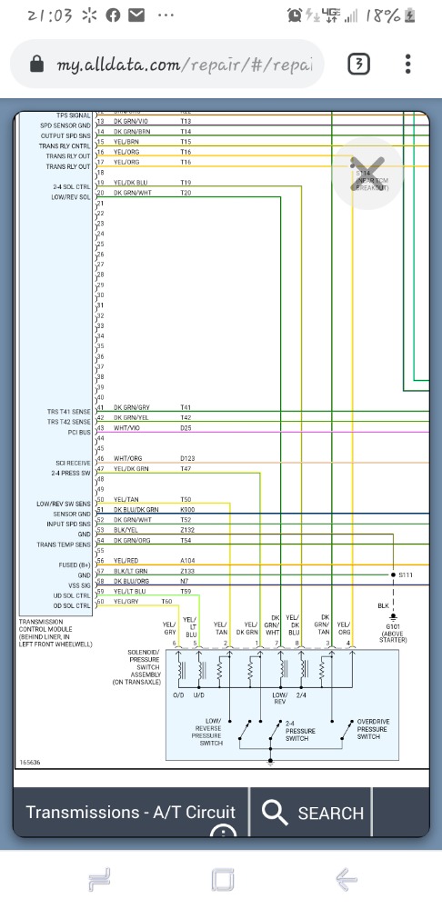

Have been working on a vehicle with intermittent no communication with the tcm.
Today, while doing power and ground checks on a TCM on a 2003 chrysler town and country 3.8L, I found the grounds to the tcm to be .100-.150 V. Knowing this can cause problems with vehicle computers, I began doing voltage drop checks on the grounds. I found voltage drops of .100-.150 between various points on the block, the alternator housing, grounding points, etc.

Tcm gets its ground on block above starter on this vehicle according to wiring diagram.
7 years 1 month ago #33792 by Kurr
Replied by Kurr on topic .150 V on engine block?

7 years 1 month ago #33795 by Kurr
Looks as though the pcm shares the same ground. Was just wanting to make sure there wasnt anything else that could rule out a new tcm, but it appears that would be the issue. Hopefully the transmission did not get ruined in the process. Thank you for your input, cheryl.

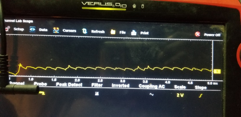

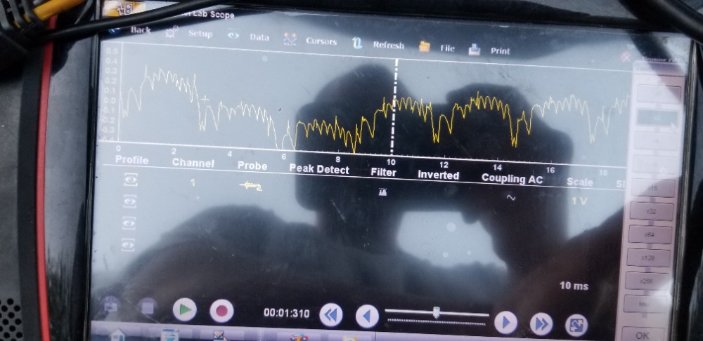

7 years 1 month ago - 7 years 1 month ago #33847 by Kurr
Attached ac ripple from alternator, old alternator and one I put on this evening. Also brought the engine grounds down to .090 V. Still having tcm issues.

7 years 1 month ago #33848 by Cheryl
Replied by Cheryl on topic .150 V on engine block?
Sound like a bad tcm
7 years 1 month ago #33872 by Kurr
Sure does. Now that I have a ground I am comfortable with, I feel more comfortable calling the bad computer. I'll follow up as the work continues on.
