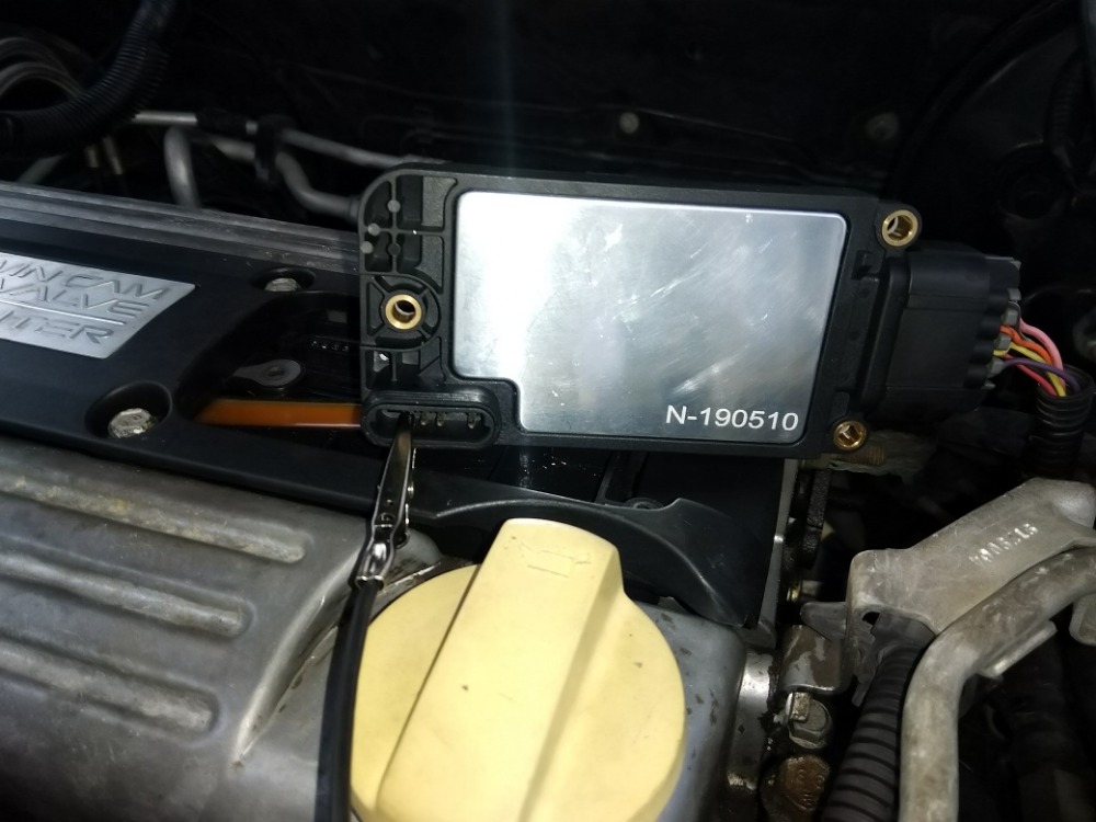

  • shuttlrep
  • shuttlrep's Avatar Topic Author
5 years 11 months ago - 5 years 11 months ago #33810 by shuttlrep
Replied by shuttlrep on topic 2.2 Ecotec Crank no Start no Spark
I am sorry I read wrong but here I did connect to the control module as instructed still no blinking of the light when I turn the motor over but the light test good on the block.
The other control wire is the same. there is current to that center pin with the key on.
Last edit: 5 years 11 months ago by shuttlrep.
  • shuttlrep
5 years 11 months ago #33811 by shuttlrep
Looks like the clip is touching the block but its up off there resting on the oil cap.

5 years 11 months ago #33830 by jreardon
Replied by jreardon on topic 2.2 Ecotec Crank no Start no Spark
Assuming injectors are being controlled that suggests the CKP signal is getting to the PCM, through the ICM. That suggests the CKP signal is fine.
Doesn't hurt to check anyway - test light to bat+ and on an injector control wire while cranking.
Confirm power and grounds to ignition module:
1.) voltage drop while cranking (dc meter to bat+ and pink wire at ICM; close to 0 volts reading is ideal while cranking)
2.) substituted load test with headlight bulb(s) (ICM fed by 10a fuse so something around that amperage) between pink and black wire at ICM. Brightness should be same if you connect this load straight to battery terminals. If you do this test with a proper load, then #1 and #3 can be skipped.
3.) test light to battery negative, touch on black wire, crank engine (test light lights = bad ground)
However no coil control suggests a bad ICM. You tested for coil control without the coils attached so the ICM should have had enough juice to at least switch a transistor to ground. Seems like a bad ICM.
But you already put in a new ICM. Maybe the coil primary is shorted and killed the coil driver. Did it come out of the box bad, or did it turn bad when you installed it I don't know.
Check coil primary circuit ohms. It should be low ohms, but not 0. I don't have the specs for this.
Side note this has nothing to do with no control from ICM and no spark but your compression readings: look at the compression for the other displacement engines lol.
