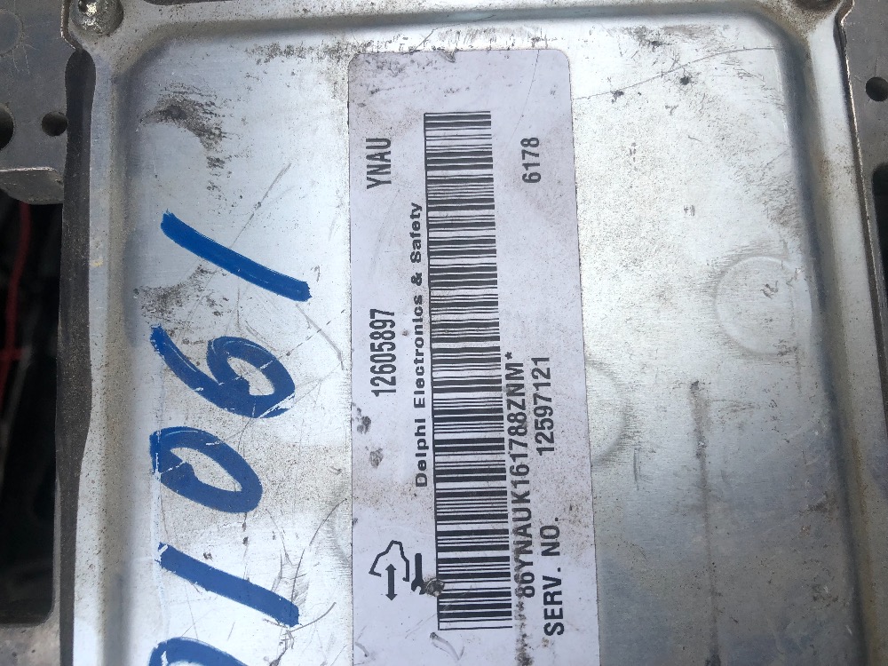

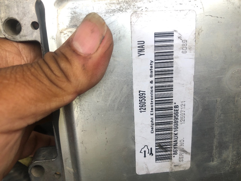

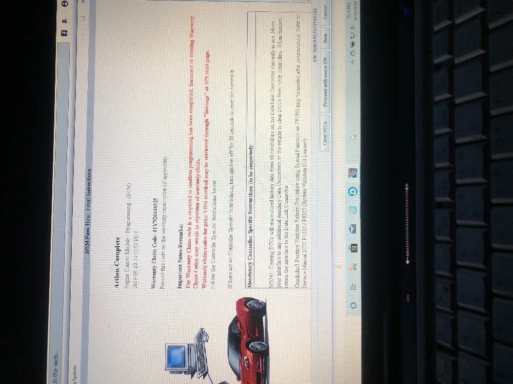

Hello guys. I have a problem with this suburban . I did the diagnostic and was the 5 volt circuit. Not workig right so i take the ecm to get repair. After a day they call me and say the processor was bad. Cont be fixed . So I bought another ecm from the junk yard with mach number . I pay 43$ at the acdelcotds. For programing. I did everything. I completed the programing. I cleared the codes.
Then i did the relearn key .
But the truck. Crank but no start

What are the calibrations on the new used pcm vs the old pcm? Just asking if it put the same numbers in as the old one had.

Well i use the vin # from this truck.

Check the number on the back of the ecms And i use. The vin #. From the sticker at the door

Well guy i just want to thank you for all the help. The solution was.
I find another ecm at the junk with the same. Number. So what i did was just plug it. And do the key relearn
11min. Swich on
30 sec. swich. Off
11.........
30...........
11........
30........
30 sec. switch on.
And start right away. The. Did the crank relearn.
And its running like a champ
No programing need this time
No vin mismatch codes. At the ecm.
