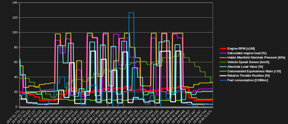

I've collected all sensor data from my car, and I've chosen certain sensors (as the reply above) for a particular period (one minute) during which I had pressed full throttle (wide-open throttle) as presented in the image below. I've attached the entire file (more than 10 minutes) as well in CSV format.
6 years 11 months ago #33759 by Tyler
Replied by Tyler on topic Acceleration problem with full throttle
Thanks for posting the data! :)
Having a look, we can say that the MAP is functioning correctly, and that there likely aren't any intake restrictions. The ECM seems to be commanding fuel enrichment when it should in response to WOT.
We were missing a couple important PIDs, unfortunately. Commanded Equivalence Ratio is there, but we also needed the upstream air/fuel ratio sensor OR Equivalence Ratio B1 to really tell what's going on with the fuel delivery system. That'll tell us if the engine is getting enough fuel at WOT or not.
Speak of, if you decide to go for another data recording, it'd be better if you did a run from a stop to near redline at wide open. That will stress the engine the most, and also give the data logger a better chance of catching the issue.

6 years 11 months ago - 6 years 11 months ago #33765 by Mustafa W.
Replied by Mustafa W. on topic Acceleration problem with full throttle
Thank you for your reply.
The graph above is a one-minute portion of a 10-minute data recording for those PIDs.
However, I've done another 7-minutes recording with ALL PIDs available through the software (Auto Doctor) just in case I was missing something, but I cannot see neither "Upstream Air/Fuel Ratio" nor "Equivalence Ratio B1". Maybe they are named differently? Here is the full list of all the PIDs available:

I can provide you with graphs for any particular variables/PIDs from the list above, since the data is already available on my computer in a spreadsheet. Just tell me which ones can be useful for the diagnosis.

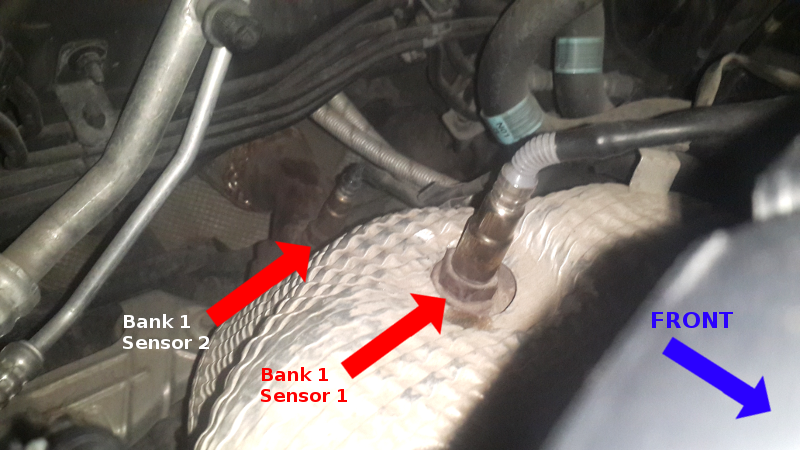

Yesterday I went to the local workshop I mentioned earlier. He opened the first sensor, inserted his endoscopic camera. Surprisingly, there was NO CATALYTIC CONVERTER!!
Yes. The catalytic converter was missing! He suggested that since my car is a salvage title, apparently some looter had "salvaged" the catalytic converter before or during its repair process, leaving an empty exhaust manifold casing!
(Only the inner core is stolen, leaving a hollow external casing that is connected to the remaining exhaust parts as usual).
I'm planning to get one (which will cost a lot, unfortunately), but only after I can resolve the current acceleration problem.
With that unexpected twist, what is the next most likely diagnosis rather than a clogged cat? What is the next step?

6 years 11 months ago #33861 by Tyler

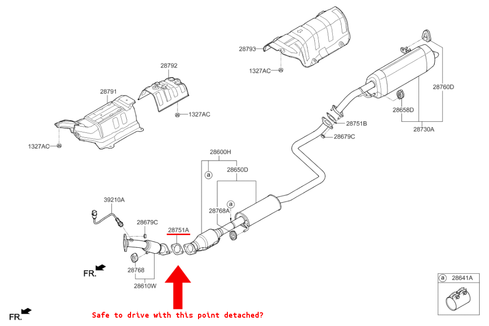

If the upstream cat is empty, then it'd possible it broke up and went downstream in the exhaust system. I'm not familiar with this specific car, but the next likely place would be either another downstream cat, a resonator or the muffler itself.
Again, you can test for this by disconnecting the exhaust behind the cat, but ahead of the resonator/muffler. If the power now improves, you can disassemble the exhaust further and find where the first cat ended up. ;)

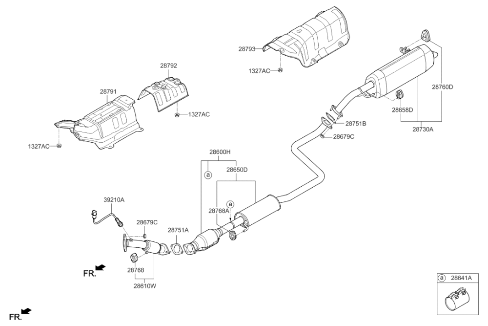

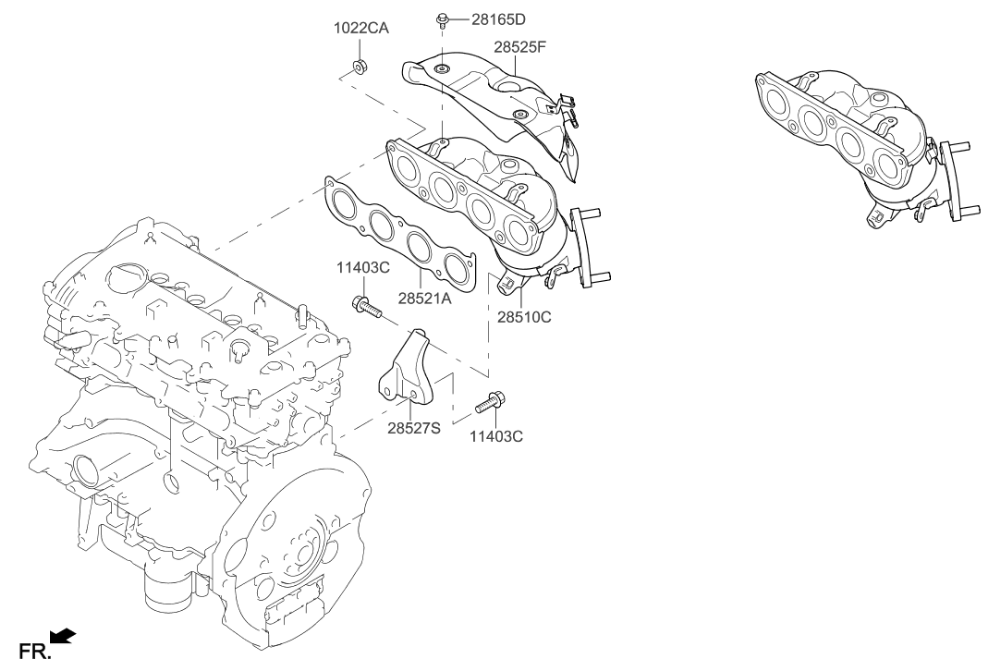

My primary catalytic converter is located right behind the engine within the exhaust manifold (picture below)
This, in turn, is connected to the rest of the exhaust system (picture below)
I'm not sure if there are any secondary catalytic converters, or those are just mufflers and resonators. But considereing the fact that only 2 oxygen sensors are present within the exhaust manifold; I assume there is only one catalytic convertor.
So, you believe there is an exhaust obstruction issue here? right?
I was wondering if the low backpressure (caused by lack of cat core) can itself result in such problem? or is it unrelated? Since I do not really know how do those sensors actually work and affect the engine...
6 years 11 months ago #33882 by Tyler
You're assuming that there's low backpressure because the upstream cat is empty, but has anyone done a backpressure test yet? If my theory is correct, and that the upstream cat came apart and went downstream, then it's still very possible to have excessive backpressure, causing your symptoms.
Low backpressure will not cause a lack of power.
The next most likely place for a restriction is part #28600H or #28650D, which is the downstream catalyst and the resonator. Either one can collect the remnants of the upstream catalyst and cause excessive backpressure.
Tyler wrote: but has anyone done a backpressure test yet?
Unfortunately I couldn't get access to any backpressure gauge here, and local mechanics simply don't use it! They rely on "disassemble-and-see" and "change-parts" approaches, which are not really what I'm willing to do yet!
I didn't perform the open-O2-sensor test, since the weather here is really hot, and I'm not ready to risk causing damage to the engine and/or other surrounding parts under the hood due to circulating hot air within the hood compartment.
But I was thinking: is it safe (regarding damage/risk of fire) to detach the exhaust system at the part #28751A and drive the car?
I'm aware of the related health risks (unhealthy fumes and carbon monoxide), and I'm willing to take safety measures accordingly. But my major concern here is whether there are risks of fire and/or damage to car parts due to extremely hot air flowing where it shouldn't??
6 years 11 months ago #33892 by Tyler
It'll be reasonably safe for a short period of time. I'm guessing there's heat shields in place along the body where the exhaust runs, so you're not likely to set the carpet on fire. :silly:
Just keep your eyes open for any fuel system components for wiring nearby. Disconnect the exhaust just long enough to see if there's a difference in performance, then shut the engine off and reconnect it. Don't forget to secure the resonator side of the exhaust if the existing hangers won't support it.
