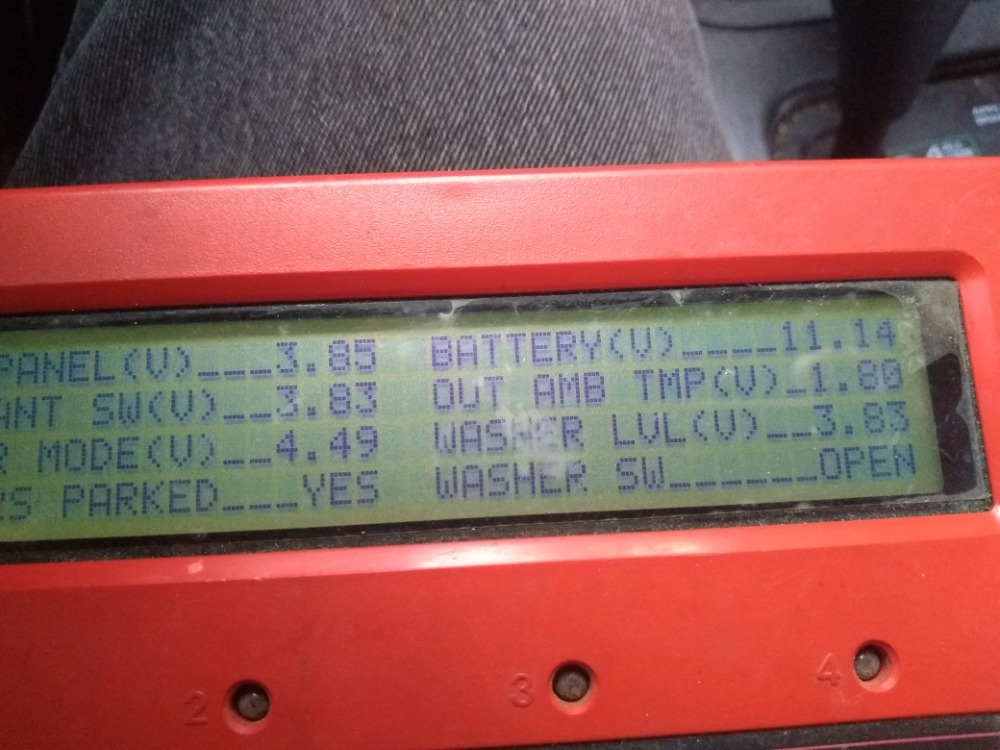

I'm seeing low battery voltage in the BCM.
Anyone out there with a scanner and a WJ able to check the voltage in the BCM? I'm fairly certain I should be seeing true battery voltage. I'm seeing around 8-11vdc. See picture.
Thanks!
I'm searching for something that is draining the battery if not driven in a week or so.

Did you perform a parasitic draw test?? Either pulling fuses on at a time til the draw goes away or measure voltage drop across the fuses one at a time

Thank you for the reply.
Yes, I've tried voltage drop testing and pulling fuses keeping track of the amp draw on the battery. I'm thinking that the BCM may be waking up and draining the battery.

Make sure it’s the bcm band not one of the things it controls
