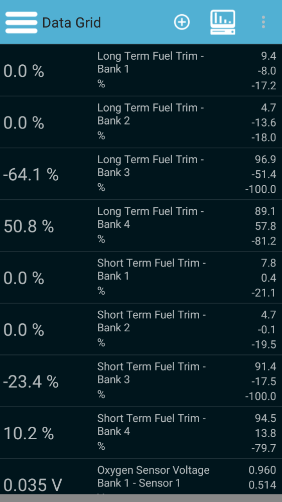

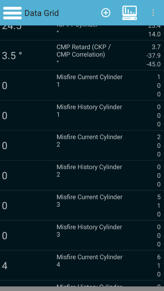

Today I bought the BAFX bluetooth thing, and DashCommand. Screenshots are below. Some of the fuel trims seem way out of whack. They also vary widely. The screenshots were taken over about a 20 minute period.

Not familiar with that scan tool however you can’t always trust scan data. Can it graph? I’d like to see fuel trims AND O2 data.
Also freeze frame data for the code.

Can you do a Relative Compression Test? Or, disable fuel and LISTEN for an abnormal/rhythmic engine cranking cadence.

The freeze frame for when the code is set is below:
Fuelsys1 - CL (closed loop?)
Fuelsys2- CL
Load_Pct % - 21.6
coolant temp - 198
Short term fuel trim 1 - 17.2%
Long term fuel trim 1 - 12.5%
Short term fuel trim 2 - 21.1%
Long term fuel trim 2 - 12.5%
MAP (kPa) - 23.3
RPM - 1847
VSS (km/h) - 52
MAF (g/s) - 6.601
TP% - 30.2
  • VegasJAK
  • VegasJAK's Avatar
  • Silencing the Parts Cannon
6 years 11 months ago #34960 by VegasJAK
Replied by VegasJAK on topic 1999 Suburban, chasing a cyl 3 misfire
those fuel trims indicate you have a rich condition...
CL is Closed Loop... the 02's are working.
What do the ST and LT fuel trims do when you raise the RPM from idle to 3k.
