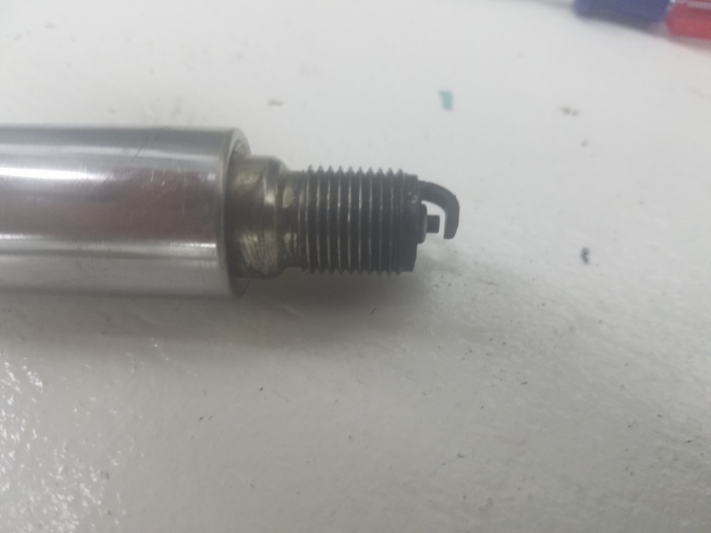

1987 GN that has had a persistent random idle miss when warm. Does not appear to have it when cold or off idle. Engine speeds up and down randomly 800 - 875 rpm and coincides with the miss. Also have an 1989 Turbo Trans Am that has the exact same engine that runs %100 perfect. Have swapped every single bolt on part, except the crank sensor, from the TTA one at a time with no improvement in the GN or degradation in the TTA. The hydraulic cam was beginning to wear out so I hired a shop that specializes in these cars to replace the cam with a roller cam and put in aluminum ported heads as well, hoping it was a valve train issue. Cam is a Comp Cam 206 206 which is mostly stock except for a bump in the upper mid range. Car has more power but still has the exact same miss issue. Confident there is no change in idle quality with the cam and head swap - no worse no better. Replaced fuel injectors as well with new ones with the correct matching chip. Fuel pressure looks to be stable. Bought a smoke tester - no vacuum leaks. Ran a shop vac in blow mode into the tailpipe and verified no pre O2 exhaust leaks. EGR has been permanently blocked.
With the car running if I unplug the cam sensor the car runs rougher and obviously throws a code. When you unplug the cam sensor the car is supposed to throw a code but run in batch fire mode and have no visible change in idle.
Did the screwdriver check for the injectors - never heard one drop out.
Chip is designed to run in open loop at idle. At idle INT stays on 128 and BLM for the most part stays on 121. IAC is between 13 -15. IAC at pure idle should not wander. So the car is running rich and the computer is pulling fuel out. Wife has been complaining when I go back in the house after working on it because I smell like gas. I was reading that you can tell something about what the engine is doing by the smell of the exhaust but can't remember what it was? Maybe if it is burned or unburned gas?
Have an aftermarket ignition system designed just for these cars that has built in diagnostics to tell you if you are having crank or cam sensor issues. www.tr6.bailey-eng.com/TR6%20User%20Manual%201.1.pdf Never throws a code other than when I unplug the cam sensor.

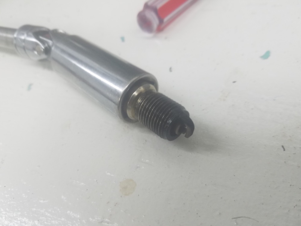

Attached pics of one spark plug. I took out all 6 and they all look the same. Rich.
The only parts I have not changed on this car are the crank sensor and fuel pump. Crank sensor is original and fuel pump was changed in 98'. I have both and will likely change them this weekend.

How rough does it run?? Also the chip you have runs in open loop?? You swapped every piece from car to car. Maybe try swapping computers? Got anymore scan data?

Also if you don’t have scope when it starts misfiring try cooling off the crank sensor with water see if miss goes away??

Making progress? Misses are less and the car just sounds stronger at idle.
Replaced the plugs. Found out that it can help to reduce the air gap on the crank sensor on the outside - so bigger gap on the inside.
Tried spraying cold water on the crank sensor. Seemed like it may have helped. So I will go ahead and replace it. It is 32 years old.
Found out the Turbo Tweak chip can be set to idle in closed loop. Did that. Having these cars idle in closed loop typically makes the idle worse. So now after these changes I will try putting the idle back in open loop and see what happens.

Misses are definitely less but I can still hear the engine speeding up and down randomly. Almost like a cylinder is dropping out randomly. I think this is where the scope would help.
