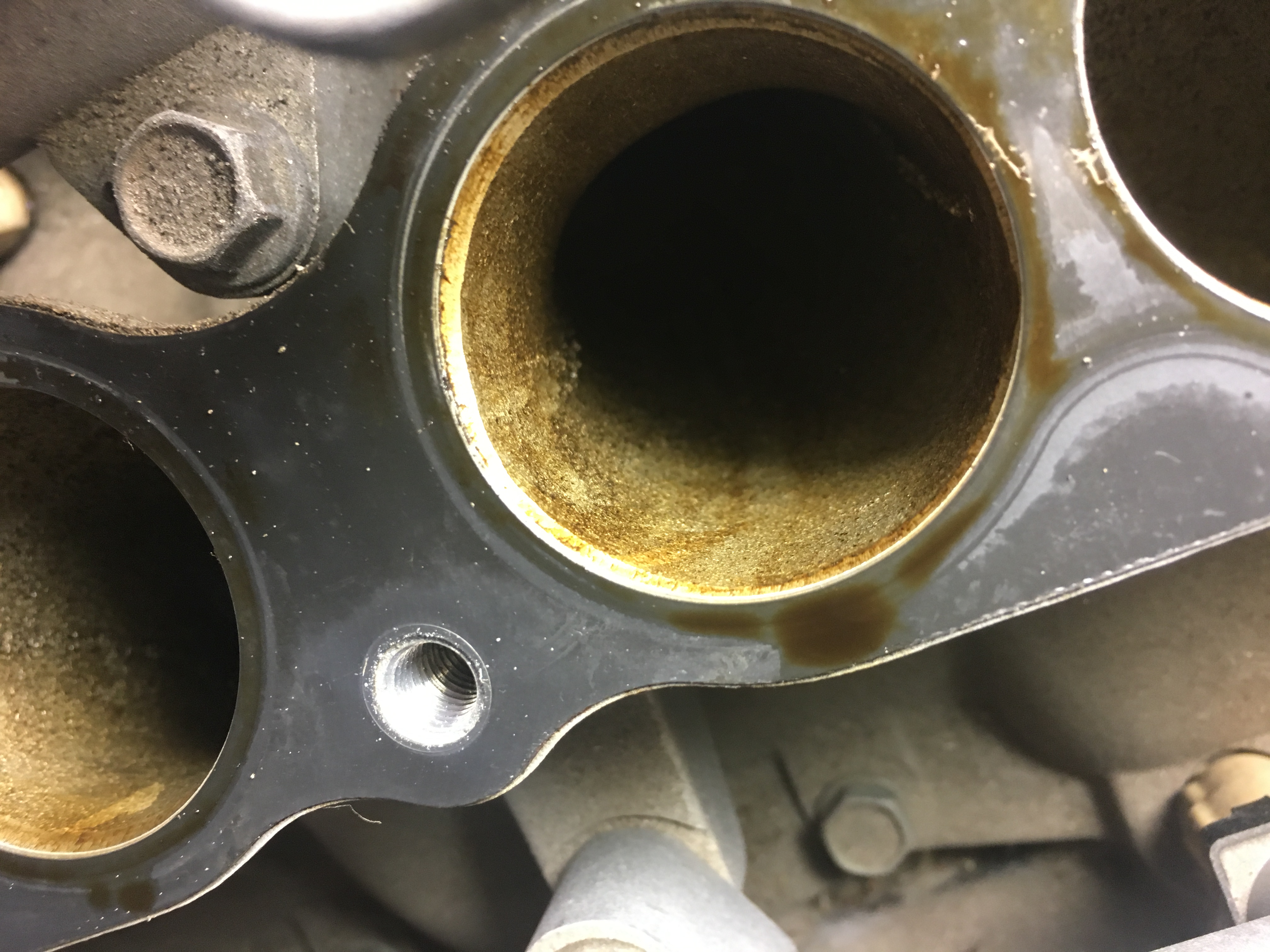

I have Santa fe 07 with misfire codes on cylinder 2, 4 and random.
I have done compression test and it pass with the specs.
After engine goes to closed loop and after about 1 minute on idle the engine starts giving misfire the codes says cyl 2 and 4 and random. When i listen to the injectors only 4 stops "ticking" when listening on it (This engine will shut of the injector after 46 seconds after failure by the ecu) if i am correct these injectors are ground sided. the rest of the injectors are not being shut of by the ecu. I let my Hyundai garage trubleshoot and they said "The injector looses ground and you need new ECU and that costs 2000$". After i said that the injector is ground sided switch and it will shut of after 46 seconds they said "What the hell are you talking about????". I sent the car to another garage for a smoke leak test they found no leaks (This garage made a mistake to diagnose a bad fuel injector pump on a disel car before after they only installed the belt wrong). They are the only garage near me with smoke machine but i dont have to much trust in them.. i decided to pull of the plenum to do a compression on all cylinders (The previous was only on the 2-4-6). What i found is somewhat strange i think. Oil everywhere and the bolts on the intake manifold Y V6 Engine. where all very loose. In my head this can be the cause of my misfires on idle and i will change all the gaskets. please look at the images and tell me if you think if it was leaking or not. Seems like the oil is caused by that i can blow air trough the PCV valve from both sides (I hope this is that problem). Forgot to take images when i removed the intake Y but both sides looked like the images i attached

Yes, you are right. Those lossen intake manifold bolts can cause misfire.

John Curtis: I did a leakdown test today.
Cylinder 1: 45% Air coming out of exaust
Cylinder 2: 15%
Cylinder 3: 15%
Cylinder 4: 15%
Cylinder 5: 45% Air coming out of exaust
Cylinder 6: 15%
The ones with 15% i could not find where it went and they where not EXACLY 15% but somewhere between 12-17%
The spark plugs on 1-3-5 looked red'ish and 2-4-6 looked just normal.

I think i have found out why Bank 2 is giving me these misfires and low compression. The cam has been having a good meal of metal
