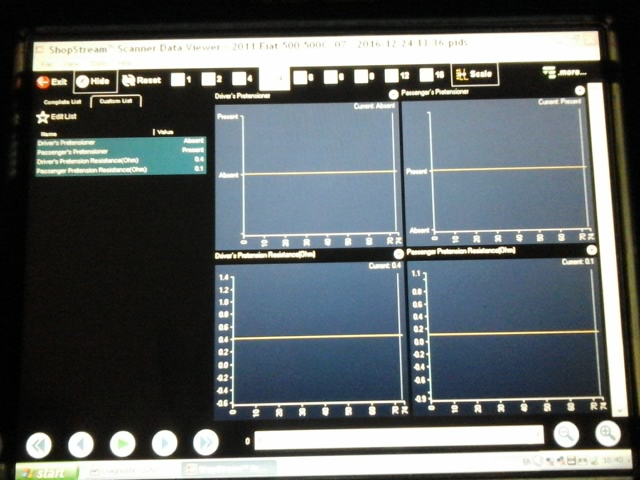

9 years 10 months ago - 9 years 10 months ago #4408
by paul.simpson
Replied by paul.simpson on topic Seatbelt pre tensioner fault
Hi thanks for that .
Based on the fiat it doesnt have side bags has in the roof sides or rear quarters panels or doors but does have bags in the side front seats only.
The driver pretensior is not seen, resistance is at 0 .4 ???
I have used a 300 ohm resistor but it failed to put the air bag light out
Can i safely measure the voltage / current through this circuit once i get a electric diagram.
Air bags scare the shit out me.
Last edit: 9 years 10 months ago by paul.simpson. Reason: More questions added

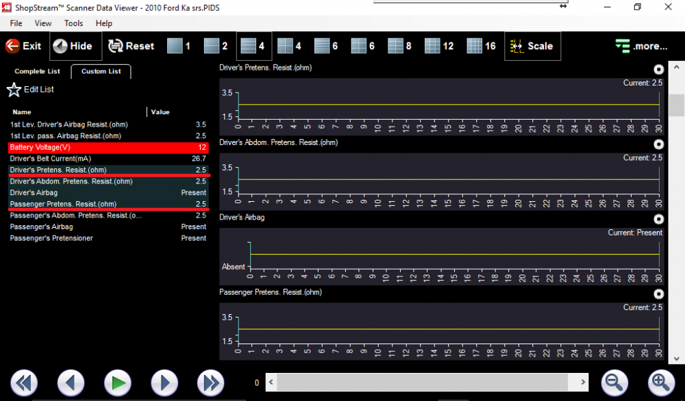

9 years 9 months ago #4487
by steve
Replied by steve on topic Seatbelt pre tensioner fault
Is the fault code for the driver or passenger pretensioner?
A 300 ohm resistor is too high the resistance is normally somewhere between 2.2 - 3 ohms, try one in and see if live data changes
The amount of current will be in the milliamps range and will be difficult to measure
I've attached a wiring diagram
