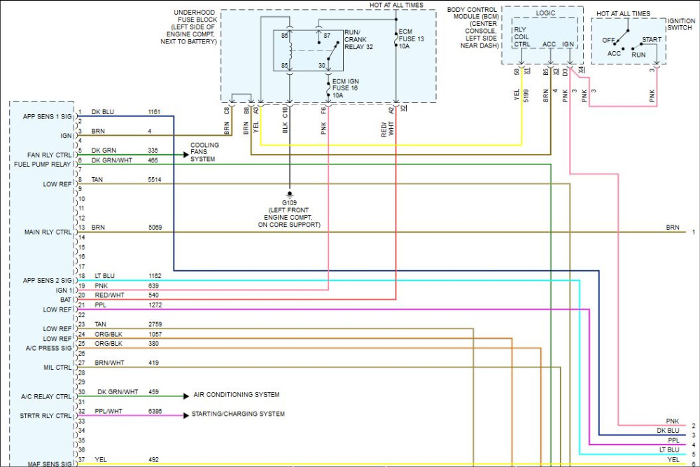

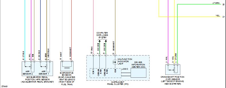

08 Saturn aura 4cyl started with no start no crank . Jump crank relay and cranks. Replaced ignition switch. No help . 5volt ref good. Replaced ecm and went threw 10min 3 times with key. Cranks now no start , no noid. , spray either in throttle body engine starts???

Any codes in any modules??

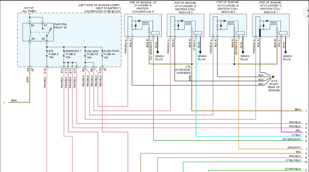

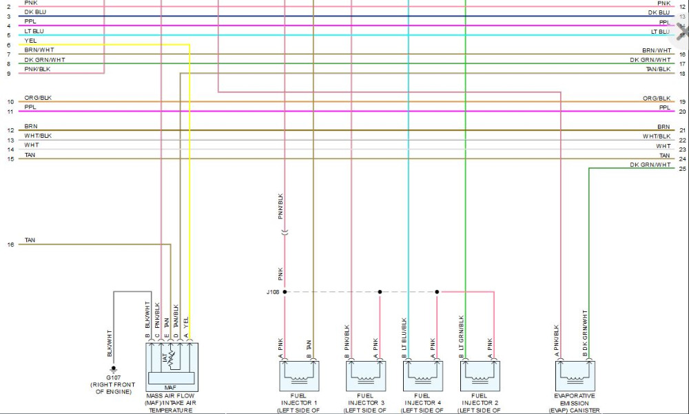

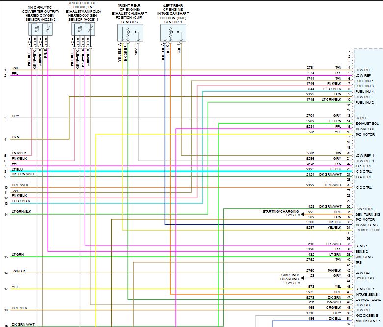

Just asking you have power to the injectors??

Power to injectors no noid

Code port wont read shows err

I’d be checking powers and grounds at the pcm if you can’t communicate with it.

Thanks I need to find wiring diagram for that check at pcm. I checked injector harness no positive current and ground side hardly lights very dim. ??

Also the scanner says crank sensor relearn

engine cranks and runs on starting fluid , no injector pulse , no 12volts to injector harness , ground side is very dim . replaced ignition swich and pcm, engine code crank sensor needs relearn. ?????????

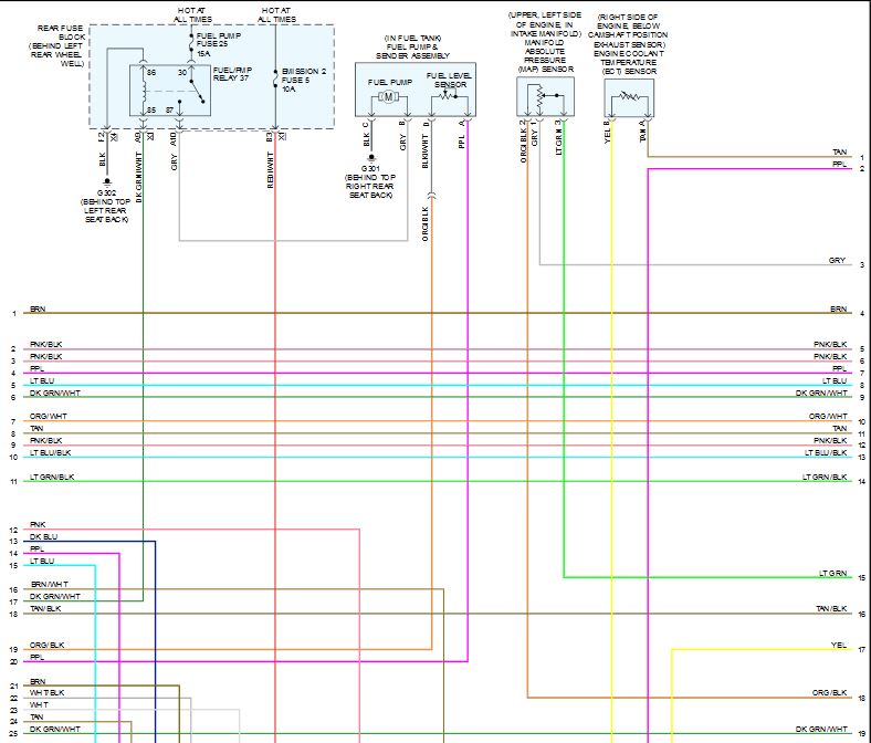

That’s what I asked earlier do you have 12 volts to one of the injector wires during key on or engine cranking. Have you checked the fuses yet?? Also the engine has a schrader valve have you checked fuel pressure???

Also how are you checking the ground side?
