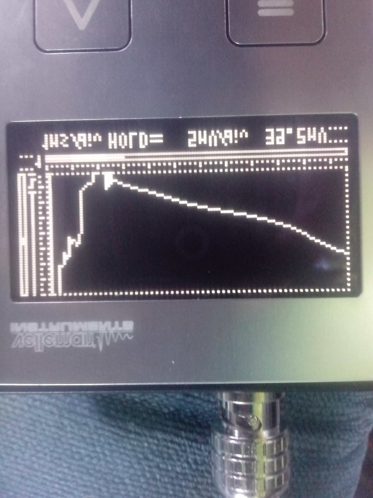

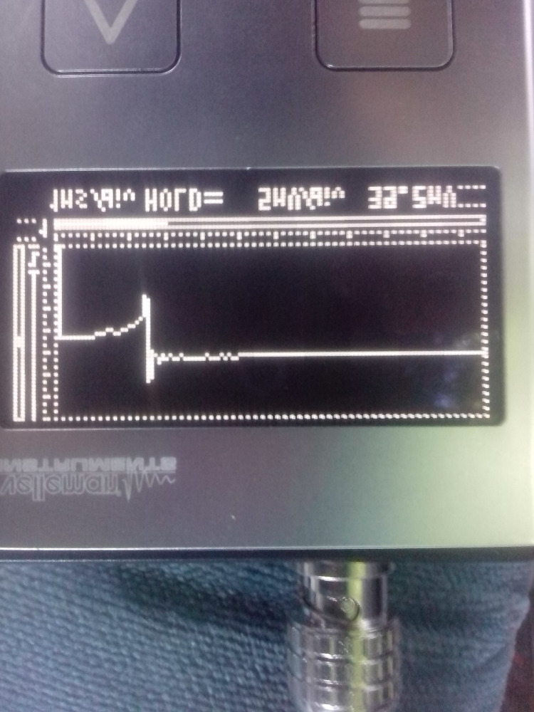

Vehicle is 1994 Ford E-150 5.8L V8
Ignition is TFI-IV Push Start (NOT computer controlled dwell)
Symptoms are:
-Misfires and surges at idle,
-no noticeable symptoms while driving at low load (i.e. high rpms, relatively closed throttle, not up a steep hill)
-misfires increase in frequency and intensity as load increases (due to incline AS WELL AS when throttle opening increases)
-barely visible (even in total darkness) blue flashes in and around where spark plugs thread in to block (there is no visible arcing through the wires or boots, which are new). This occurred on all plugs I could get my head in to look for them on.
-No codes
Whole secondary ignition system is new (yes I have been parts swappin pretty hard). This includes the only coil in the system, coil wire, distributor cap and rotor, plug wires and plugs.
Attached photos show secondary ignition waveform on one cylinder, it is typical of all the cylinders I tried. (I have flipped the images for your convenience as on my scope they were upside down). Photo 1 shows what I would consider a normal reading, photo two shows the other reading I was getting. In practice the scope was showing a rapid flashing back and forth between these two wave forms.

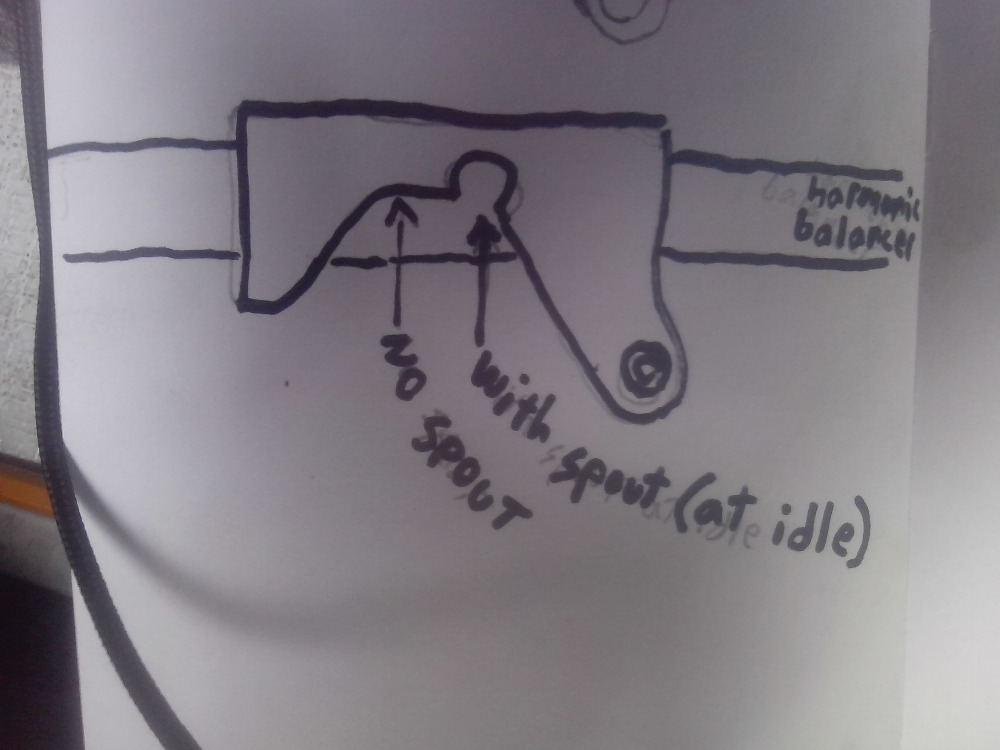

IN OTHER NEWS I checked the base timing (with SPOUT shorting bar disconnected) and advanced timing (at idle) but was unsure of how to interpret the indicator. The drawing shows the pointer/indicator, which is fastened in two places to the timing chain cover (this is the complex shaped piece with the swoops and small punched hole), the harmonic dampener (the long rectangle) and the arrows show where the cylinder 1 TDC marker appeared with BASE TIMING (No spout) and advanced timing (With Spout at idle). Can any of you tell me how to read this timing pointer?
