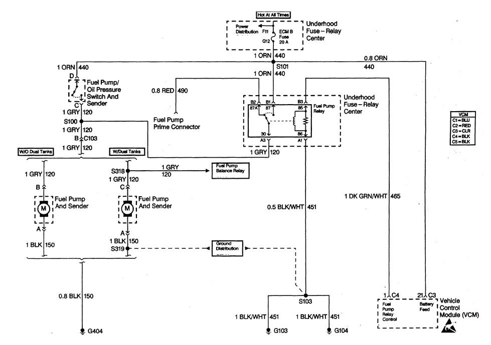

SO I have a 98 5.7 Tahoe LT. I just rebuilt a wiring harness from a 99 Tahoe LT and have made sure to follow the wiring diagrams to the T.
I installed the new/rebuilt harness and started the Tahoe with no problems brought it up to temp, then shut it off. Tried to start it the next day and the battery was dead. Grabbed my jumper pack, hooked it to the battery, and the fuel pump started up, no key in the ignition. Pull the fuse and it stops, put it back in and pull the relay, it stays running.

I grabbed the BBB diagram for reference:
Because the pump continues to run without the relay, I think your focus is on the oil pressure switch as an unintentional source of B+. I think your next move is to disconnect it and see if the pump operates normally (if you haven't already). If it does, something is wrong with the switch wiring OR the switch itself. If it doesn't, your next move is voltage checks at the tank.

I have the mitchell diagrams, which give me similar schematics, only they cover the whole engine. I am going to reconnect the harness, minus the O.P.S. and see what happens. It won't be today, but I will post what I find. Thanks for the insight, I never thought about the plug itself causing a positive voltage flow.
I also don't see the tan wire that goes from the O.P.S. to the instrument panel to show oil pressure as it runs. Is this a 99 schematic?

here is alldata full diagram

Thanks for the other diagram. That is the exact one Mitchell's shows.
So I got the harness back on and hooked the battery up, and guess what, the fuel pump came back on without a key on. So I disconnected the OPS plug and it shut off. Started the Tahoe and low an behold, it started without a miss. The oil pressure gauge is reading slap off the dash, but there was life. I shut it off and crawled underneath to try to hear the whinnying of the fuel pump over the cicada in the tree in my backyard, and no noise or vibration from the fuel tank.
I read somewhere that if the OPS fails, then it produces direct power to the fuel pump. So rock auto is about to get more money from me to test that theory!
Update to follow.
Update to follow.

So I got the new OPS from rock auto only to find out I didn't have a deep enough socket for it. So Oreilly's got me for 12 bucks anyway.
I removed to old sensor, pushed it onto the plug and the fuel pump came on, no key in the ignition, plugged the new one and nothing. so i went ahead and installed it, fired up the beast, and now I have a signal in the dash and a fuel pump that shuts off when the truck is turned off!
So, bad oil pressure sensor in the 98 1500 K body 5.7l will in fact keep the fuel pump running!
