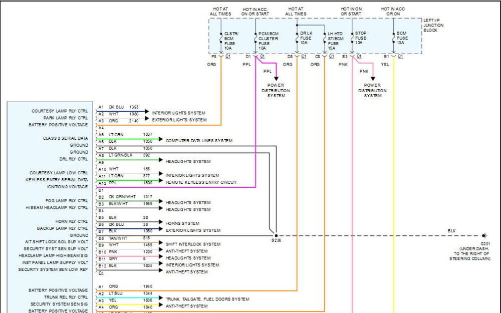

Power door locks don't work keeps blowing fuse.

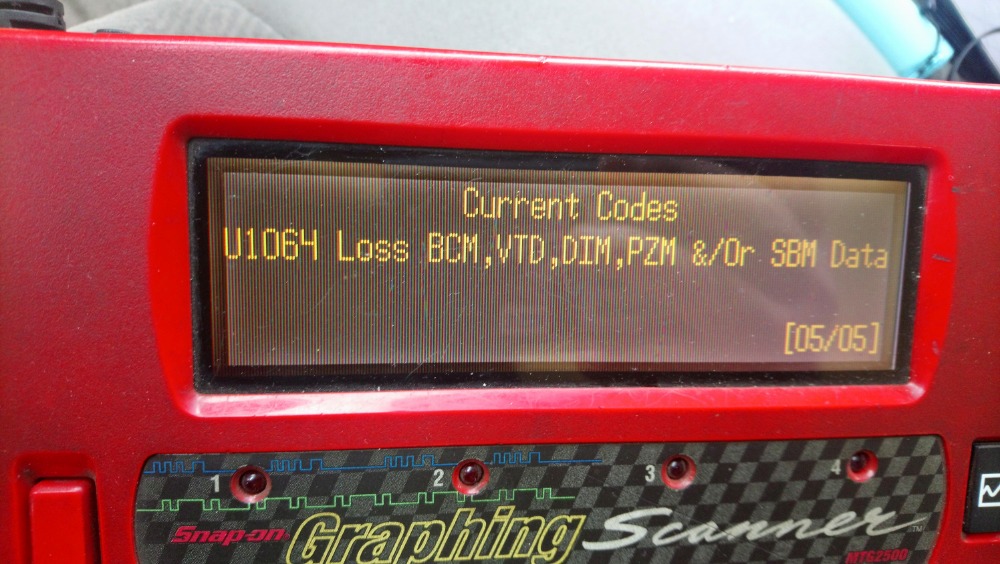

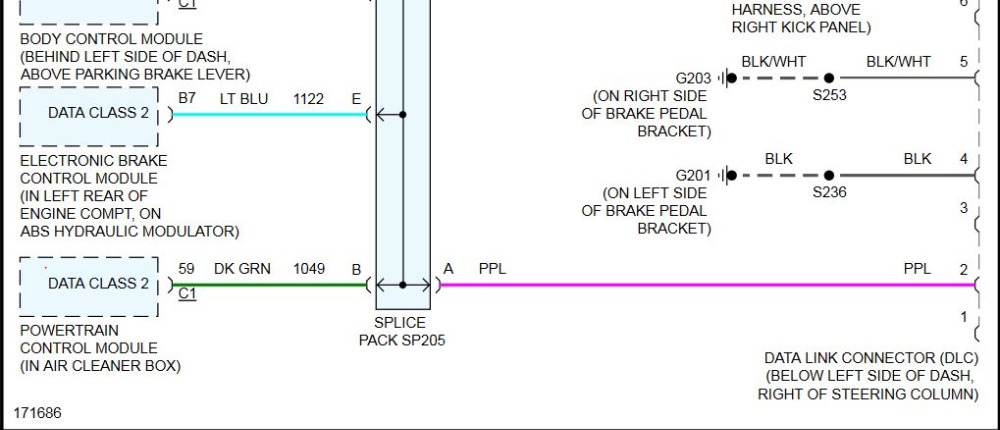

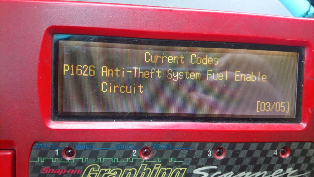

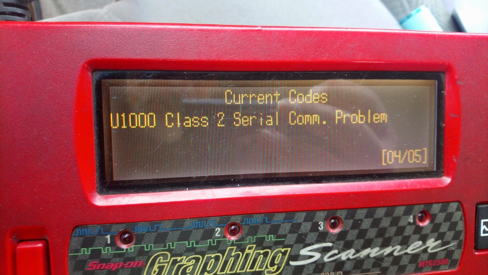

Engine starter will crank if jumping the fuse but won't start no spark.

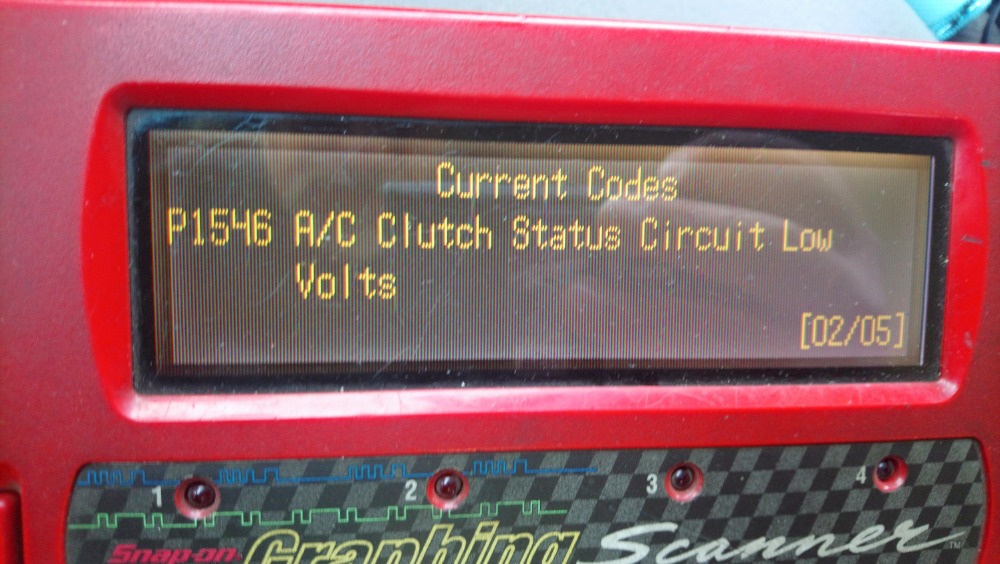

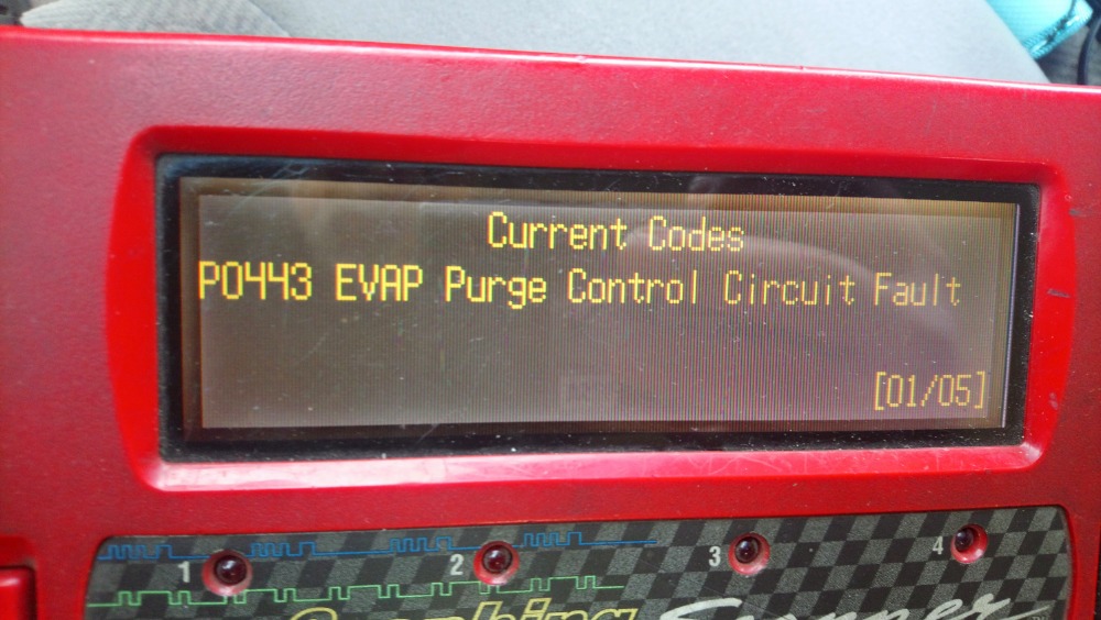

Did a scan please find attached.

is it just one fuse that is blowing? which fuse in particular? Have you did a visual inspection of wires around heat, movement, and points of contact?

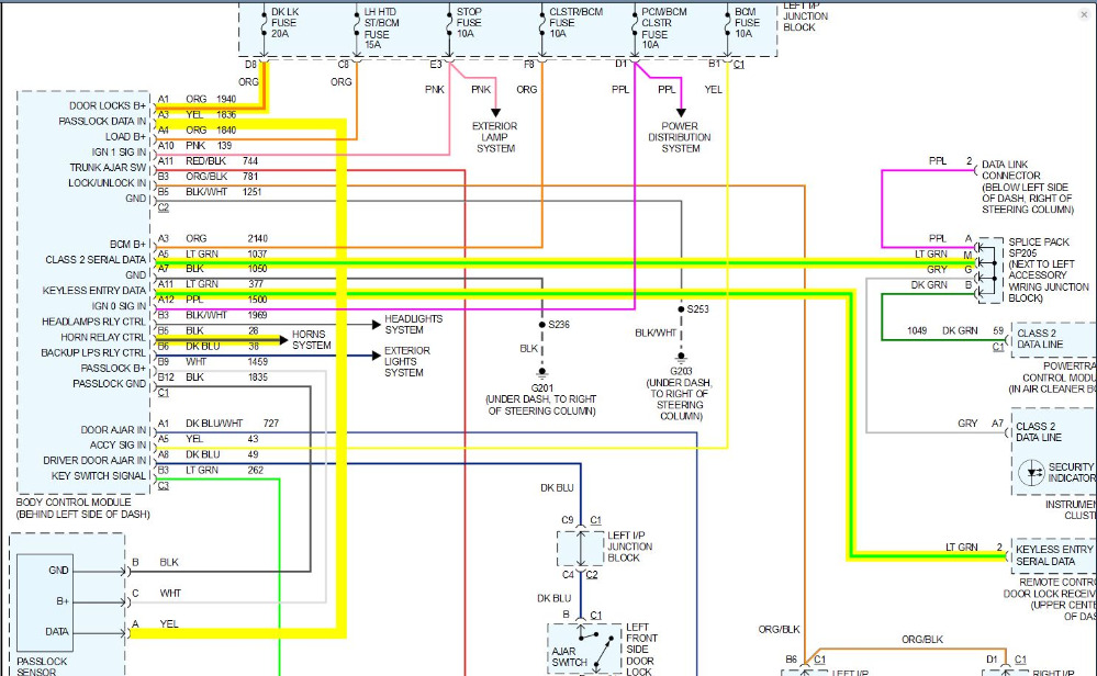

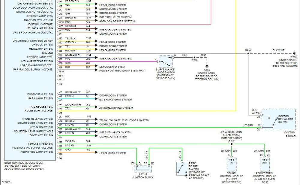

7 years 3 months ago - 7 years 3 months ago #32383 by Chad
Replied by Chad on topic 2003 Impala no start
The BCM seems to be the common factor.
