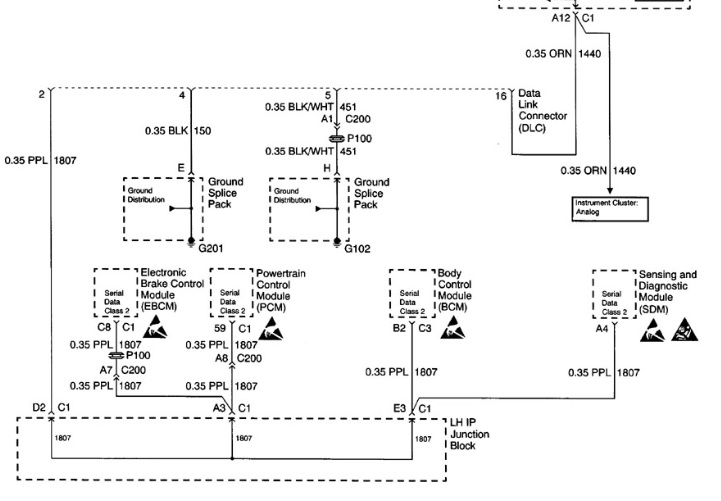

The enhanced scan tool functionality problem is weird, too. No history of PCM swapping? The network your Malibu uses is pretty straightforward, and pretty good at diagnosing comm issues on it's own. If you're not finding U1000 series codes in any modules, then I'm inclined to think the vehicle side of things is OK.

Hmmmm, I'd expect the AE to get good data out of this thing, at least
How about this: Do the VINs on the door and on the windshield agree? Thinking about if the door got swapped, and isn't correct for the vehicle. It's a long shot, I know!
