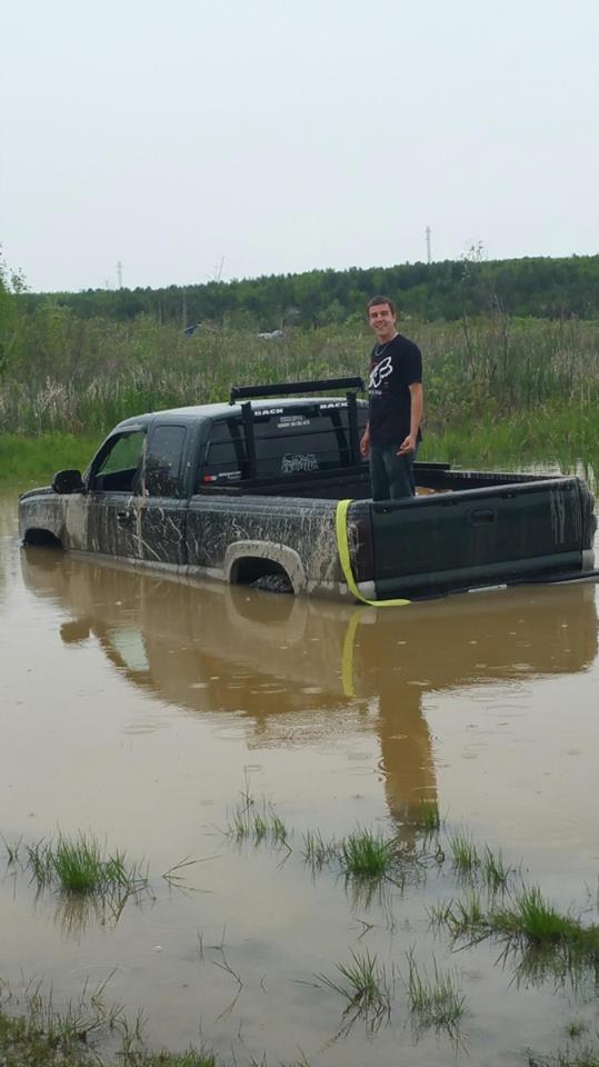

Hey guys I got 03 Chevrolet Silverado that hasa 5.3l in it Vin t.. not flex.. doesnt have egr on it.
last summer i was offroading when i nose dived it into a water hole and got stuck cause it bogged out. had about a foot of water in the cab while it idled (not the greatest) under water for over an hour.
while sunk i was low on gas so i added a jerry can while it was idling under water.. got pulled out backwards and water splashed up under the dash.. while limping it home it slowly lost power and died was also stuck in 4low as i have the auto 4x4 option..
once i got to working on it to get it running again i first pulled plugs and drained oil.. cranked it over with no plugs to make sure cylinders were dry and also sprayed them with seafoam.. i cant recall exactly how it got running again but i know i did new plugs, oil.. pcm? (was a noob and thought it might be fried)..original pcm is back in.. anyways ran like crap untill i unplugged my upstream o2s and it calmed down and got better..
at this point the truck drives as my daily with 140000km on the clock..still has a slight rough idle and was having long cranking issues hot or cold intermittently..
