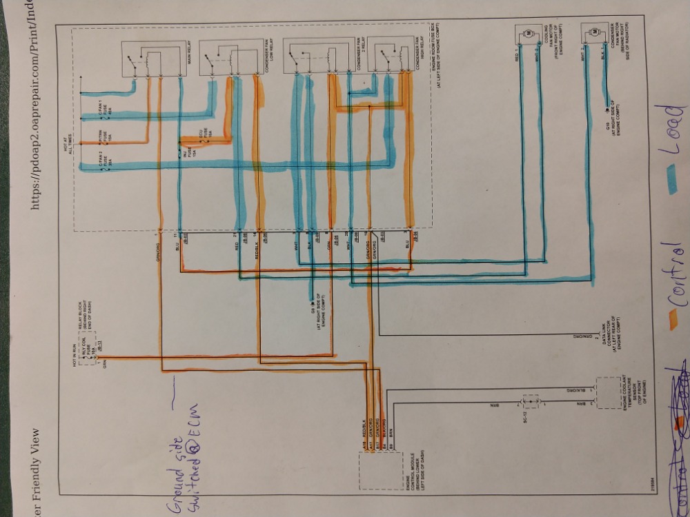

So I have an 06 Kia Sorento.
What I'm trying to figure out is why my condenser fan runs for a little while, then shuts off when the A/c isn't on, but the blower motor is running. I.e. when I have the heat running, the condenser fan kicks on and off.
I'm decent with understanding wiring diagrams on simple circuits, and I watch SD often. Most of what I understand is thanks to SD.
I really just want to know if this is what it was designed to do, or if I should be looking for a fault somewhere.
If you know off the top of your head, an SD video that will help me. Feel free to just link that.

7 years 3 months ago #31866 by PDM
What that diagram doesn’t tell you is if or when the ecu is commanding fan 2 on and off.
It’s normal operation for fan 2 to not run all the time. It should always come on with the a/c on

Do you think the A/C wiring diagram would show the Ecu commanding fan 2? I have access to pro-demand, so I can pull up pretty much all wiring diagrams.
