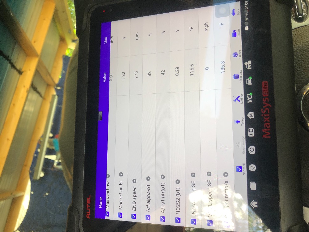

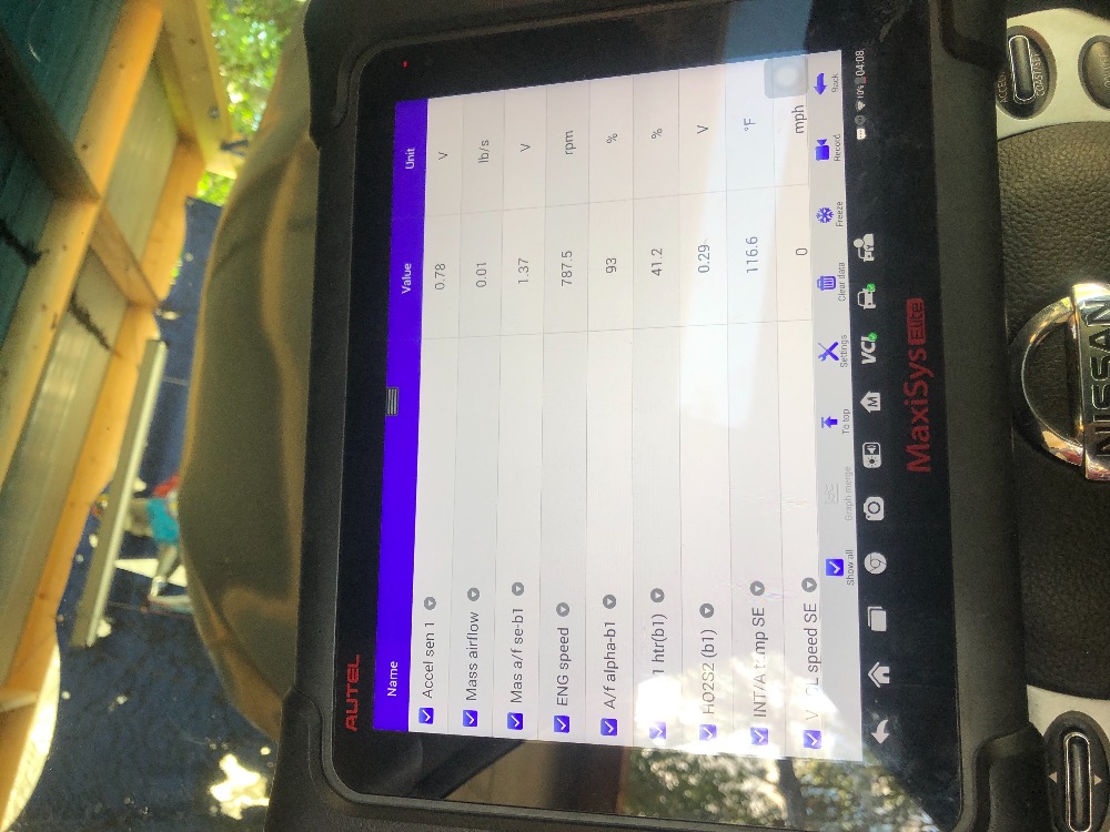

Hello guys. I really need some help on a 2011 nissan altima 2.5 Is jerking crazy like the transmission wants to come off . as soon I press the gas pedal and start moving the transmission start jerking . No grinding noise. And no codes . Transmission fluid its clean. And level.
I check fuse #34 10amps. Under the hood.
Fuse #4 10ams. And fuse #11 10amps. Behind left end of the dash. And they all good what will be the next step i upload some pictures with pids that may help thank you
7 years 3 months ago #31832 by cj1
Replied by cj1 on topic 2011 nissan altima 2.5 jerking no codes
The engine parameters look good enough that they aren't the cause of the jerking when transmission engages.
I'd say the CVT has a problem.

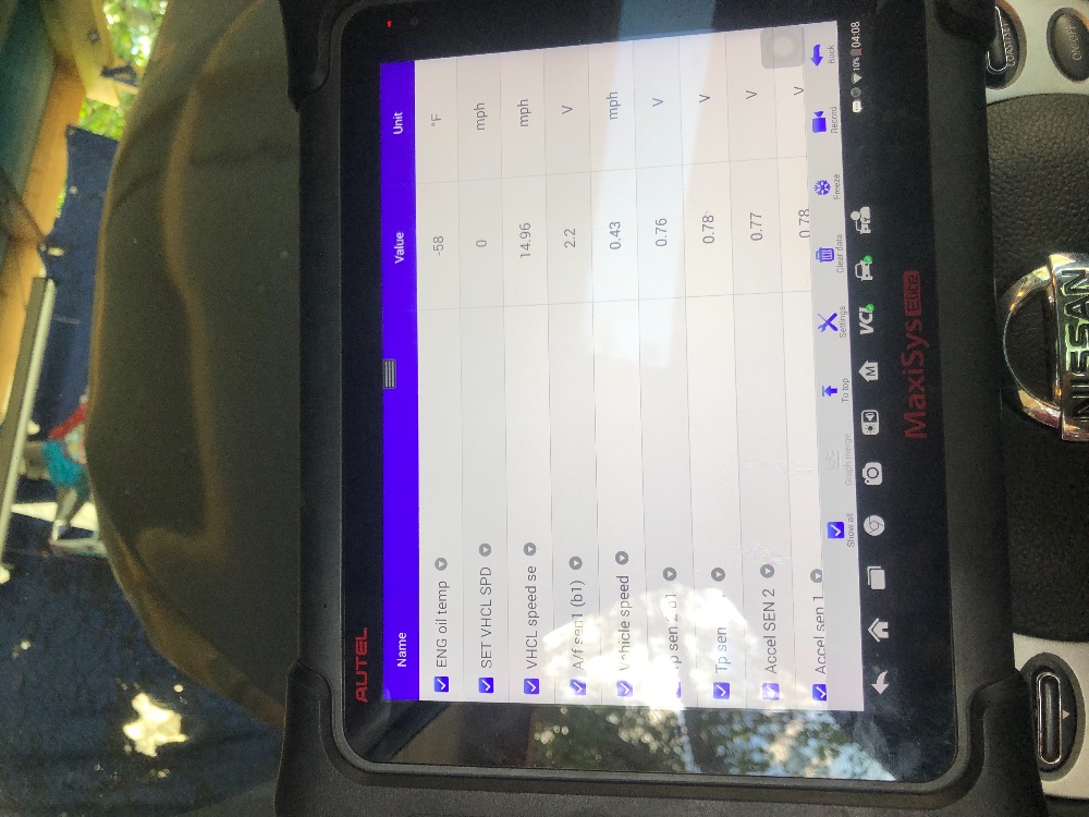

I have a question why do you think engine oil temperature is -58.
There is any way to check the cvt to make sure?
Thank you
7 years 3 months ago #31854 by cj1
Is there an error code/ check engine light on for the engine oil temp?
If not my guess is that the scan tool is showing a reading that doesn't apply to engine without oil temp sensor.
Check with Nissan on the extended warranty for the CVT.
They can at least verify if CVT is a fault.
