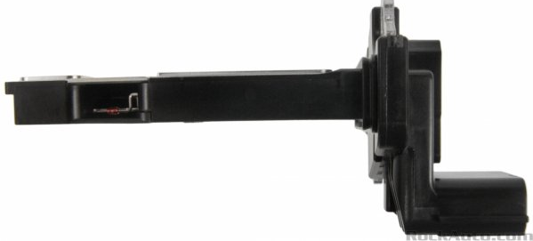

Replied by Tyler on topic Code p0171 p0174
Thanks for getting back to us with the fuel trim numbers. Definitely too high, even at their lowest. :silly:
I think your next easiest step would be a visual on the intake tubing and the MAF sensor itself. I see it's all stock, which is good. You're looking for loose clamps, disconnected PCV hoses and the like. Cracks in the intake tube. Anything that'll allow unmetered air into the engine.
With the MAF, we want to get eyes on the sensor element itself. The opening on the left is what we're after:
Any debris/insects/whatever will screw with the fuel metering and cause lean trims. It doesn't take much.
Let us know what you find.
