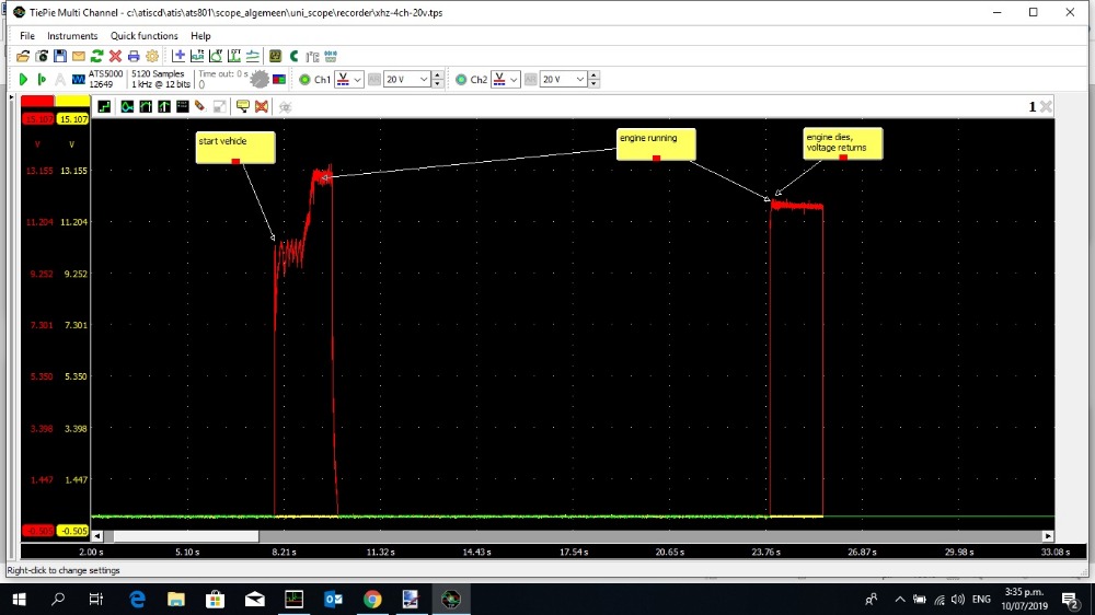

The fuel pump gets power for about 5 seconds as you start cranking, then it drops to nothing until the car dies 15 seconds later.
As soon as it dies it gets another 5 second pulse. If I supply power to the fuel pump permanently it keeps running.

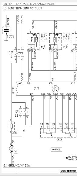

No fault codes have returned during testing but I found one diagram for a Corolla that suggests it relies on the crank sensor pulse to
keep running. UNLESS: the pump is only supposed to provide initial pressure then it relies on suction[? not likely???].
There were no codes for the crank sensor and the vehicle runs fine but in the morning I will scope it because an ecu is
as clever as the person who programmed it.

In live data when it is running the fuel rail pressure stays constant, nothing shorting out. When I scope the power supply to the fuel pump though
I see it get power for a few seconds while cranking, and a few seconds after, then it just loses its power supply and the engine slowly loses pressure
and dies. Just after it dies it gets a few seconds of power to the fuel pump again for some reason.
I've had it idling for 10 minutes now with external power to the fuel pump and rail pressure has been constant the whole time, no indication of
anything shorting out - if I remove the power supply to the fuel pump it will die after about 10 seconds.

There is a second fuel pump relay connected across a ballast resistor to lower voltage while running, but give full
voltage when cranking. The relay goes open circuit once the vehicle starts which lets the pump run on a reduced voltage
after starting, but full voltage to make up for cranking voltage drop when starting.
The ballast was in the front behind the left headlight and hadn't been plugged back in properly.
Now that it's hooked up properly again the problem is solved.
