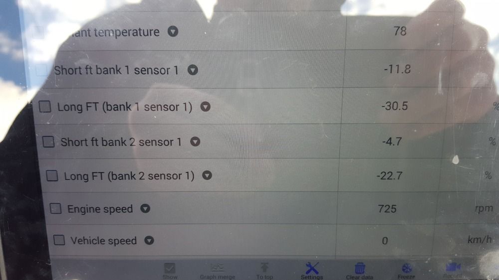

There are 3 receipts on the passenger seat for oxygen sensors being replaced by another shop - not sure what code they were getting.
Fuel trims are pretty extreme, fault code P0172 for "bank 1 too rich".
MAF sensor is quite low at 2.8 g/s considering the size of the engine. The one spark plug I pulled out looked good.
Fuel pressure is 4000kpa at idle, 9000kpa at 2000 rpm - not sure what it should be?

- Desmond6004
6 years 11 months ago #31134
by Desmond6004
Replied by Desmond6004 on topic Re:Toyota 4GR-FSE code P0172 "bank one rich"
Thanks - would that make it rich on both banks? Bank 2 fuel trims are also pretty high.

- Desmond6004
6 years 11 months ago #31154
by Desmond6004
Replied by Desmond6004 on topic Toyota 4GR-FSE code P0172 "bank one rich"
Thanks for the info - I imagine we need to first check whether the correct O2 sensors have been fitted then perhaps check for back pressure in the exhaust - unless there is a way to diagnose a clogged CAT in live data?guafa wrote: Hi Desmond,

6 years 11 months ago #31204
Replied by Tyler on topic Toyota 4GR-FSE code P0172 "bank one rich"
Do the downstream sensors agree with the upstream sensors? As in, if the trims are crazy rich, then the downstream sensors should show fully rich, too.
There's a Toyota bidirectional test that'll let you take control of the fuel trims directly for diagnostic purposes. Snappy labels it 'A/F Lean/Rich', not sure what Autel calls it. :silly: The test will shift the fuel trims negative and positive by a calibrated amount so you can make sure all sensors respond rationally.
We don't get that engine in the States, so I'm not familiar with the fuel system on this one.
If you pull the dipstick, does it smell like gas. Possible fuel getting into the crankcase.
Despite your 2.8 g/s reading, I'd still be tempted to give the MAF a cleaning anyway.
