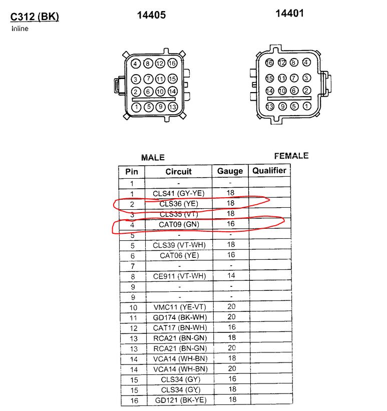

Rodents ate through (2) wires in my truck, an 07 Ranger 2.3 XL. I repaired them. They were in Connector 312 (C312) according to AllData, wires 2 and 4. How do I figure out what device(s) were using these wires? In the site, I can find the wiring diagrams when I know the function, but how do I go backwards?

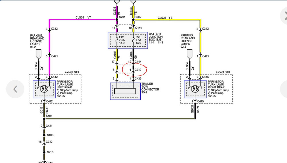

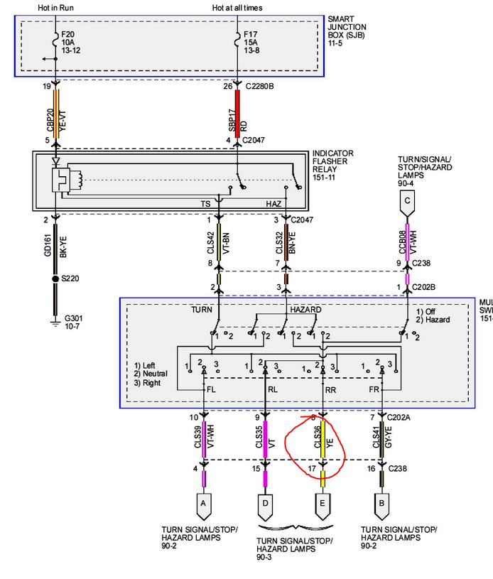

I don't have ALLDATA but I'd imagine you'd search for the circuit name CLS36 (YEL) and CAT09 (GREEN). I just flipped through several bitmap inline connector views as these images weren't searchable and found they go to the trailer tow connector and right rear park/stop/turn lamp connector.
i.imgur.com/UogjUQt.jpg
Sorry Chad but I've been glaring and searching for over an hour lol

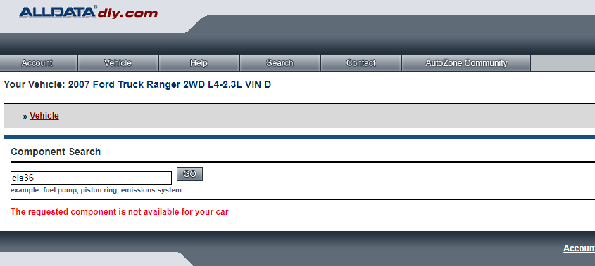

Unfortunately, the search in AllData doesn't yield any information on those circuit ids. Perhaps it was a mistake to go with AD, what service do you recommend/use?

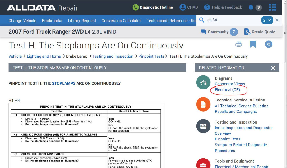

How did you navigate to those images, based on the wires/circuits?
Last edit: 6 years 10 months ago by javentre.
6 years 10 months ago #30938 by Chad
Replied by Chad on topic Wire + Connector to Function Mapping
My first search was for C312. This brought up the connector view and Pin-out chart.
The pin-out chart told me what circuits are on Pins 2 & 4.
Then I searched for CLS36. In the "Related Information" section, I clicked "Electrical (OE),
which brought up the diagram.
Searching for CAT09 was fruitless, but since the other wire was dealing with external lighting, I started browsing the light diagrams, until I found it.

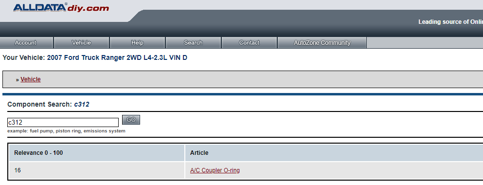

Chad - Interesting. Thank You. This seems to be a difference between AllData and AllDataDIY. The search in DIY does not return valuable information with those keywords.
The design/layout/UI of your screenshot looks more modern than mine.
