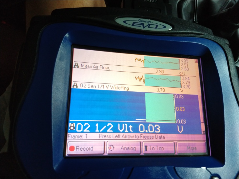

I am on my way. Sometimes a good night's sleep can cure a bad case of the dumbass. One of the buttons was wonky, it's getting better with use, and reading the manual didn't hurt. Just don't tell my wife about the manual thing...
I'm going to take a drive to capture some data and sit down and do a LOT more reading. But getting this tool going is a big step for me. I've gotten some pretty good use out of the $10 OBDII bluetooth adapter with an Android phone but this should be a big step up.

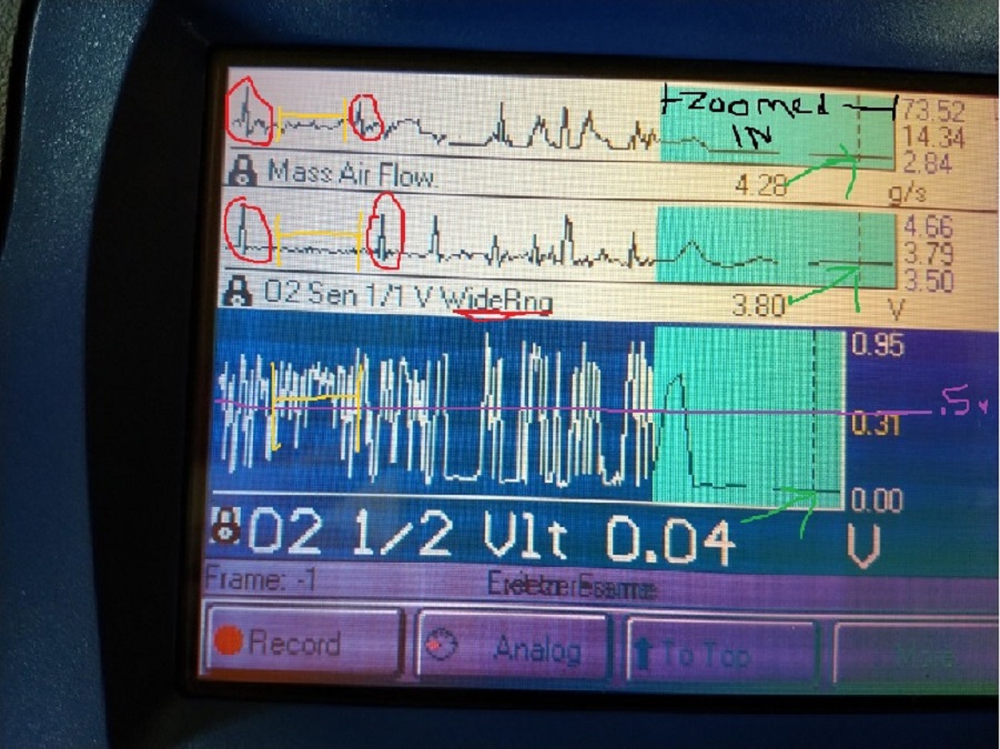

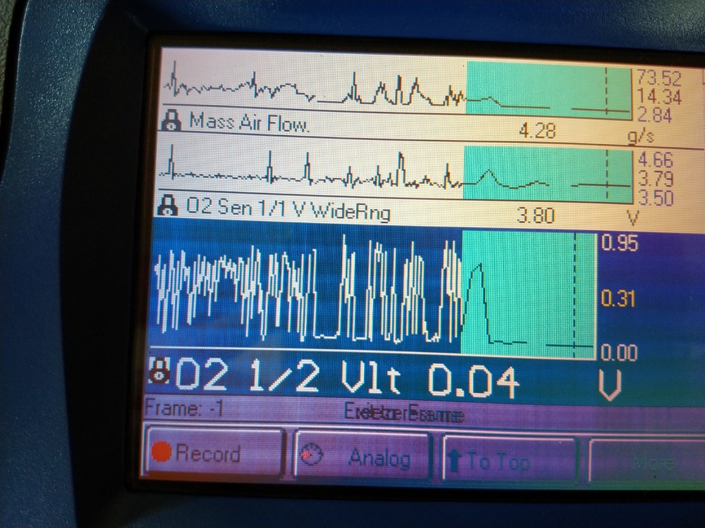

This is still my favorite forum, by far, but I've found a Subaru specific forum where this issue has been discussed in great detail. Still, I figure it isn't polite to just disappear without an update.
I'm getting better with my scanner. It's been discontinued and there's no help from the manufacturer but it's paid for and I think I can get a lot of use out of it. Still, I'm pretty jealous of the hardware some of you have.
The photo I posted above was while the car was sitting in the driveway. I took it for a drive and got quite a different result. The downstream O2 is anything but flat. Unless I'm totally not understanding Paul's videos, the CAT (the bloody car has 3 of them) is not working. The CAT on the pipe coming down from the turbo is one of the few original parts. It probably had a good dose of oil, coolant, and metal shavings when the prior owner grenaded the engine.
(I hope the photo shows. I never seem to get it on the first try.)

What is the time base on that screen shot? Is that going rich and lean with throttle input?

Let me see what I can find. Right now I'm struggling with translating the terms Subaru/OTC/Torque Pro use and how to translate back and forth. It's confusing.
That photo is my OTC Genisys, looking at the defaults it brought up for my car. There are many more parameters in the menu that can be selected but most of them just say 'no data'. And the amount of time it takes to configure is substantial. I take it that this is because there are a LOT of different cars with many different configurations. I will get better at this.
That probably represented a steady 30 mph in 3rd gear since I was almost home. But I had a 30 minute drive at a steady 65 mph in 5th gear and the waveform was just as ragged.
I want to correct something I said earlier. The manufacturer (I think that it's just Bosch who bought the product line) couldn't give me support but one of the techs did point me to a youtube channel where I'm learning about the scanner. So it's not like they just gave me a 'Good luck, Gomer' and sent me on my way.
I also want to put the scanner on my 2012 Impreza and take a drive. I'd like to see a flat wave on that rear O2 sensor to help convince me I'm not doing something stupid.

Sorry, I didn't mean for that to sound so technical. Just wondering if we're looking at a few seconds or few minutes on the screen

The spikes in red indicate a throttle snap of some kind, and are consistent between the MAF and the AFR wideband sensor.
The yellow is a relatively stable sample of steady light throttle, based on the MAF and AFR sensor. This same yellow sample in the post-cat sensor is "no bueno"... the purple line is roughly your .5v territory, and there shouldn't be all those cross counts there. A P0420 sets because of because of too many downstream cross counts, which you have. Based on the limited data here, I say you either have an exhaust leak or a junk Cat.
Also, since you are new to the Genisys, (you may have already figured this out) think of the light blue box as a magnifying glass. Dotted trace is displayed in the bottom. Numbers on the right are Min, Max, and Avg.
These things were hot stuff when they came out back in the day. Man, 10-15 years ago it seems like every shop had one. It was a great tool for its time for sure, and still a great one to learn on if you are newer to using scanners. I still run across some old techs that use them occasionally.
Unfortunately I think they haven't made their updates since 2013, maybe even before that.

Thanks, that's what I thought, but wanted to make sure I was seeing what I thought I was seeing.
Somehow, my brain completely omitted the MAF signal. Maybe because my Autel display looks the same but only shows 2 graphs at a time.
Very cool. Thanks for taking the time to write all of that.
Cross counts means deviations above and below .5 volts?
