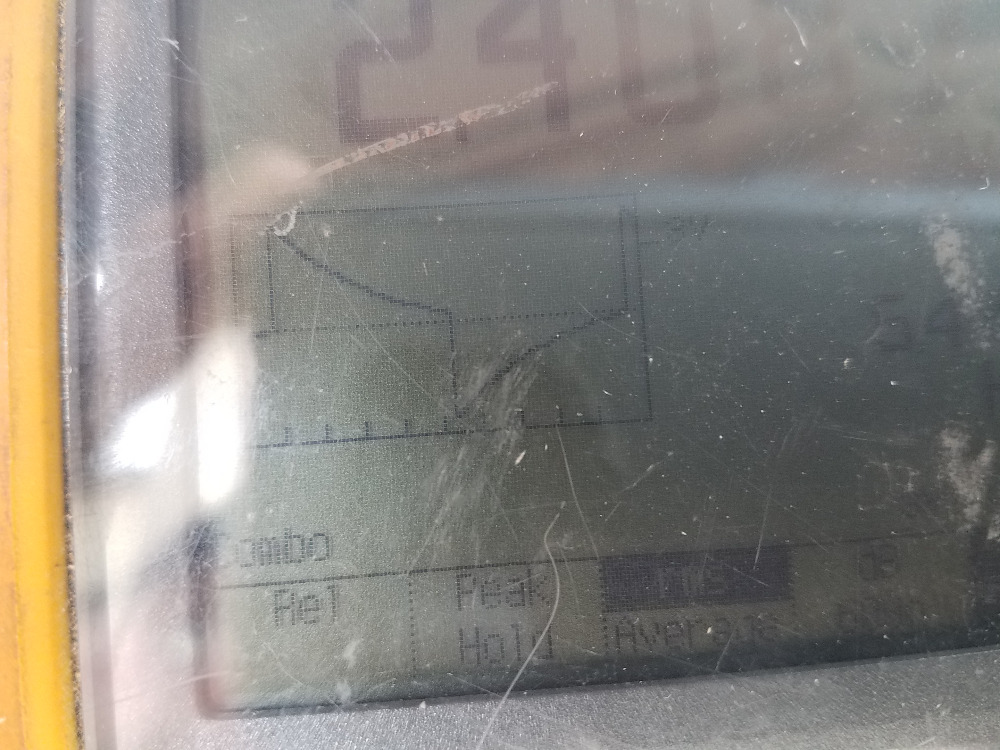

I have a 1996 Dodge Ram 2500 V10. The original problem was no spark on cylinders 1 and 6. Replaced the coil pack, problem remained. Dodge no longer supports the PCM, so I got a rebuilt PCM from Flagship 1. They took my VIN and programmed the PCM before shipping it to me. I was assured it would be plug and play. After installing the new PCM, the spark problem was fixed. However, the stalling problem surfaced. The first indication I have is that the VIN is not stored in the new PCM. Second, the Automatic Shut Down relay keeps tripping and shutting down the engine. Third, I am getting P0320 error code from the extended Dodge library in my code reader. While it was only running on 8 out of 10 cylinders, it never had the stalling problem until the PCM was changed.
I have bypassed the ASD relay to keep it running, and have measured the voltage from connector A of the PCM. According to my Dodge service manual;
1 - GY/BK is the crank sensor
2 - BK/LB is sensor ground
3 - TN/YL is the cam sensor
4 - VT/WT is 5 volts
Using a Fluke single trace 867 graphing voltmeter, I am not seeing exactly what I think I should be seeing.
The 5 volt line reads battery voltage, not 5 volts.
The crank sensor is showing what I expect to see, a 5 volt and ground referenced square wave pulsed signal.
The cam sensor is showing a bi-polar 5 volt triangle wave. 2.5 volts above and below signal ground reference.
I am not sure of the signal ground should read battery ground, as this ground reference is coming from the PCM.
My initial thought is that the new PCM is not completely compatible with the one I removed. However, I am not sure how I am getting the triangle wave from the cam sensor, or why I am seeing battery voltage on what should be a 5 volt line according to the Dodge service manual.
Where does the PCM ground? I know a funky ground can cause problems.
If I wind up needing a crank sensor, Dodge also has stopped supporting this part. Not a lot of luck in the aftermarket, either. If you have a work around or alternate supplier, would be nice to know about.
Thanks in advance for any suggestions or guidance.

I have some additional information after doing some additional thinking and diagnosis.
First, the cam signal is not exactly a triangle wave, the transition time from 5 volts down is just not clean.
Second, the signal is bipolar 5. The wave is biased at zero volts, but there is a very definite negative 5 volt wave after the positive wave.
Third, with the engine off and I rotate the crankshaft, the cam signal transitions from 5 volts to zero and back to 5 volts. Without the engine running, I do not get the negative 5 volt wave cycle. See attached. This is the cam signal, running at idle.
Thanks in advance for any suggestions!
Geoff
6 years 10 months ago #30742 by John Curtis
Replied by John Curtis on topic 1996 Dodge Ram 2500 stalls V10
Looks like a magnetic sensor and not a Hall effect. Don’t take my word for that though.
Can you extend your time base and check if there is noise in the signal?

6 years 10 months ago - 6 years 10 months ago #30743 by cfiigep
Replied by cfiigep on topic 1996 Dodge Ram 2500 stalls V10
It's a 3 wire sensor, and I'm pretty sure it's a hall effect switch. The other nuance is that when it acts up, I lose the tach signal. Tach drops to 0 and stays there until it runs properly again. If the tach signal is being driven from the cam sensor, this is another arrow pointing at the cam sensor. Yeah, the error code is crank sensor, but that can be false.
Yeah, it's a hall effect switch. When I manually turn the crank with the key on, it toggles from 5 volts to .1 volt. High and low. It never drops to minus 5 like it does when it's running. Not sure why.
Geoff
I just borrowed the Fluke meter, and am not that familiar with it. I've tried to expand the time base, but the only option I could see was to manually change the amplitude, but not the time base. I'll screw with it some more and see if I can change the time base.
Geoff

Ok, see if this makes sense.
I tossed the old computer. The supplier didn't want it as a core, and I thought the problem was fixed initially. So the old computer is gone, and I can't A/B compare it.
The can and crank signals both go into the A port of the PCM. They both get supply voltage and ground from this connector. While both the Dodge manual and Paul say this is supposed to be 5 volts, and I am seeing battery voltage on this wire, the crank sensor is providing me a correct square wave regardless. Since the cam and crank sensors are functionally identical hall effect switches, the cam sensor should also be providing me a pull-down signal from 5 volts to ground. Which it does, when I pull the crank through by hand. But it won't track the high and low machined surface of the cam wheel dynamically.
Ok. Let's say Dodge decided to do something different on the V10, and used a different signal convention for the cam sensor. Plus and minus 5 volts, instead of 5 and 0. Which explains the 12 volts on the supply wire. But that's not what the Dodge manual says, and NONE of Paul's videos ever mentions this. Plus, from a design standpoint this makes no sense. But for argument, let's say it is. The damn signal still should be a square wave, with sharp transitions from one logic state to another. Not the F'ed up waveform I am seeing on the cam sense line.
Without the scope, I would not have seen this. Reading the DC voltages on the cam sensor slowly says it should work fine. But that sensor will not track the cam wheel in real time.
I'll have the new cam sensor in a few days, and let you know what I find. I still need to resolve the 12 volts versus 5 volts on the supply wire, but I have more than one problem here, I think.
We still use magnetos on piston aircraft engines for a reason, guys. Yeah, all this computer controlled stuff is very cool, but ya know, it's hard to screw up a set of points, a coil and a rotating magnet.
Thoughts?

6 years 10 months ago #31144 by cfiigep
Update on the stalling issue.
With the ASD relay jumpered, the truck ran fine with just a slight hiccup from time to time during normal driving.
I purchased a set of better spiking clip leads, and found that the distorted wave form on the cam sensor was a result of a poor connection I had tried by spiking the wire with a pin. With the proper leads, the square wave looked fine. Both the cam and crank sensor signals were fine.
The intermittency was difficult to find, because everything looked fine. But the extended set of trouble codes kept showing crank sensor.
I finally got the engine to stall and stay stalled for a moment. It would crank, but not start. The cam signal remained fine, but the crank signal went flat line. In about 3 seconds of cranking, the crank signal returned and the engine restarted.
Ok, this points a finger at the crank sensor. However, back to my original discrepancy. The engine was only running on 8 cylinders, not 10. I had no spark on the numbers 1 and 6 cylinders. I replaced the PCM, and spark returned to those cylinders. But I never had the stalling issue until I replaced the PCM. Since you cannot buy a new PCM, I got one from an overhauler, Flagship One in New York.
I have found a source for a new old stock crank sensor, not too expensive, and have ordered it. By replacing the sensor, it will eliminate that as a possibility. Because while this appears to be a sensor issue, I cannot get it to hard fail long enough to see if I am losing the signal voltage out of the PCM.
I do not have the old PCM, I trashed it after I thought the bad spark issue was fixed. The stalling issue developed a few days later.
Side note. The truck stalled while driving, and would not restart. My thought was the fuel pump, and I replaced that. The truck started and ran on 8 cylinders. However, the pump may have been fine all along, and after cooling down, the engine restarted with the new fuel pump. This may have been a crank sensor all along. I never checked the codes before I replaced the pump, because I was certain it was the pump. Perhaps not.
If anyone has any thoughts or other suggestions, please share.
