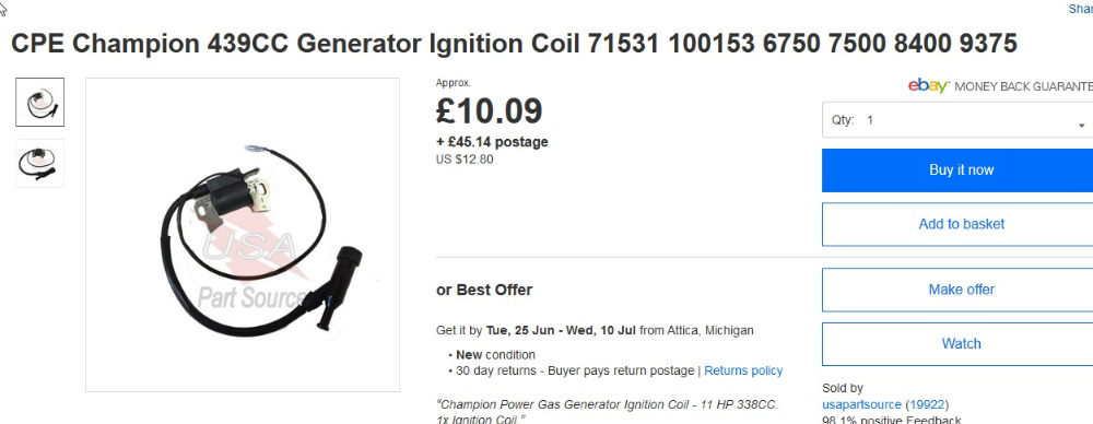

6 years 11 months ago - 6 years 11 months ago #30667
Replied by Andy.MacFadyen on topic Generator repair.
Looks like a flywheel magneto to me similar to Briggs and Stratton lawnmower engine.
The flywheel of the engine has magnets in it that generate the electricity in the coil primary and also the ignition timing.
The on-off control basically is basically a switch that grounds the the primary windings control side l thus killing the spark.
If there is no spark it is more than possible the coil has kicked the bucket.
Simple enough job to change -- videos on Youtube same procedure as Briggs & Stratton use a thin strip of cardboard to set the gap between the horns of the coil and the flywheel.
