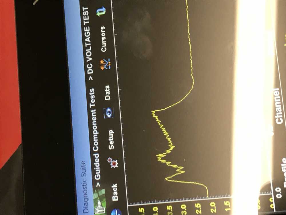

New to forum. Been lurking for a while. 20 year tech. Trying to up my game with scope usage. I have a verus but by no means is it my "go to" tool. Trying to use it more and more so please understand that other then watching many of Pauls videos- I'm still a rookie! So here is what I have:
1999 Mazda Miata-
212K on the clock-
Recent engine build by another shop- (seems strong- 21" of vacuum at idle)
Has an aftermarket intake (with a reman maf) along with a header and high flow catalyst (that doesn't appear to be working well)
Car runs great. You would never know there was an issue except for the mil and P0172. At idle b1s1 voltage is pinned at exactly .9v. As soon as I bring the idle up a hair it starts switching. Give it a vacuum leak and O2 voltage drops down to .2v. Rear O2 when finally warmed up is sitting right at .8v so I'm fairly sure that I have a true rich condition.
What I have checked:
Fuel pressure is 62psi-
Verified cam timing-
There are no vacuum leaks-
Made a block off gasket for egr just to rule that out.
Throttle position is zero at idle
STFT: -18
LTFT: -20
Coolant temp: 181f
I checked the reman maf with the scope. At idle its right at 2.2v. Verus says it should be around 1.8v. Is that enough to cause an issue? Not sure if its the aftermarket intake causing this? I also attached a cell phone pic ( because the greenhorn couldn't figure out how to snap shot it while learning on the job) of my throttle snap and it does not really look like what's in Paul's book. Any thoughts? Thanks for takin' a look.

what does the maf read grams/sec at idle?
9 years 10 months ago #4047 by Tyler
Replied by Tyler on topic 99' Mazda Miata P0172- fixed rich 02
Hey sir, thanks for posting!
The MAF sensor reading does sound high at idle, but this one probably won't run well without the MAF connected, huh? The waveform itself doesn't look bad, I like the initial peak and the flow ramp.
Is there a fuel pressure regulator to check on this engine? Thinking of fuel leaking into the vacuum hose, dumping raw fuel into the intake. Can't recall if this setup is return less or not...

Its a return less system. Mazda specs out 65psi at idle. I will get the maf g/s reading tomorrow. One observation I have which I doubt plays a role is the B1S1 has been moved towards the rear about 3 feet from its OE location as a result of the aftermarket header. I see a lot of these cars with way more mods with no issues. Most are asleep for winter at this point. Also did a wot pull and O2 voltage was a steady .8v. I have pinched off the purge valve hoses... Injectors appear to be stock Mazda parts. Thanks for the input everybody

You've changed how that engine breaths with that aftermarket intake and exhaust. The question is, how much? It could also be the MAF.
It could be worse with a factory MAF.
O2 is fine, good job so far brother.
