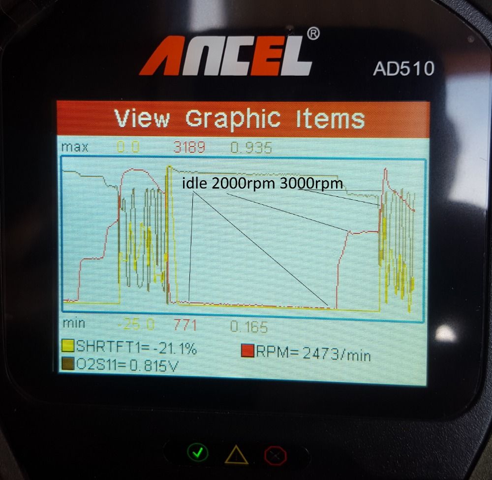

Customer complaint is that vehicle is low on power 'and might need a new throttle body".
Fault codes 16684 "random misfire", 16685 "cyl 1 misfire", 16686 "cly 2 misfire", 16688 "cyl 4 misfire"
17536 "bank 1 lean", 16515 "O2 sensor bank 1 low". 16656 "Fuel trim ban 1 rich", 16500 "coolant temp sensor low".
Coolant temp looks good in live data, all codes cleared. Fuel trim at idle is -15% and -17% at 3000 rpm.
Oxygen sensor stays on 0.9v at idle, 0.8 at 2000 rpm, and only starts switching at 3000 rpm.
I will pull the spark plugs out next to see if perhaps there is evidence of a leaking injector.

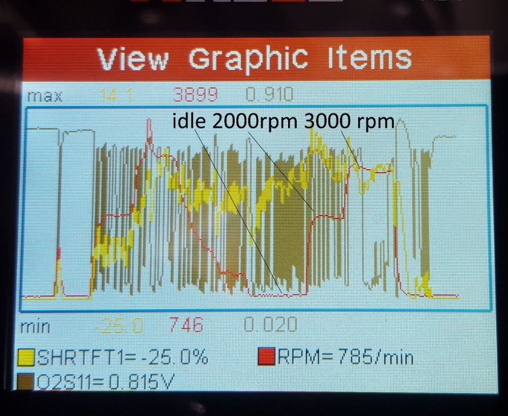

7 years 4 months ago #30462 by Desmond6004
Replied by Desmond6004 on topic 2000 VW Beetle fuel trims/ multiple misfire.
The MAF sensor looked clean but I gave it a spray anyway, idle air flow has gone from 7.5 to 4.8 g/s.
Fuel trims at higher revs have dropped back and the O2 sensor is now switching at lower revs.
STFT is still -25% at idle though but possibly because the engine is still fouled up. I'll order a new sensor anywa
to be safe.

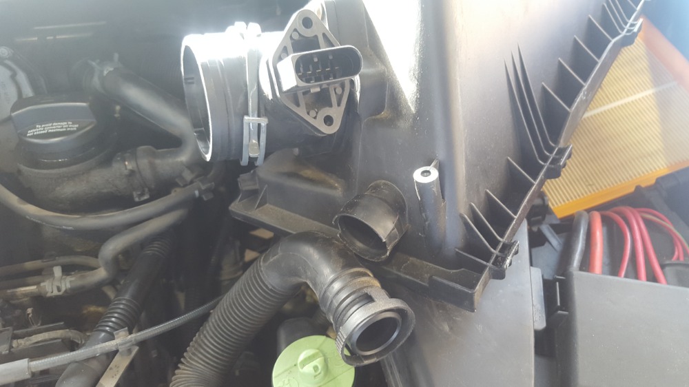

7 years 4 months ago #30468 by Desmond6004
Thanks for the help - always good to have someone to steer my suspicions in the right direction :)
The 'root cause' of the problem appears to be the air hose that had fallen out of the intake which
resulted in unfiltered air going through the system.
A new MAF sensor has been fitted and now idling is at 3.5 g/s and short term fuel trims are doing battle with the long term fuel trims which
I imagine will eventually level out.

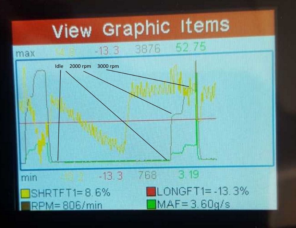

7 years 4 months ago - 7 years 4 months ago #30471 by guafa
ok, now 3.5 g/s with the new sensor, which makes me think the engine is a near 3 liter, isn“t it?
what are those new trim numbers?
Last edit: 7 years 4 months ago by guafa.
  • Paul6004
  • Paul6004's Avatar Topic Author
7 years 4 months ago #30472 by Paul6004
Replied by Paul6004 on topic 2000 VW Beetle fuel trims/ multiple misfire.
It's a 2l VW.
Minimum STFT was -10 on that display, sitting at 8.6 at the far right when idling.
After changing it I had two misfire codes return which may have been there from just before changing the sensor. I cleared them and took it for another drive and they never returned.
I'm just wondering why it would register too high when it's dirty?
I'm also wondering if the CAT will take a while to clean up - if it does.
7 years 4 months ago - 7 years 4 months ago #30473 by guafa
3.5 g/s seems to me a little bit high (should be something like 2.6 g/s @ 700 rpm). Maybe because you have 805 rpm. ok, this is just my reference point from other engines/sizes.
Anyway, it does not matter if STFT and LTFT sum is near 0% (in this case -13.3% + 8.6% = 4.7%). good enough
7 years 4 months ago #30474 by Desmond6004
Yeah I'm happy with it. I'm just wondering whether the CAT will be ok after running rich for so long.
7 years 4 months ago #30500 by Tyler
Desmond6004 wrote: The 'root cause' of the problem appears to be the air hose that had fallen out of the intake which
Is that the hose you're referring to in the foreground? Not to doubt your fix, but that's the SAI feed hose to the pump. An issue there shouldn't have an impact on fuel control. :huh:
Anyway, nicely done on the fix. B) Why does the MAF read higher when it's dirty? Because that should cause a lean issue, right? I've seen it go both ways. :silly: I don't know MAF internals well enough to explain it.
7 years 4 months ago #30503 by Desmond6004
Tyler wrote: Is that the hose you're referring to in the foreground? Not to doubt your fix, but that's the SAI feed hose to the pump. An issue there shouldn't have an impact on fuel control. :huh:.
With that hose out unfiltered air can get sucked in through the MAF sensor.

7 years 4 months ago #30536 by Tyler
Desmond6004 wrote: With that hose out unfiltered air can get sucked in through the MAF sensor.
Oh right, my mistake! :blush: I gotcha now.
