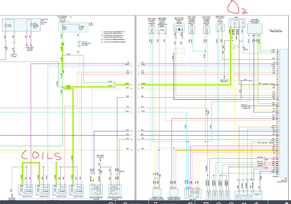

6 years 11 months ago - 6 years 11 months ago #30300 by Chad
Replied by Chad on topic Correct call?
The O2 heater shares a power with the coils. I think the voltage drops you are seeing are the coils charging.

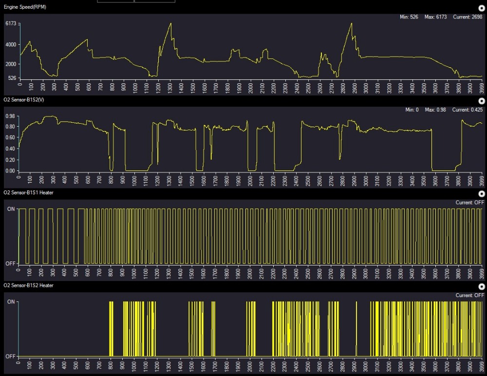

6 years 11 months ago #30319 by Tyler
Replied by Tyler on topic Correct call?
Little late to the party. :blush: I agree with Andy that you're seeing ignition feedback into the heater circuit. NBD. As far as the heater PID not toggling, and the heater not getting grounded, that may be down to the PCM's strategy. Nissan and Mazda are selective about when and how they run the downstream heater.
Has anyone searched for TSB's on this code yet? I recall going down this path on a similar Mazda, and found a TSB that recommended cleaning the throttle body. :silly: Apparently, the carbon in the throttle body would 'hold on' to fuel, which would then get sucked into the engine during fuel cut decel. The PCM's looking for the downstream O2 to peg lean during fuel cut, so it'd get upset when the downstream O2 would suddenly go rich.

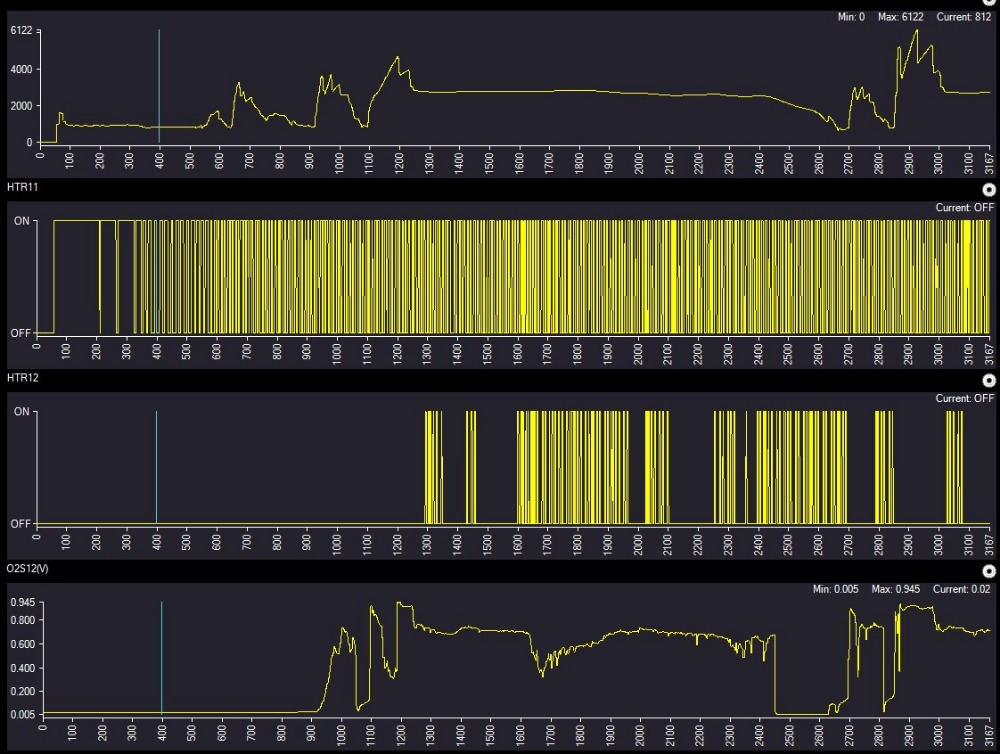

6 years 11 months ago #30320 by Tyler
Dug up a couple examples from other Mazda's of similar years to yours. Both show the 'when I feel like it' downstream heater strategy. :silly: The first one wouldn't run the downstream heater at all at idle.
