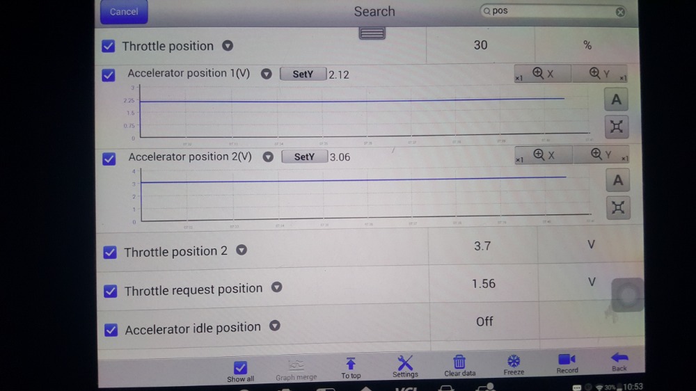

Good day
Luxes gs430 2004
At wot throttel postion it show only 30%
I do open it by me slef it go to 86%
Is we have acculater pedel postion problem or it is motor of tps
Problem with requst or output
Input or out put
Plz find attatch
Luxes gs430 2004
Input or out put
Plz find attatch

Hi Sr/Mrs.
Do you have any dtc code?
There is a posibility you have a "power reduction" mode or throttle body is simply out of calibration.

Was this capture taken KOEO or at idle? Because lots of electronic throttle systems will limit throttle blade opening under those conditions as part of it's normal operating strategy. You may only get a wide open throttle when driving down the road.
Like guafa asked, any trouble codes? It's become my personal rule over the years that if I don't see any ETC or related codes, then it's very likely the throttle is doing exactly what it's told to be doing.

Fix
App sensor was lose
App sensor was lose
