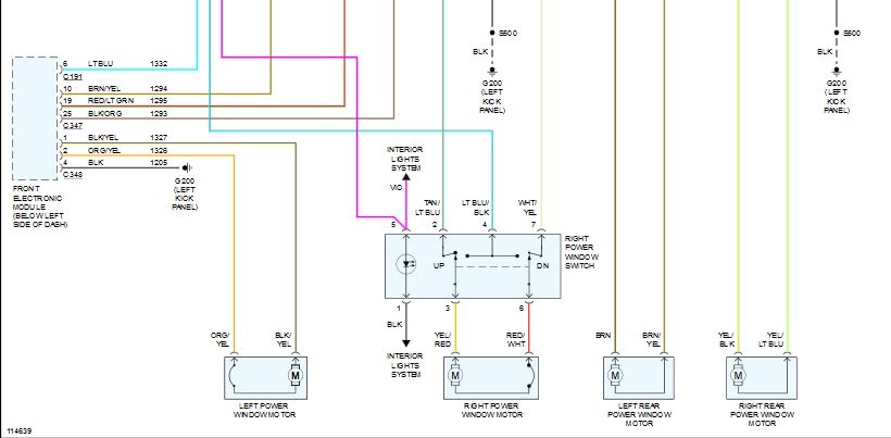

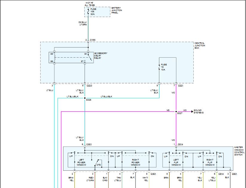

7 years 5 months ago #29671 by Phopkins6344
last week I posted a question about replacing a failed window switch on my ford windstar. you folks helpfully pointed me to the correct part. I installed it yesterday and now, neither the driver or passenger windows will roll up. when using the switch, I heard (using new switch) an electric buzz from the driver side of the vehicle. The second time I tried it, my cd player/am/fm radio shut down. HELP

Is the battery charge good? Low system voltage can have all kinds of strange effects.

the two grounds in left kick panel check those
