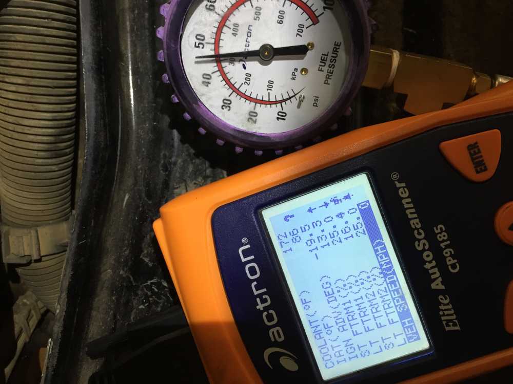

So its not a mass air flow issue for sure...i replaced it with a known good one from a friend....her is a picture of fuel trims and fuel pressure at idle...

Hernandez530 wrote: So its not a mass air flow issue for sure...i replaced it with a known good one from a friend....her is a picture of fuel trims and fuel pressure at idle...
That fuel pressure is too low brother...
You're not going to get anywhere with this one until you get to the bottom of the fuel delivery issue.
