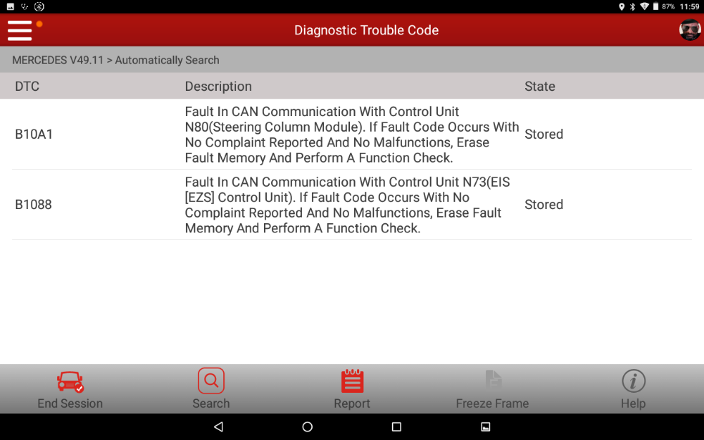

Main Problem
Won’t crank
Odd symptoms
*Fan runs when ignition on
* wiper not working but Fuse is ok and have power
Electric Fault
Fuse box under the Hood
*Fuse 52 (Start enable) has no power
*Starting relay won’t energize (no ground power in pin)
* Fuse 58 (transmission electronic? has no power.
Scan tool fault
SRS
Transmission
  • Loney911

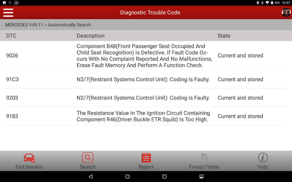

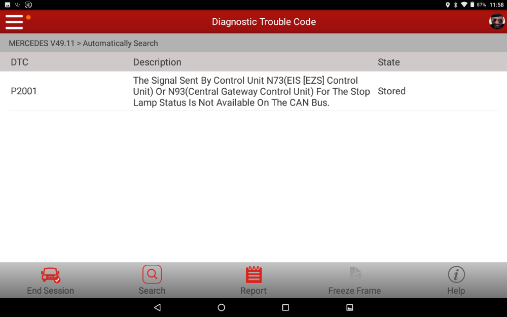

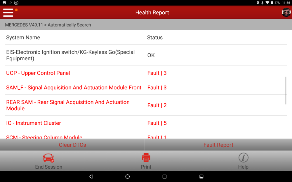

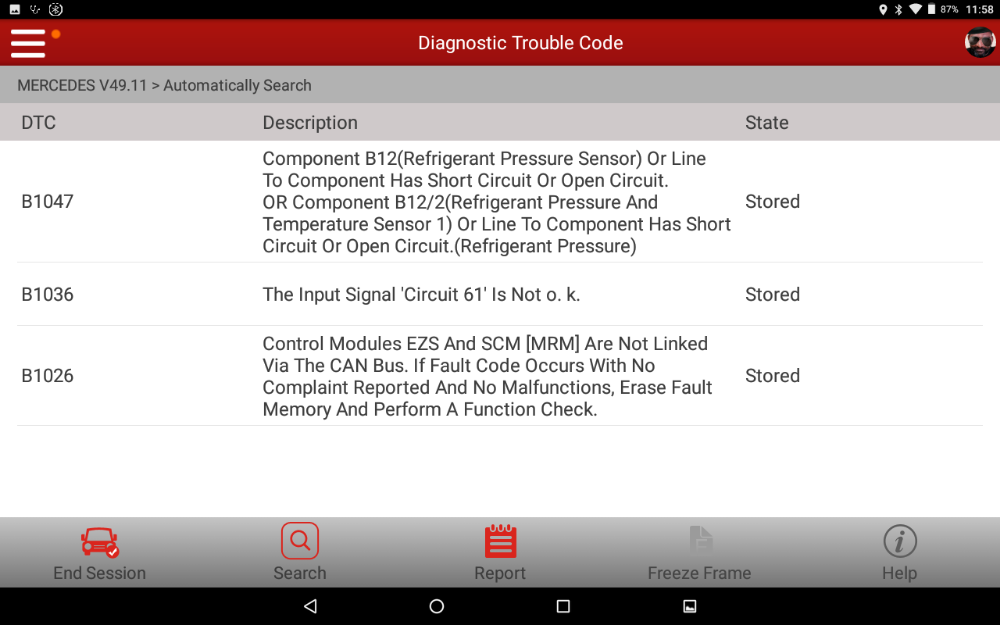

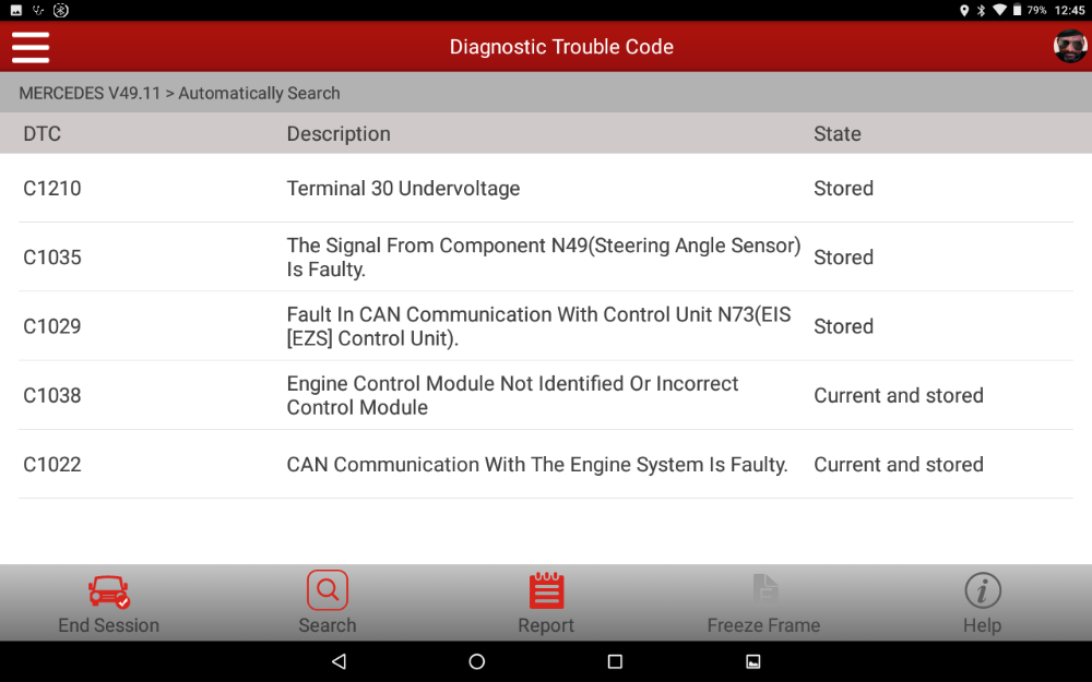

This is fault found from scanning tools
Initial scanning faults are shown in red color when complete scanning I was check fault detail and it says stored or current and store when clear DTCs all fault is completed
But second scan samething is happen
Reality is won't clear DTCs

That's alot of codes. I think you should check for excessive voltage drop at the computer power feed as evident from "Terminal 30 Undervoltage" and your odd symptom of fan running at key on. I think terminal 30 means pin 30 connector 5 at your engine computer. Check your inbox.

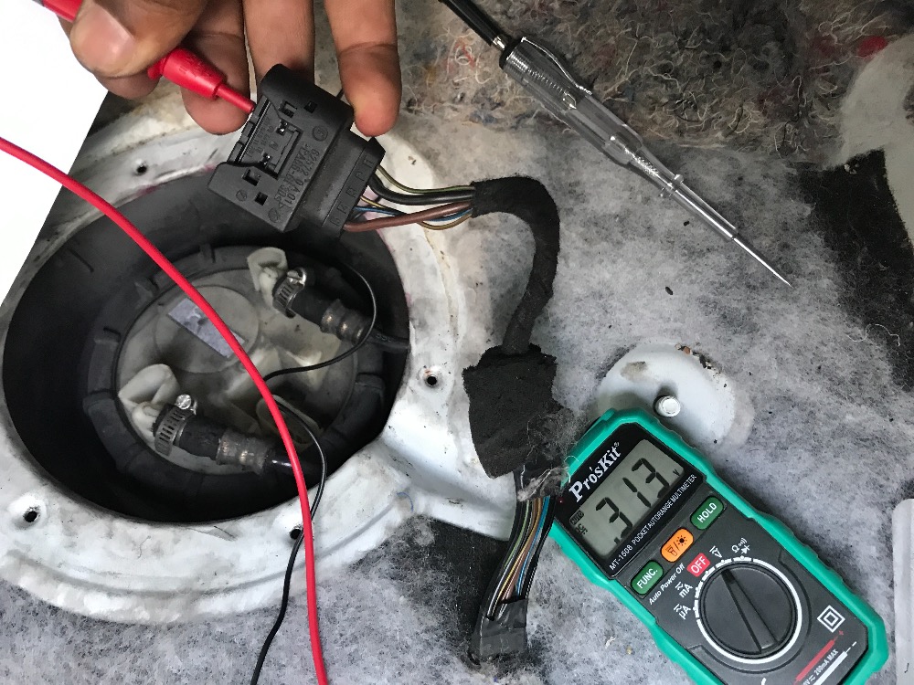

Fuel Pressure Sensor won’t get reference voltage 5
Pls check inbox
